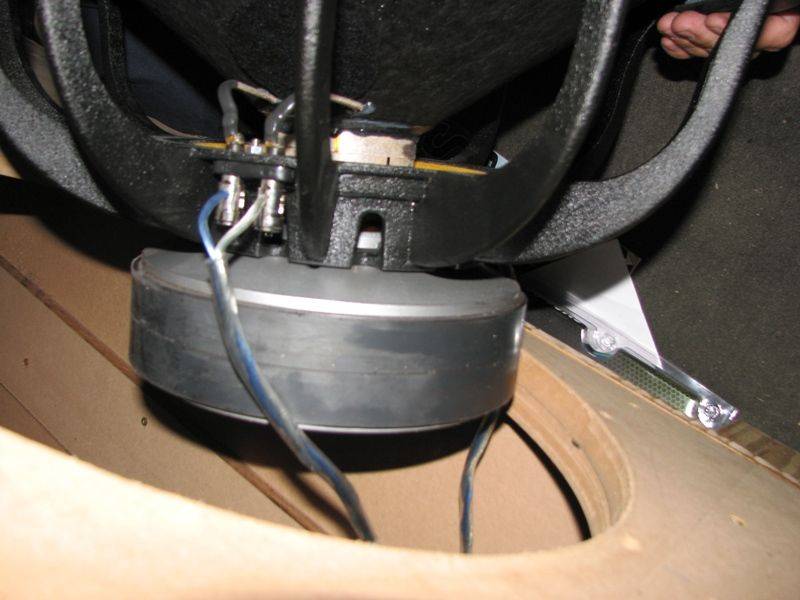

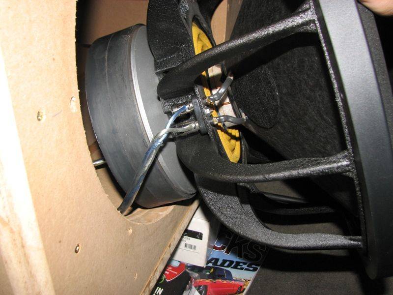

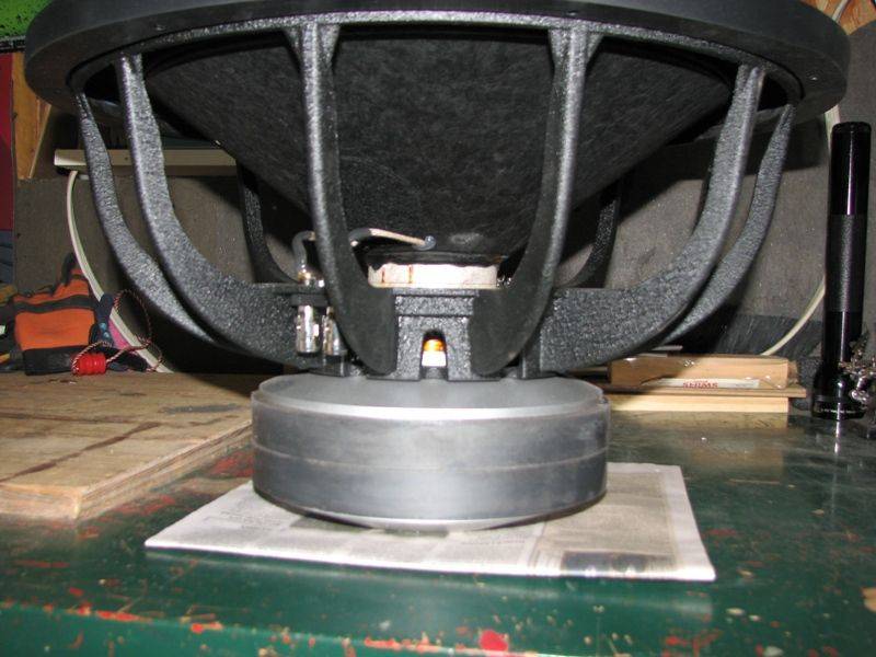

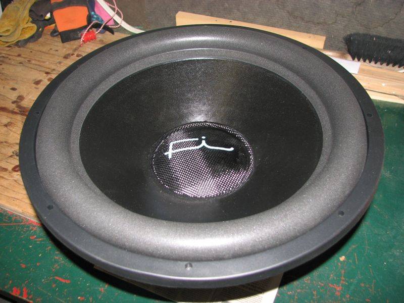

Finally received the replacement sub. I had communication with Fi several times. They still contend it is my fault and that I did something with wiring. They were very cooperative and ended up sending the repaired sub at no cost, even covered shipping and upgraded to a carbon fiber dust cap (may have been a stocking issue).

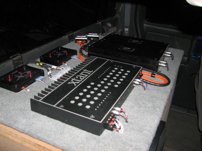

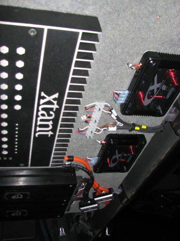

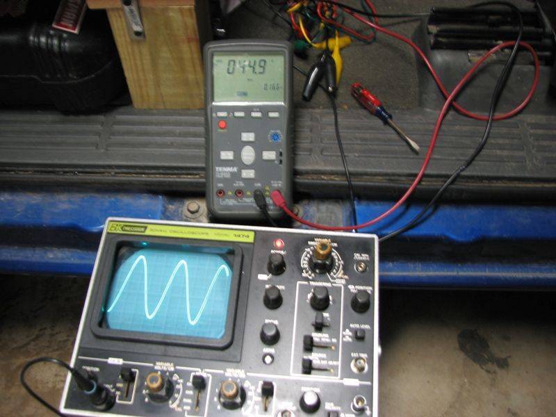

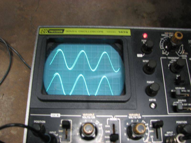

Replacement is in, and again we adjusted gains. Now that the warranty is no longer valid (I was told this was a one-time thing) we have the sub hooked to both amps. And, of course, I took photos of my scope and DMM
measurement of both amp outputs playing a 25Hz sine wave
this demonstrates that both amps are in-phase electrically.
setting gains with 0dB tone
coil 1:
coil 2:
installed and operational:
this sub was MUCH stiffer than the previous one. That was very evident. Also, four of the basket mounting holes had to be drilled out because the glue had hardened and was blocking the mounting holes.

Awesome that it worked out, glad to hear Fi came through. My SSD's came with Carbon Fiber cones as well... I know they were out of copper coils for a while and they offered an upgrade to aluminum for free so they could get the subs to me faster but I wanted copper... guess they tossed the upgrade cones in to make up for the wait //content.invisioncic.com/y282845/emoticons/smile.gif.1ebc41e1811405b213edfc4622c41e27.gif

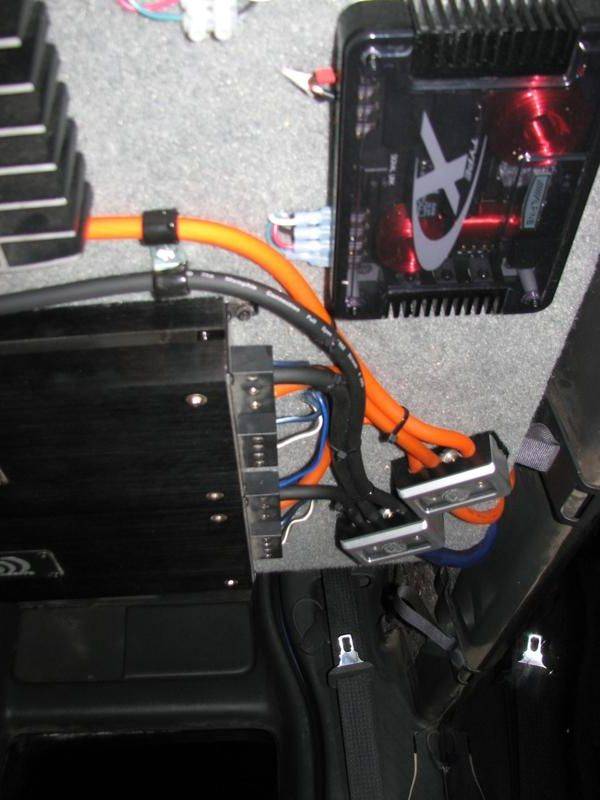

here is an interesting observation: playing the sub today the owner said he opened the doors and it was louder and seemed to play "easier". plenty of output but he is able to hit the "wall" in which you struggle to pressurize the cabin. not louder just because of reduced cancellation but louder because the sub doesn't have to work as hard - like a large sealed box vs. a large vented box.
we are wondering if pressurizing the cabin is what resisted cone movement and caused over heating despite operating the sub in a fashion that would be fine without the additional cabin pressure. who else has noticed this?
so for now, he is just going to take it easy and enjoy music through the Type-X comps and xtant amp.
I still thing the sub lacks a sufficient heat sink and cooling for the price/market. the 12" Alphasonic Mayhem never had an issue in the same setup and had the same amount of output.
Normally you will be louder/have less backpressure on the sub with a window down or door open. Turns the box into a pseudo 6th order.
If you're on the ragged edge then door open can lead to overexcursion/bottoming out. Lot of flat walls have that issue when playing low stuff...
I would just tell him to be conscious of the music/freqs he's playing as higher stuff will heat the coil pretty quick if pushing a lot of power. And use the "smell-o-meter"
