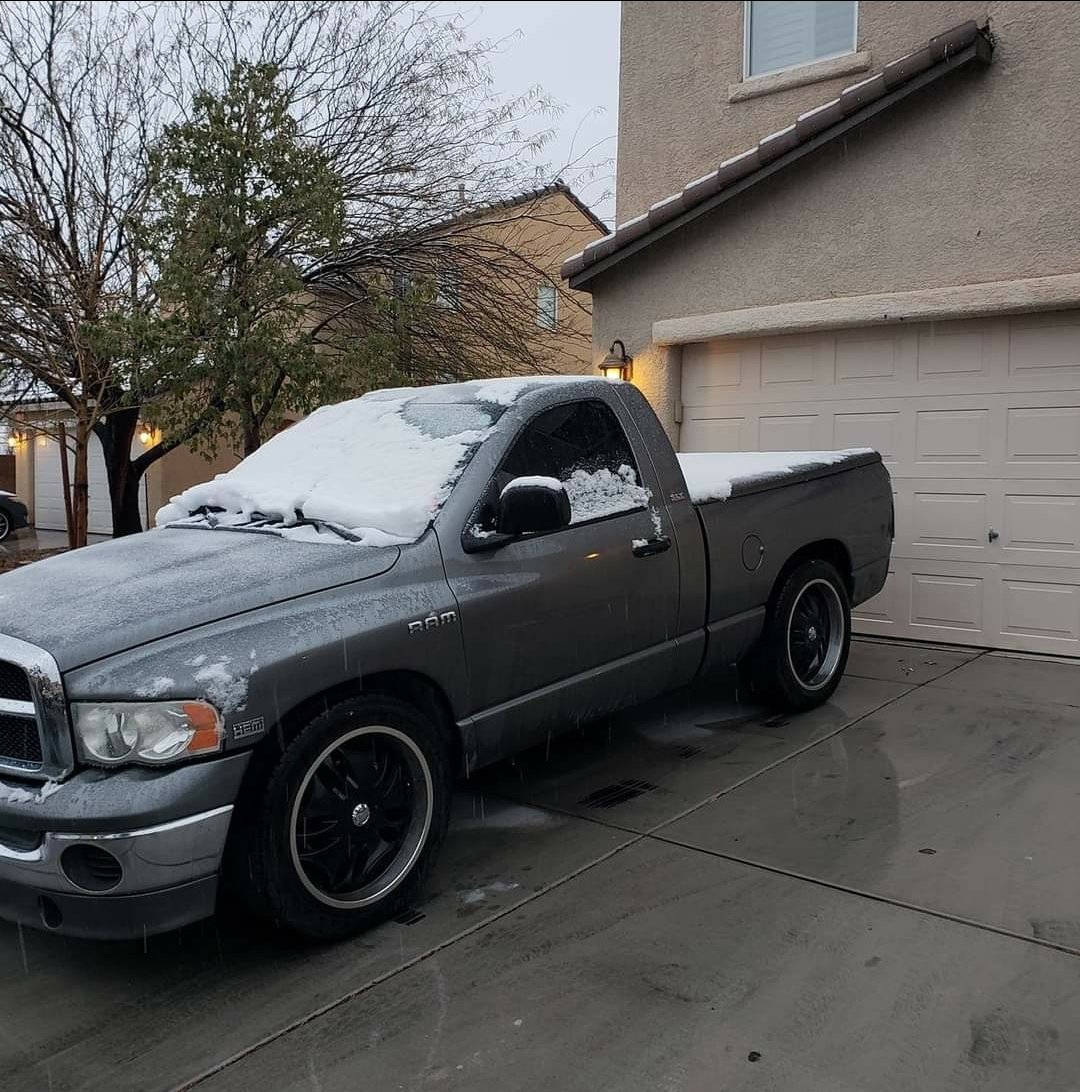

Point them out please. I hope there commas that I forgot. I quit using them on here because you youngsters who text all the time get confused whenever you see one. A 40 year old is a kid to me. You can say whatever you want about my builds. They all bang, have good equipment, metered well, good electrical, and won when I competed. And they aren't clapped out rides like everybody else's rides. Hitting 148.9 @ 31 hz. in an uncut standard cab isn't easy. If you call that mediocrity then so be it. Keep trying kid!
