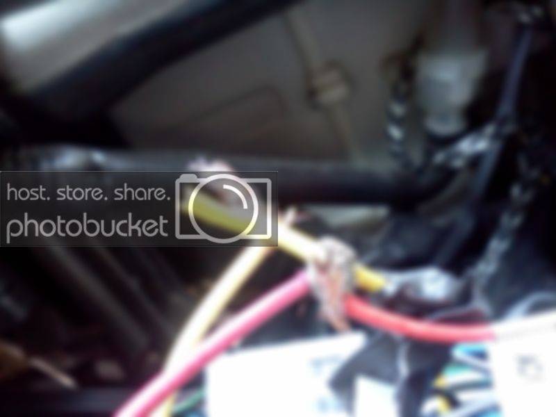

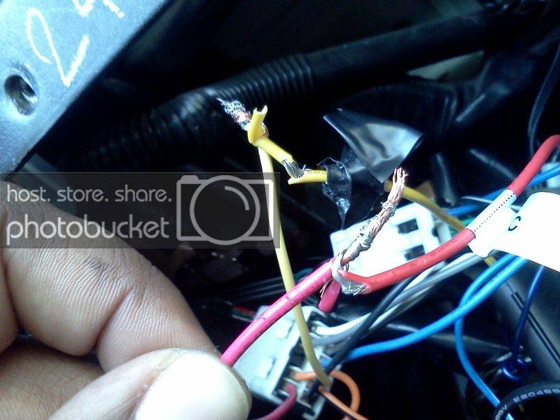

i have a Farenheit DVD 7 inch flip out and i can't figure out how to get the player to remember the settings. Everytime i turn the car on it returns to factory settings( please help)
Product Identifiers
Brand Farenheit
Model TID-897NRB
UPC 23755010995
MPN TID897NRB
more detailed
1.red-red 2. yellow-yellow
dvd player power button lights up then quickly goes out..........
3. red-red +yellow+yellow all together system powers on functions
4. when i turn the key off and on again -last setting is not saved goes back to factory settings
i have tried everything about 8 hours and i am stompped thanks for any help............
It is considered improper but I have never had any real issues with grabbing power at the fuse box...but there is usually a simple fix for the no constant power, more than likely it is just a blown fuse in the engine bay fuse holder. Just make sure the yellow is hooked up to a constant power source, the red to a switched power source with the key and black is grounded
