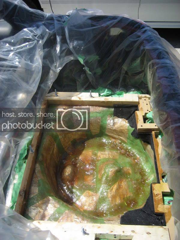

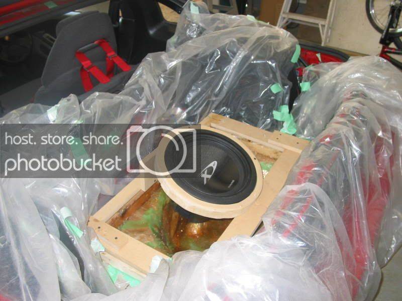

the frame is now glassed into the bottom.the build should go pretty fast from here on in.

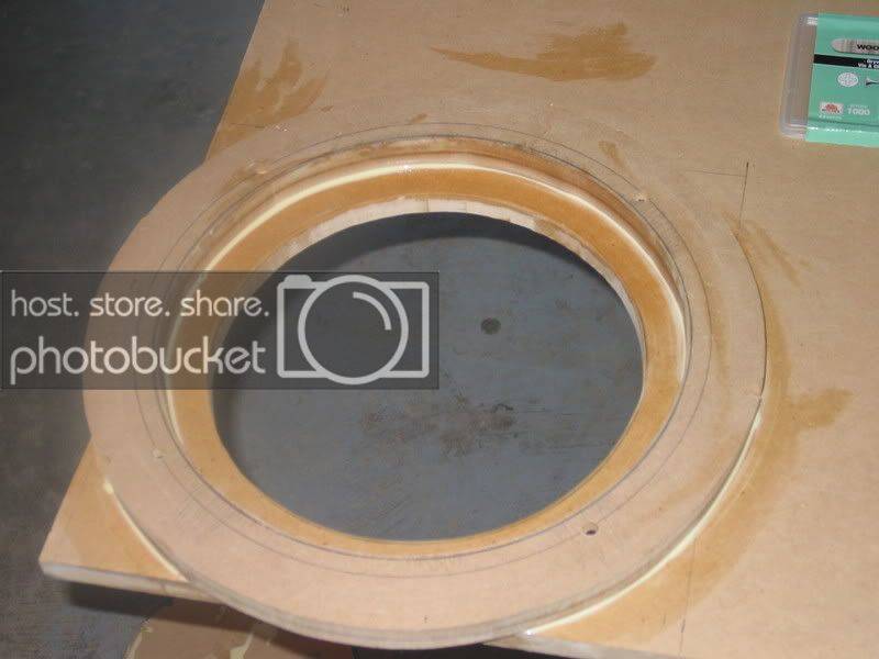

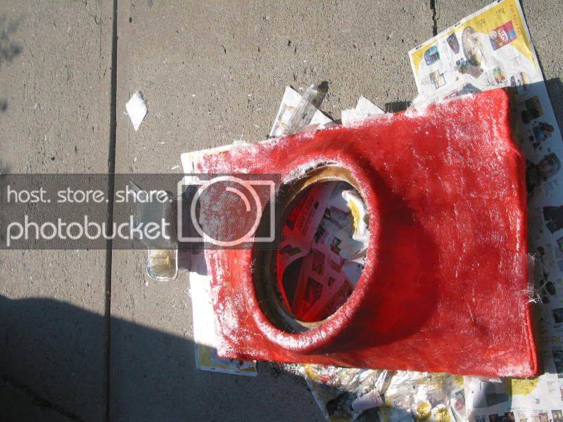

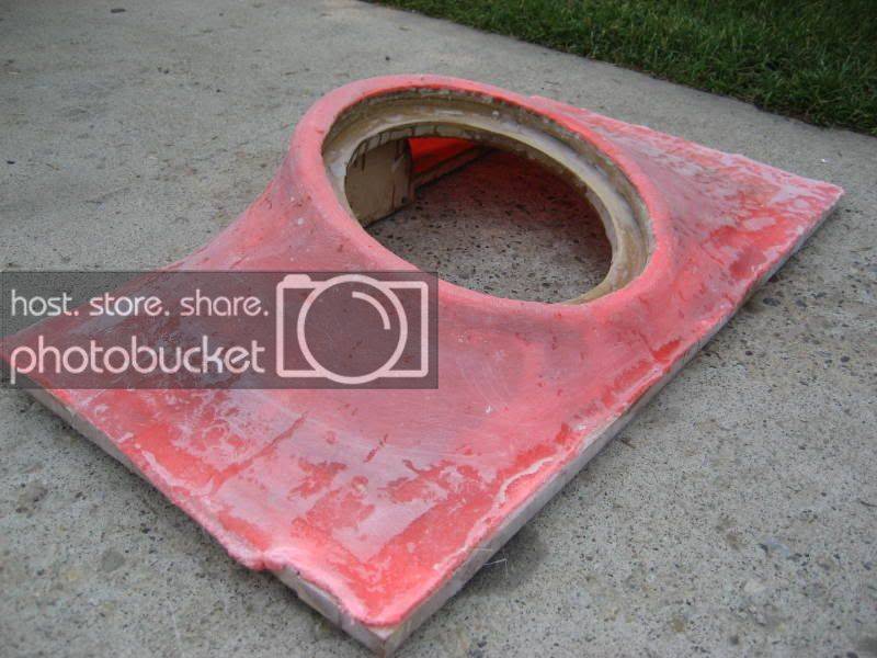

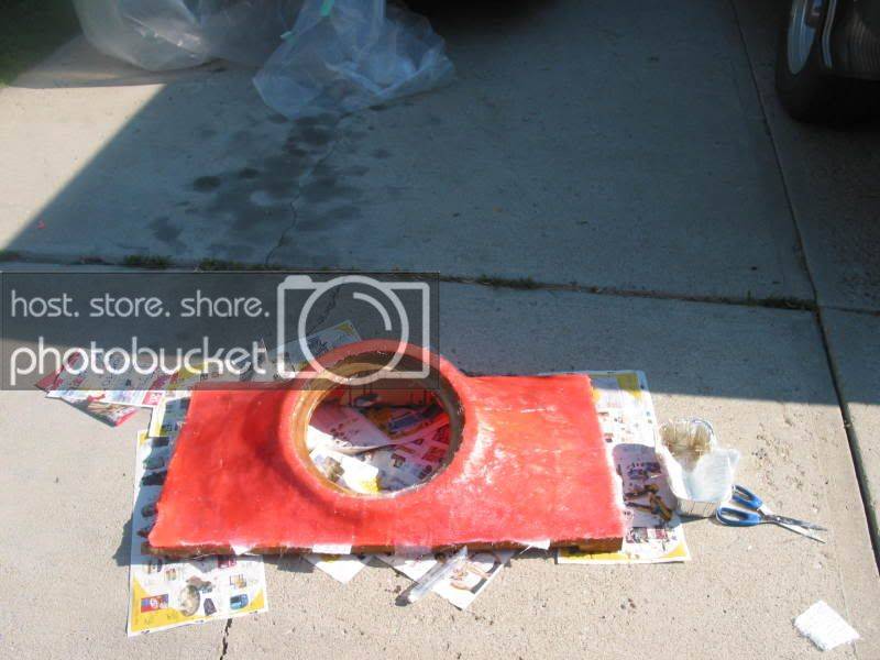

well i have been busy as hell but i managed to get some work done. i cut out the flushmount baffle for the sub a few days ago and attached it to the frame. then it got wrapped in the brightest pink fleece i could find //content.invisioncic.com/y282845/emoticons/laugh.gif.48439b2acf2cfca21620f01e7f77d1e4.gif jk its the largest piece i had. anyhow, i then resined it and let it cure. just moments ago i did a layer of matte on the top. there will be three layers to follow asap. during this time the top will be sanded/bondoed/sanded...etc....then painted black.
more pics soon..

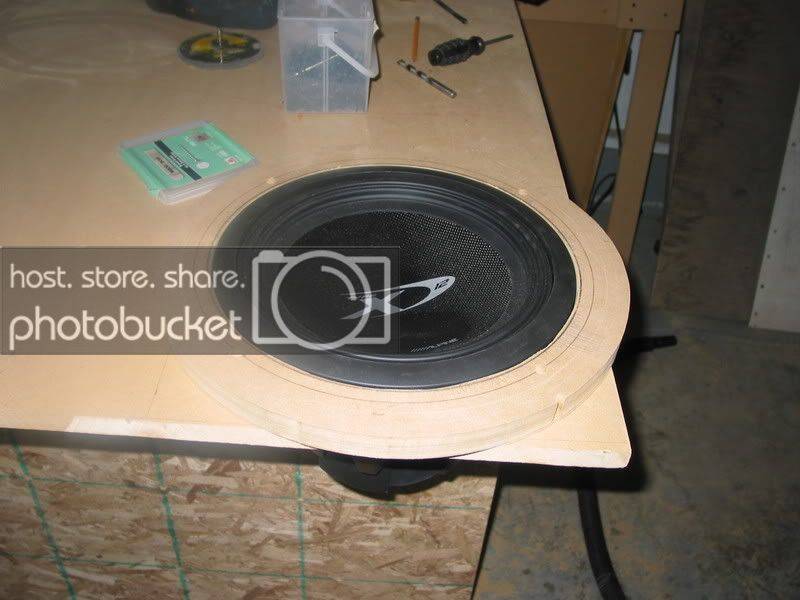

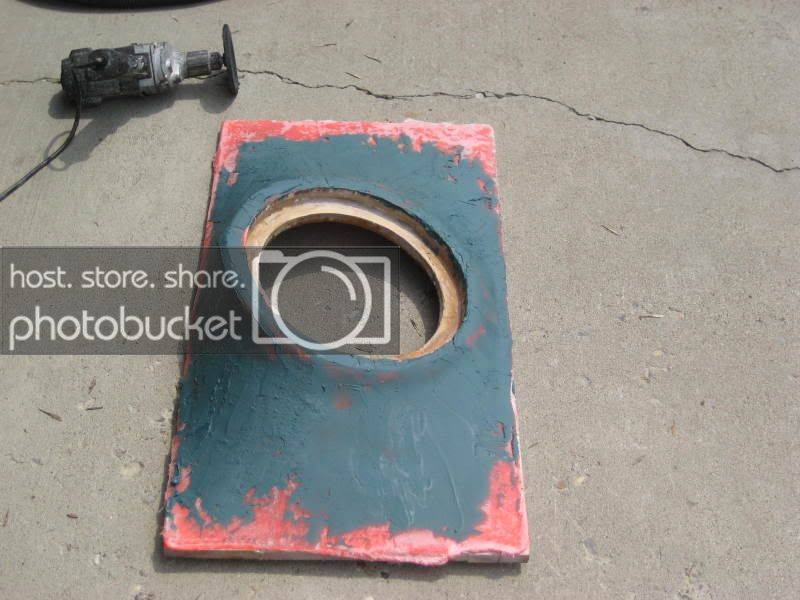

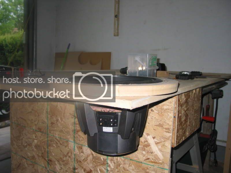

lol sorry mang. i just had the mount baffle in the sheet of 3/4....thats why it looks weird. it got cut out shortly after. it is a pita to cut 1.75" of mdf with a jigsaw that doesnt reach that far. haha i had to chisel off some of the bottom. anyhow i have nothing to do tonight since im going out the next two nights since its my 18th birthday(drinking age here). sooooo im going to get the first layer of bondo on. and yes...pics will be loaded in less than 10 minutes. i gotta showa first lol....//content.invisioncic.com/y282845/emoticons/naughty.gif.94359f346c0f1259df8038d60b41863e.gif
the pics will clear up any missdirection in whats going on. and you will see how secksi its gonna look. atleast i think so //content.invisioncic.com/y282845/emoticons/eek.gif.771b7a90cf45cabdc554ff1121c21c4a.gif

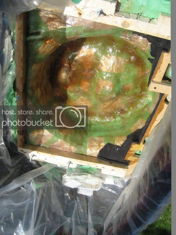

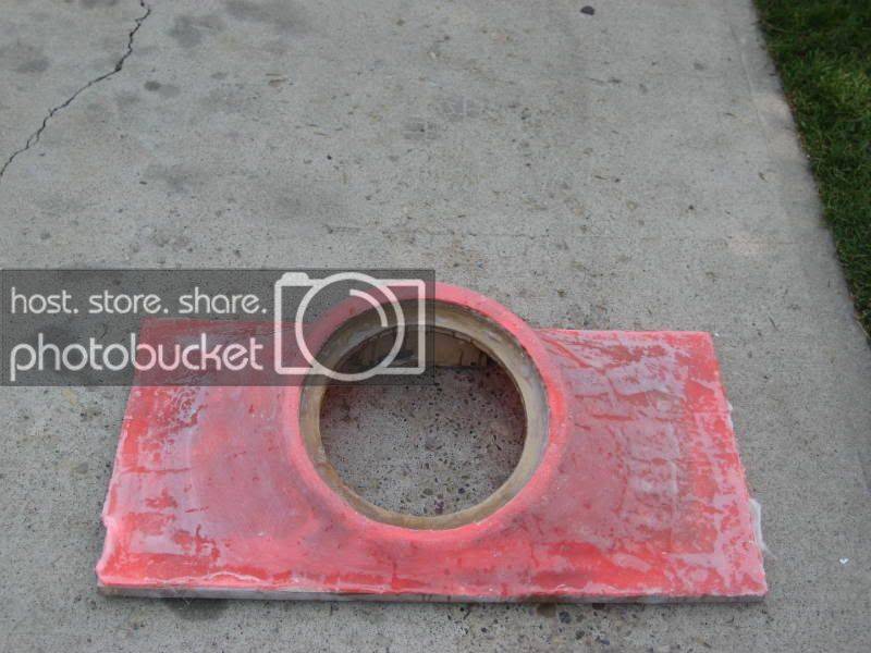

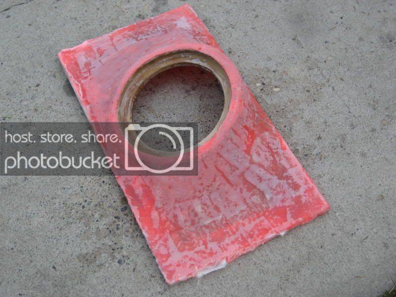

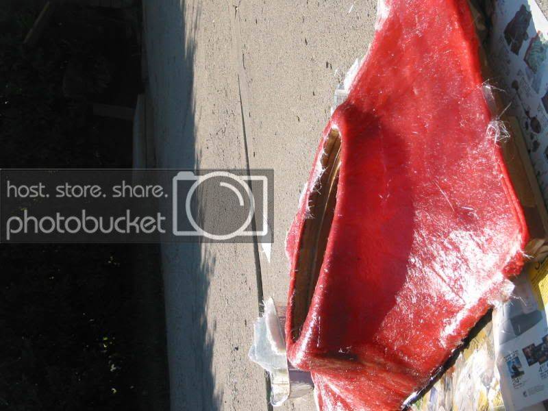

now skip ahead a day...after bring wrapped and resined once.
this is how its sits now. has been glassed like i mentioned before and after o post this shit im going to sand. then bondo...so expect another update in a few hours

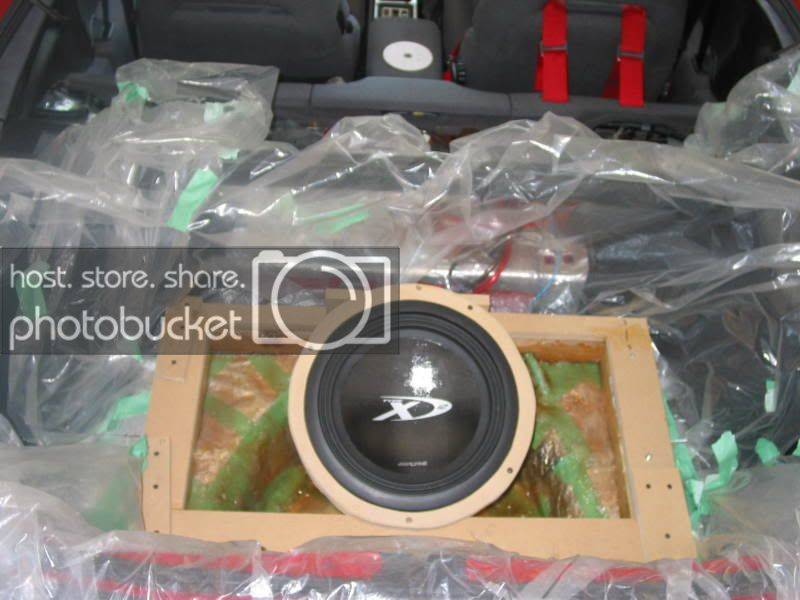

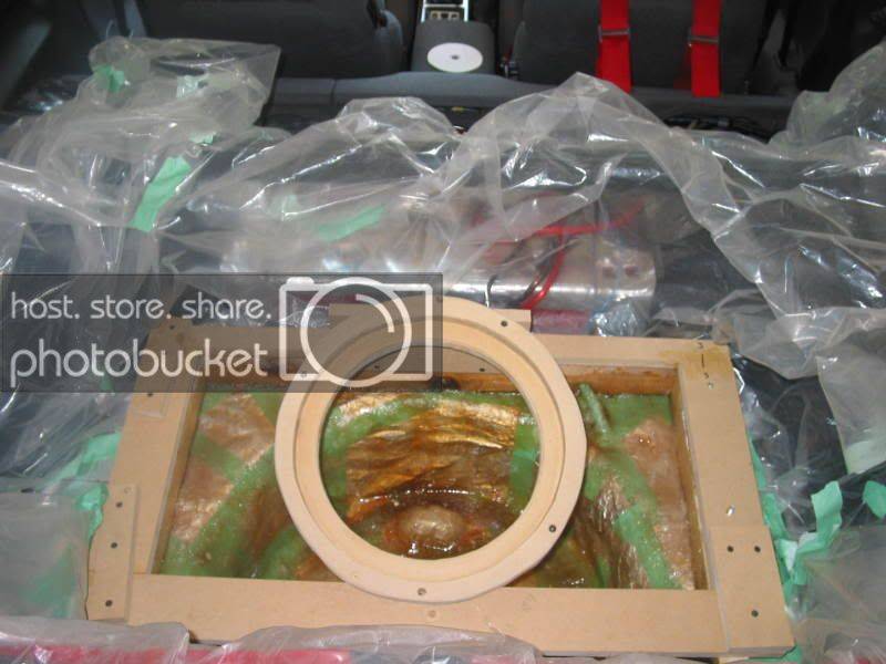

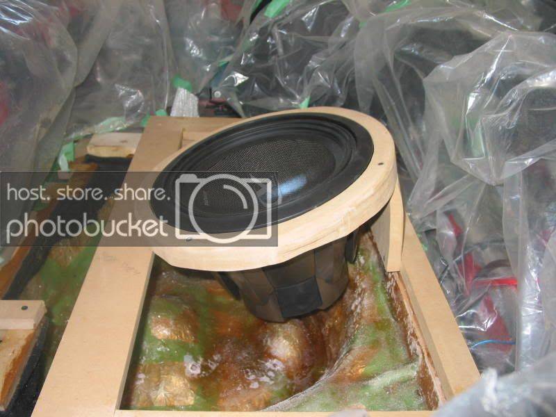

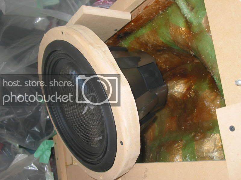

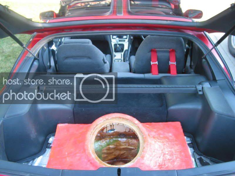

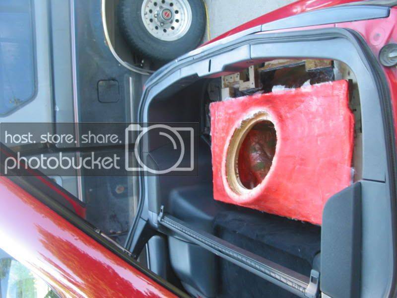

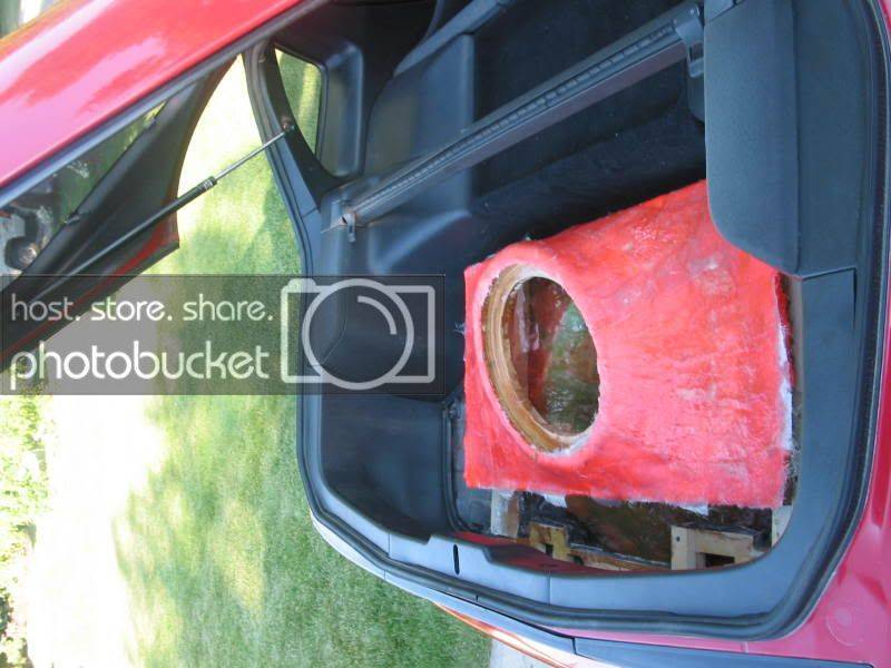

in the car with panels put back in. the owner got back fromnew bruinswick today so im going to let him know he can pick his car up until tuesday. its going to be super nice out so he may as well enjoy his **** car lol. i will be too busy to get too much work done...but since i built it with this frame i can work on the two peices seperately...so i will finsih the top piece then finish the trunk piece when iu get the car back. enoguh talk..more pics.

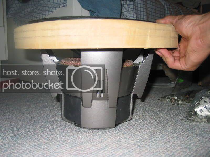

its just sitting on the bolts in those pics. it will sit about 1.5" lower. looking back i would have made the outer sub ring thiner but i like it the way it is. its different...and well it just looks sweet imo

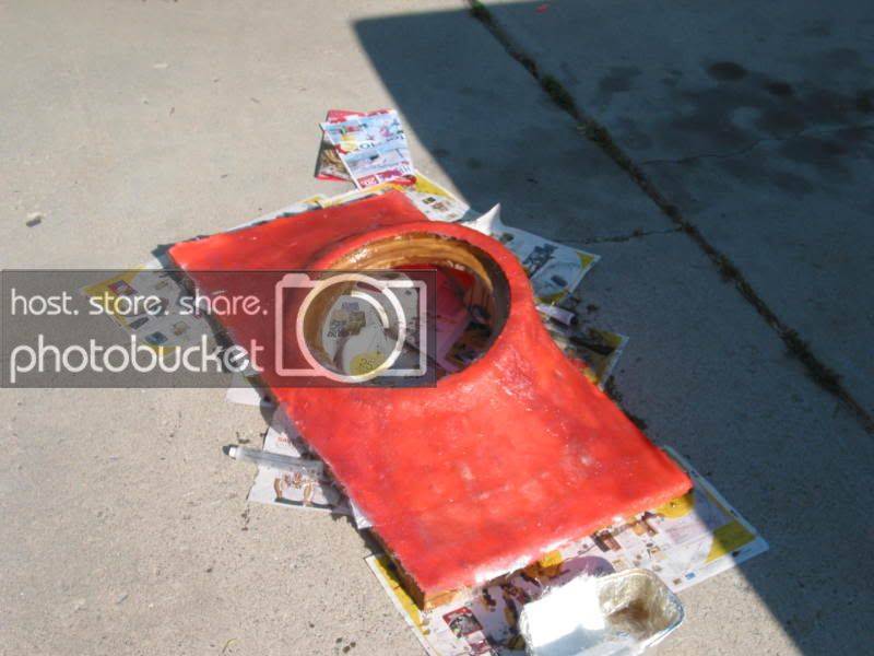

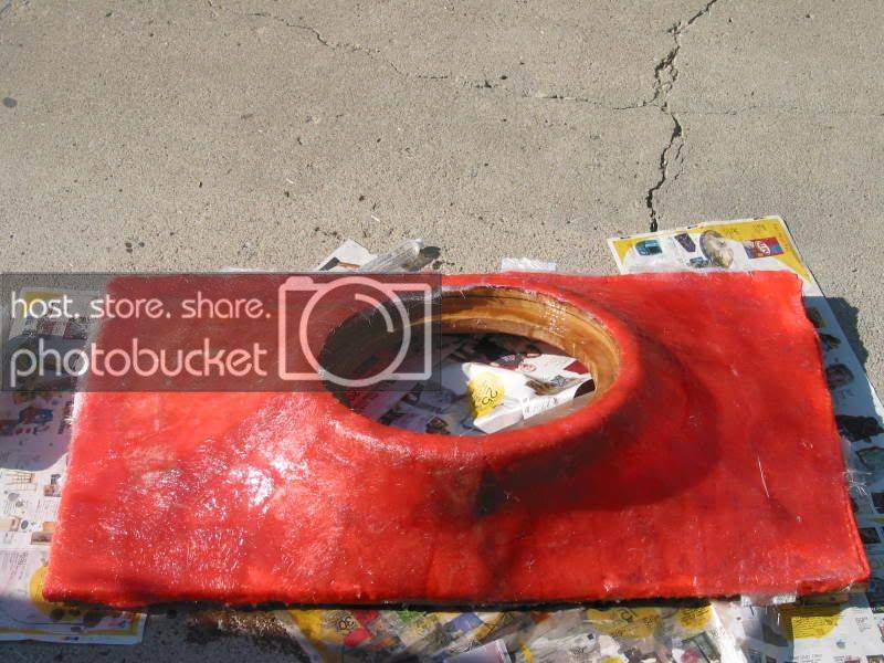

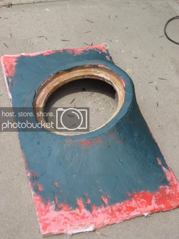

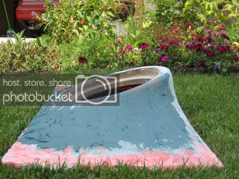

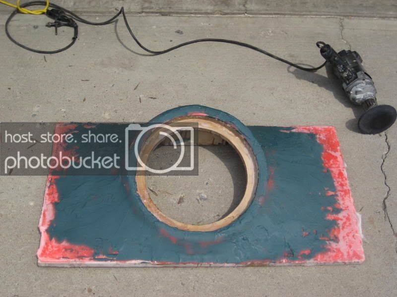

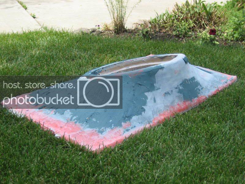

i just got the bottom side layered up with some fg. and the top layered with short strand bondo glass. im going to sand the shit down now...then i will post pics later.
