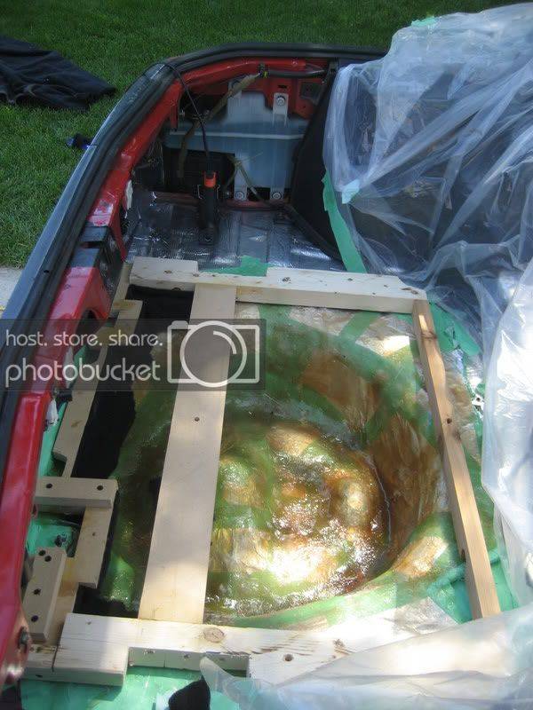

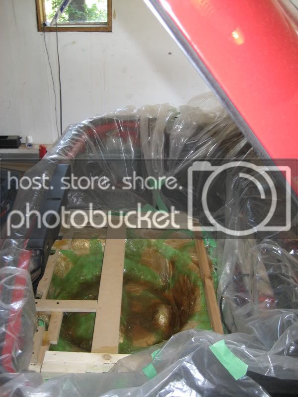

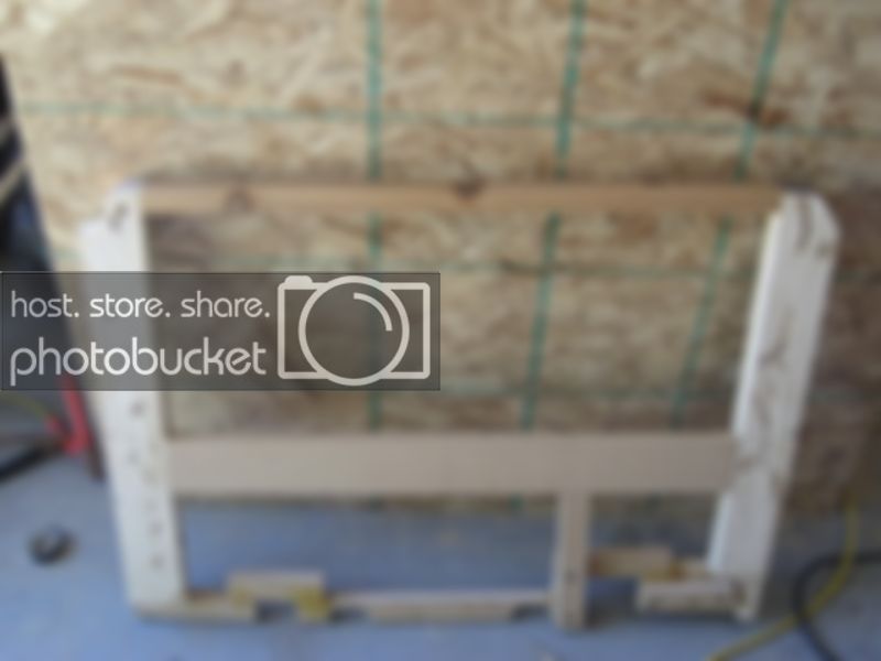

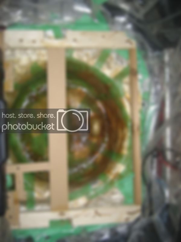

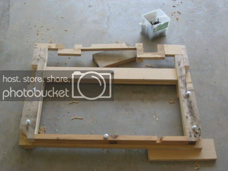

well i got a bit of work done today. i got the wood frame mostly built. it will be glassed together to the piece that is already in the floor. it will be one piece after doing so. then there will be a second fram which the sub will be mounted in. this whole piece will be bolted down to the floor piece via 6 1/4" bolts. i know this may not be the traditional way to build a fiberglass box, but its how i want to do it. this way if he ever wanted to keep the same style box but change subs all he would need to do is have another top peice built. or perhaps if he wanted to port it, it would be much easier since the top comes off. but after reading up on the type x, its not going to be ported.

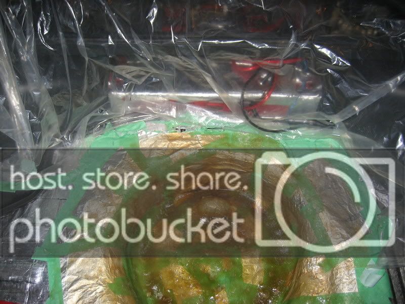

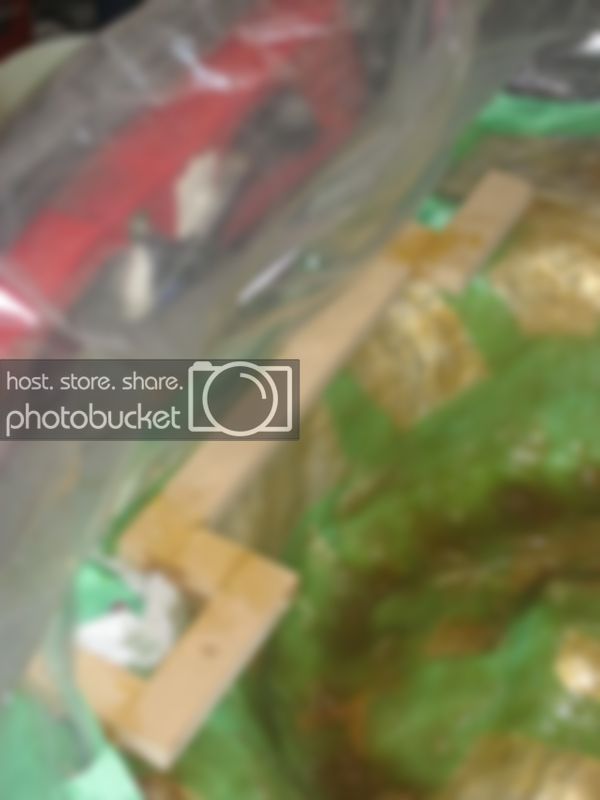

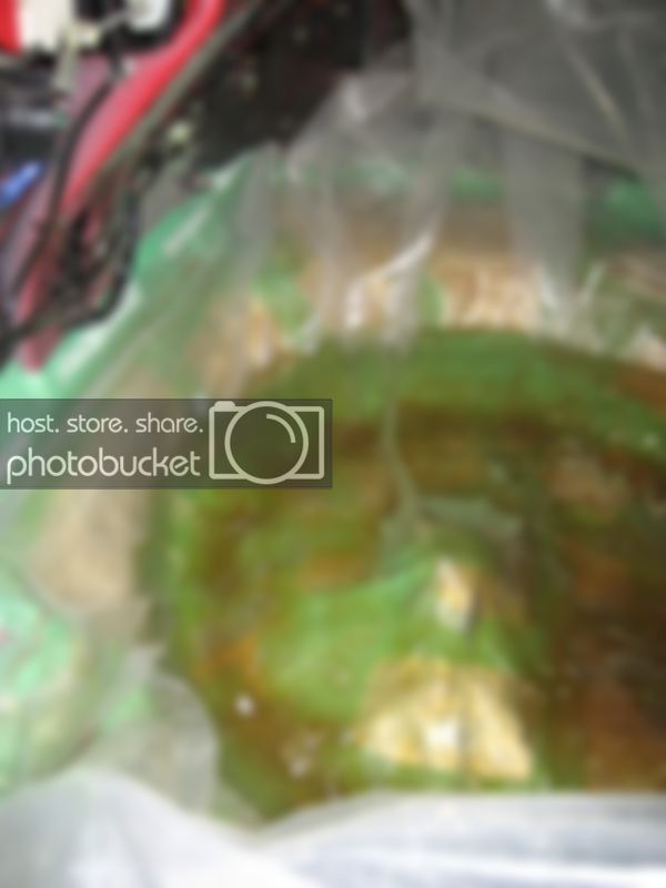

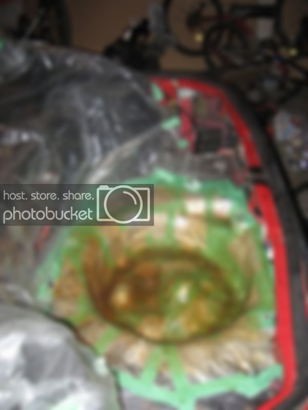

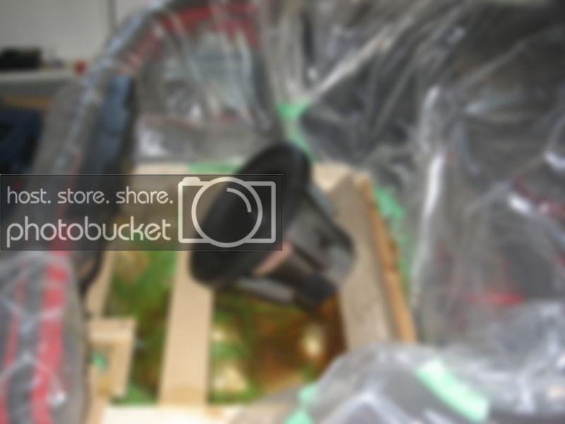

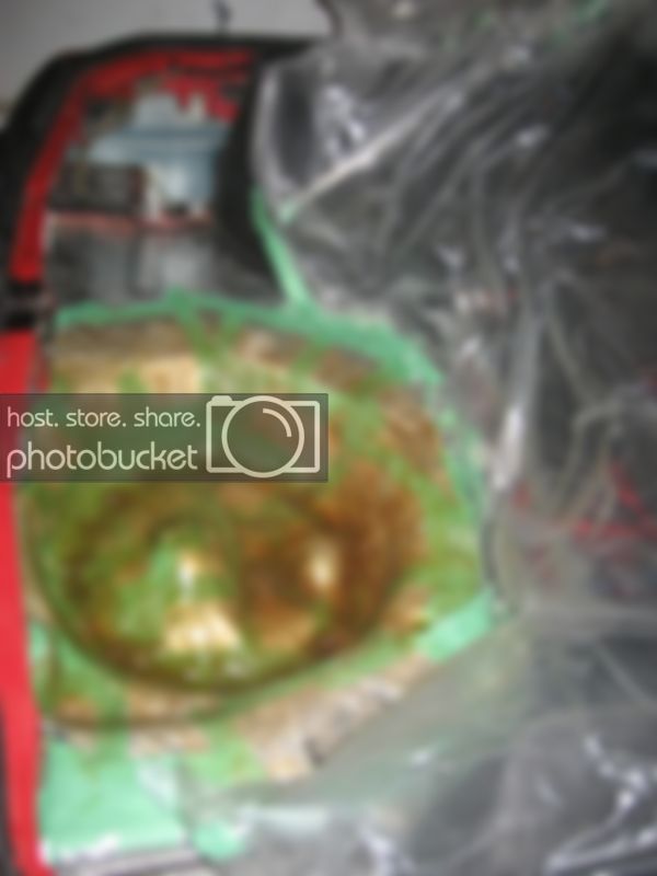

well i just poured a lot of water into the mold and found the volume to be very close to 36 litres. that is roughly 1.27 cubic feet. here are some more pics

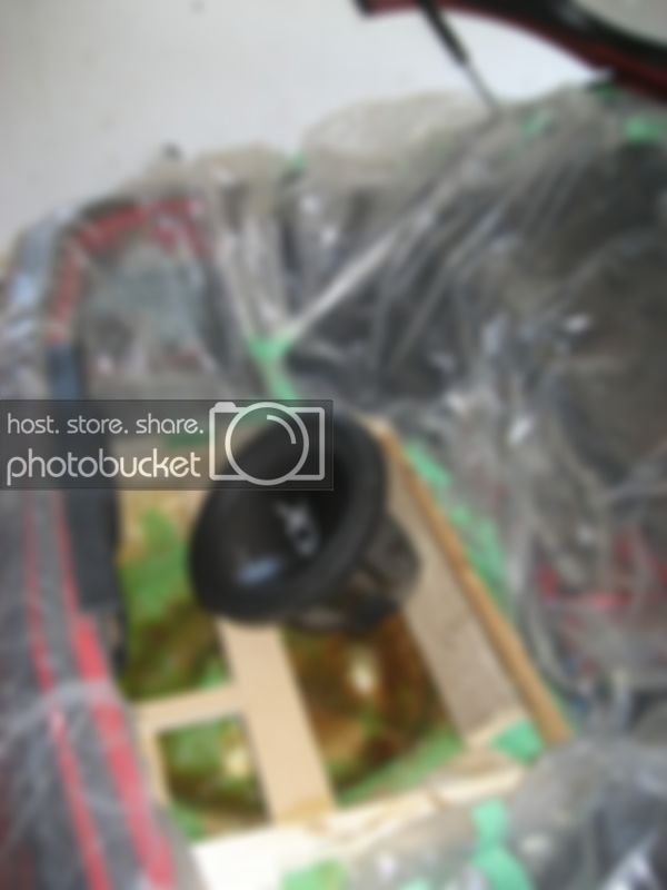

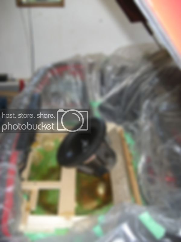

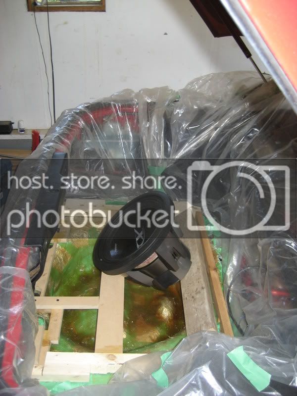

nice. i'm gonna be doing a sealed enclosure in my spare tire well in a few months. with a hatchback, would there be a noticeable sound difference with keeping the sub pointed straight up or angled like yours? i'm trying to keep mine horizontal because i'm going to put a false floor over it.
i dont think there would be much if any difference in sound having it slightly angled. and i do plan on building a false floor as well //content.invisioncic.com/y282845/emoticons/wink.gif.608e3ea05f1a9f98611af0861652f8fb.gif

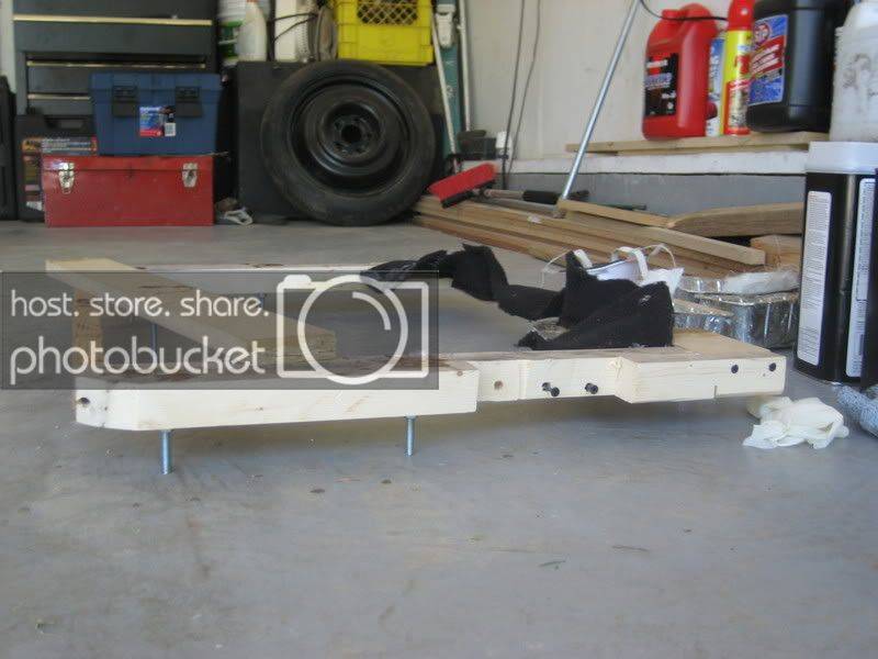

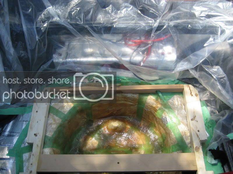

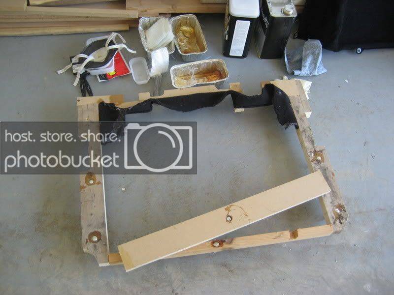

well i finished the top frame so im just wating on the resin on the bottom frame to dry somehwat. i resined over the 6 carriage bolts so they wont move when it comes to screw the top peice on. here are a couple pics
