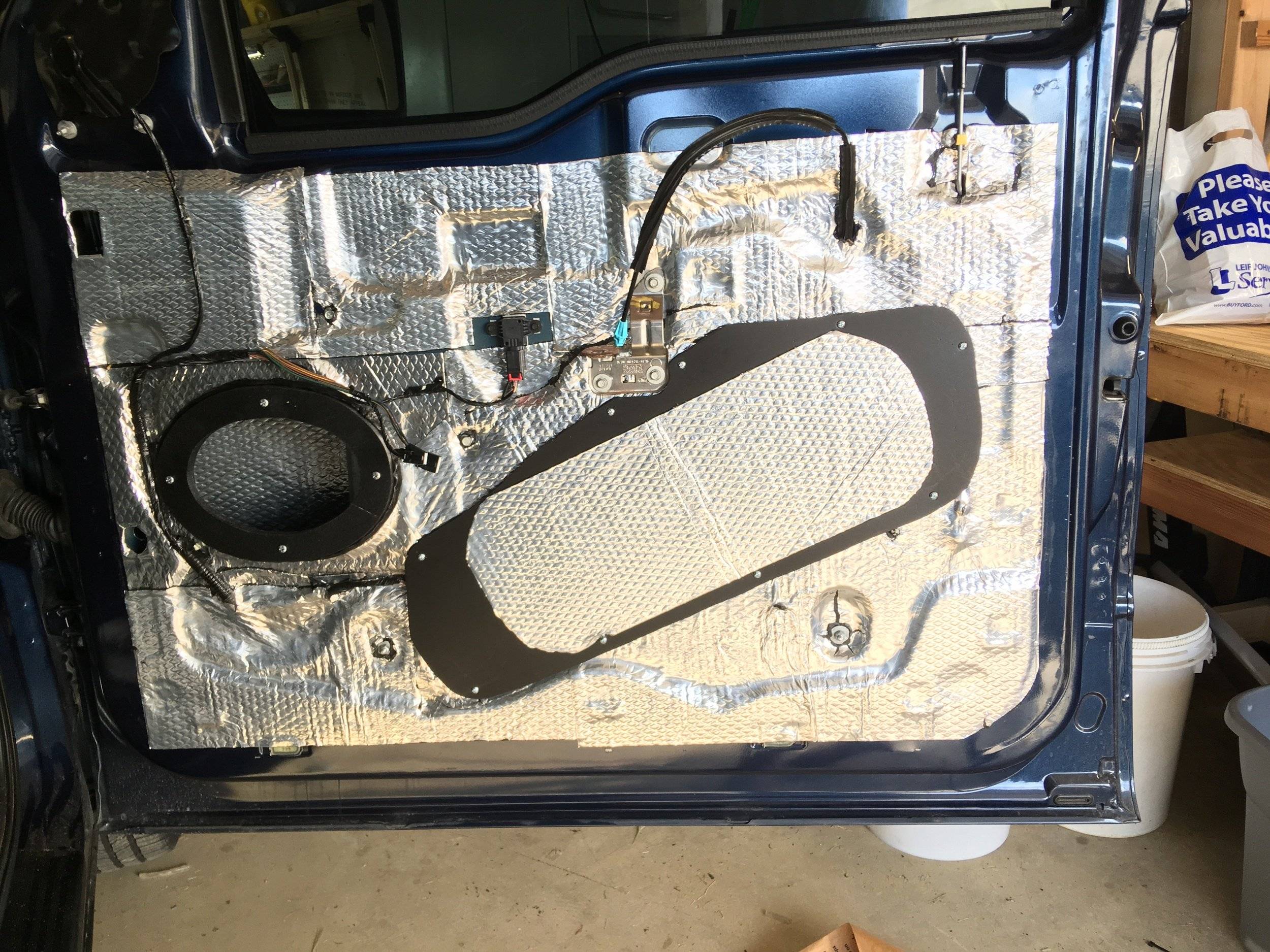

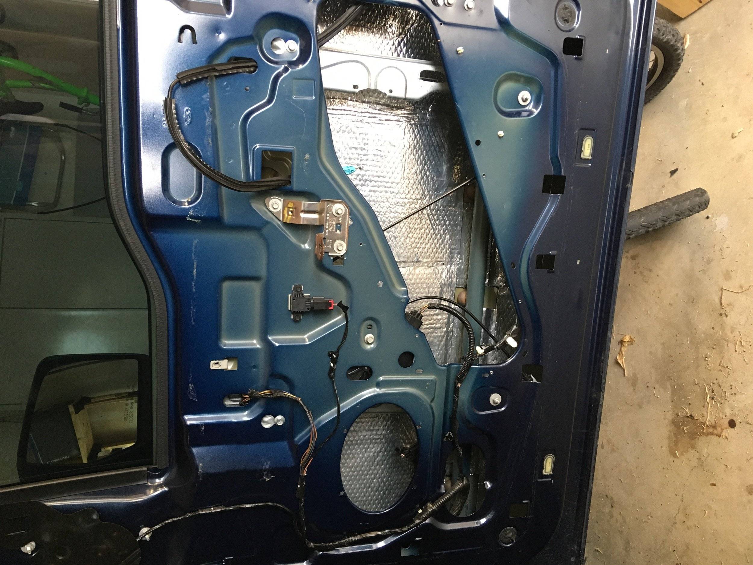

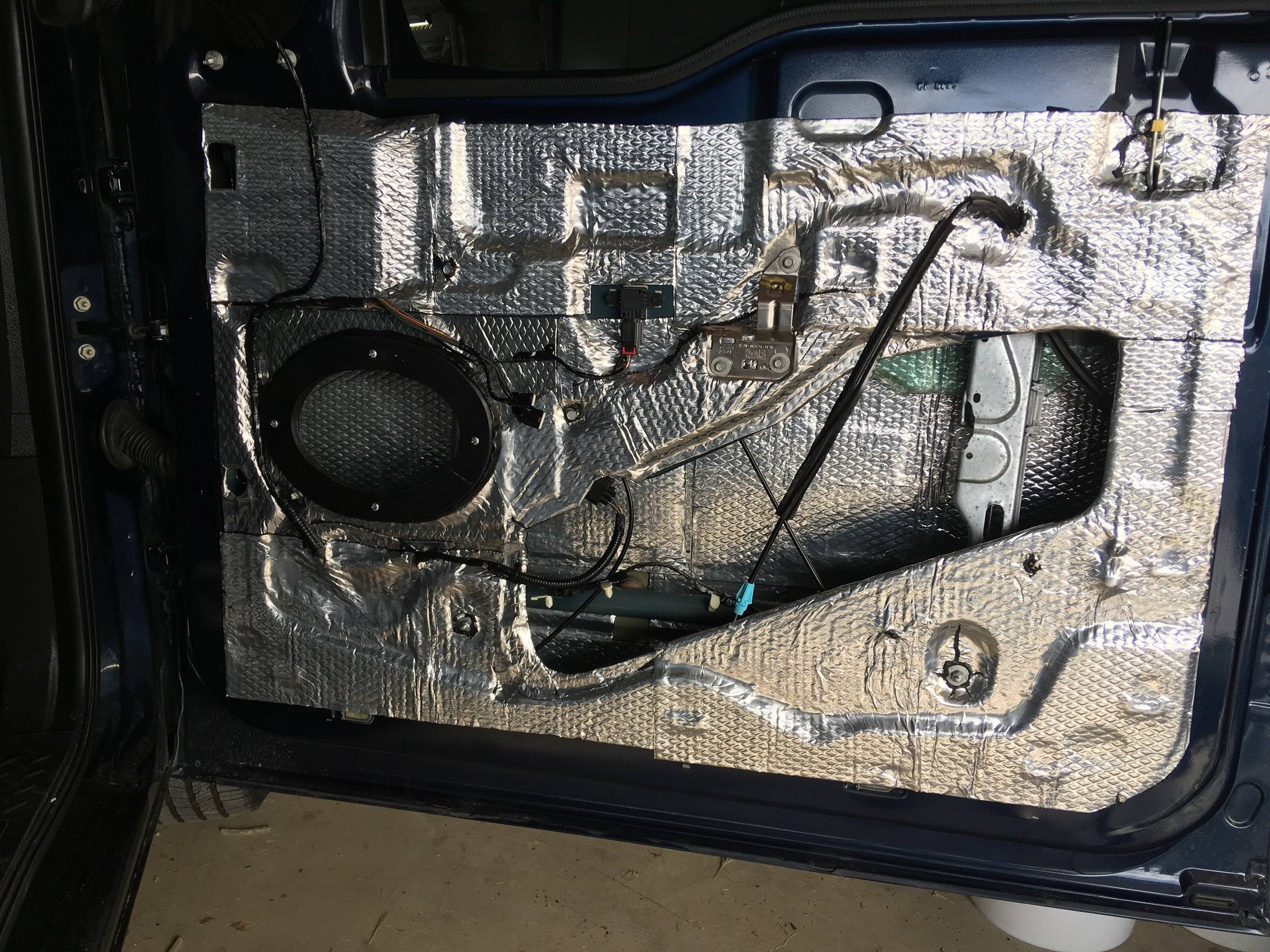

Just finished installing my Focal components and Pioneer GMDX-975 in a 2-way active configuration. Here’s some pics of the door. I’ll post pics of the Head-unit later. Sub and box haven’t been purchased yet. Have 2 layers of deadening on the outside door skin and one on the inner. 1/2 MDF rings coated in liner sealant. Butyl rope around rings and block off panel. Panel is 1/4” blown PVC. All connections are soldered and heat shrinked.
