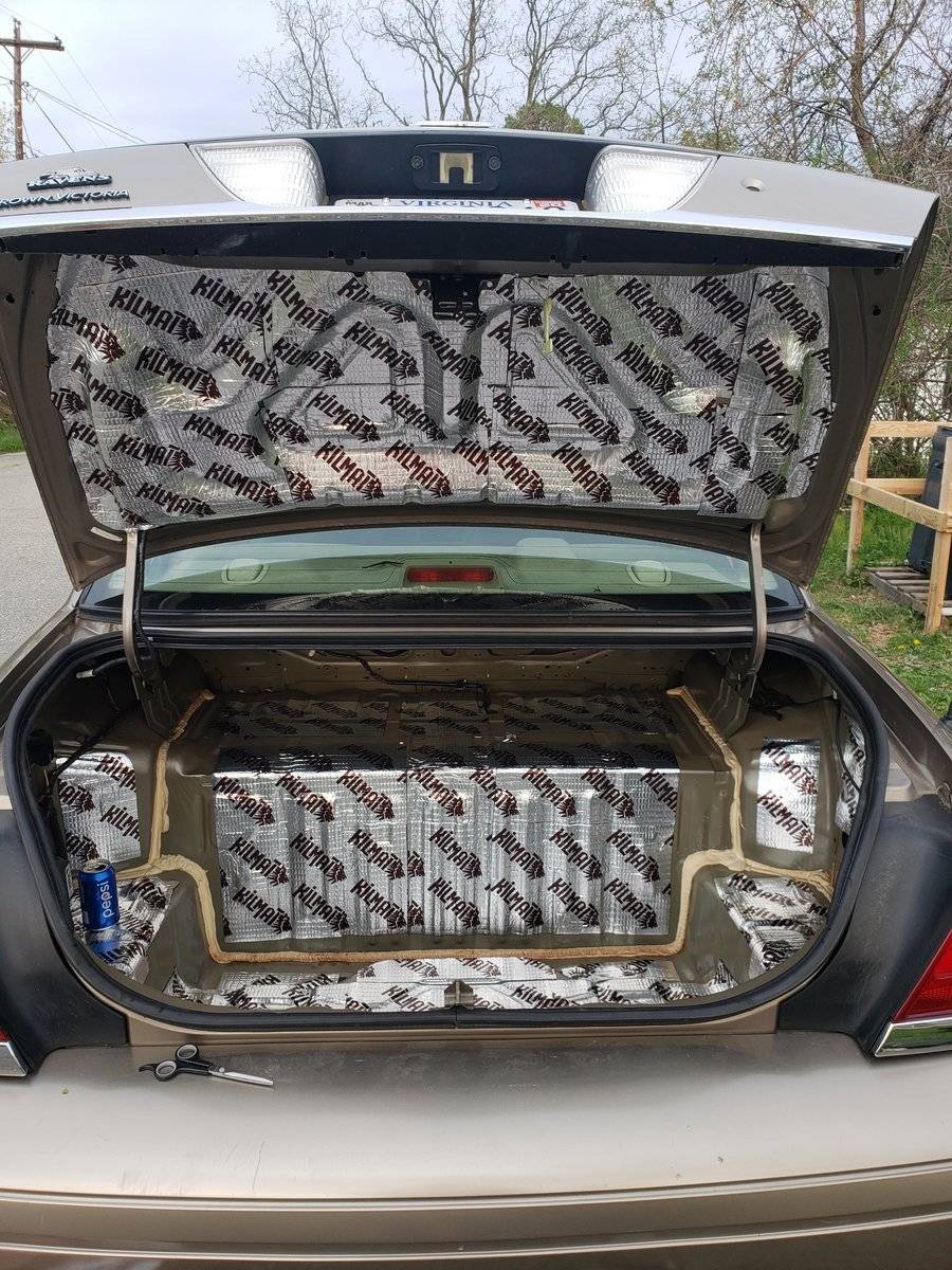

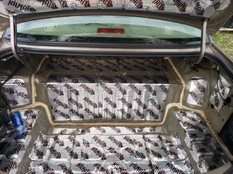

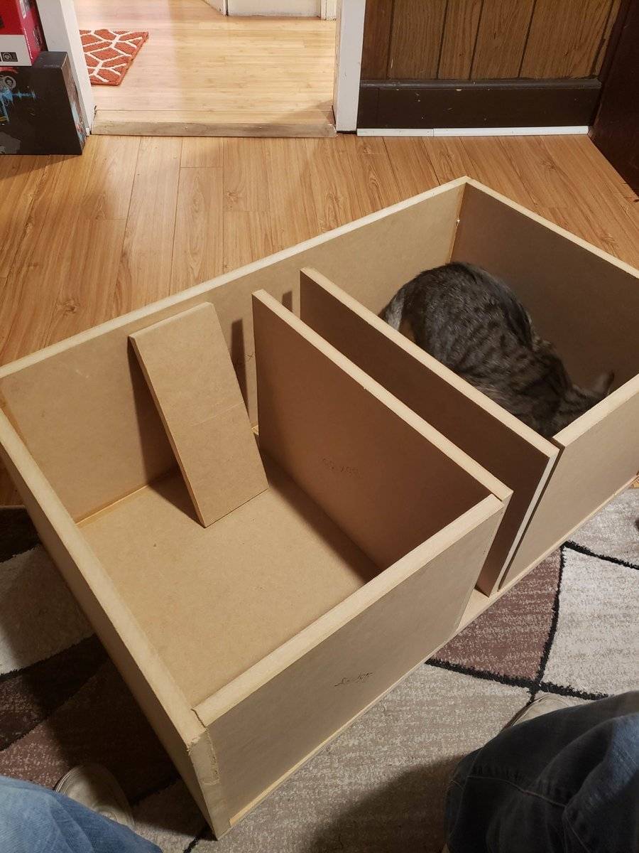

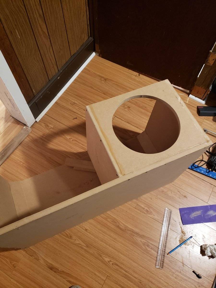

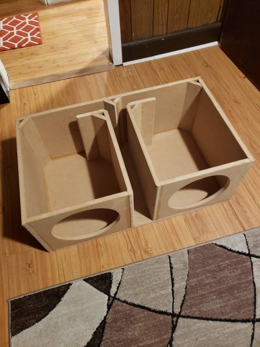

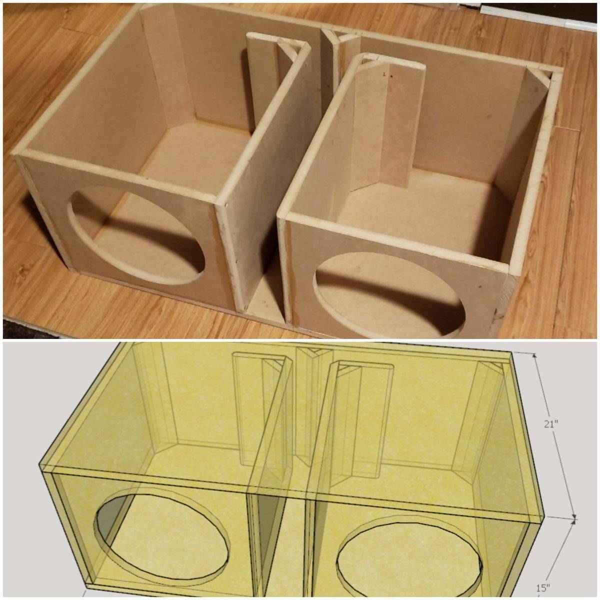

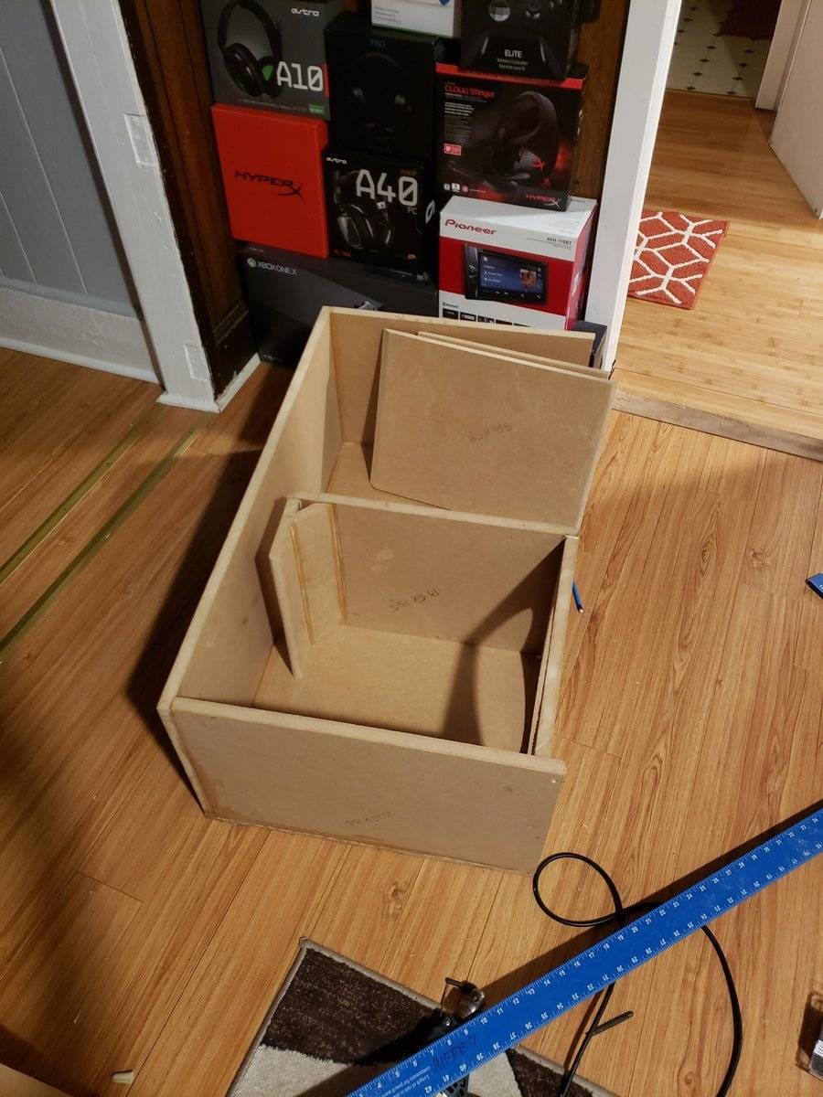

This is my first time building a box, so don't judge to hard. I have received a lot of help from @shredder2 . Unfortunately i only had a skill saw, drill, router and a Dremel tool. Box is 4ft^ @ 32hz
Specs-
Subs - 2x Sundown Audio LCS @ 1ohm
Amp - Soundqubed S1-1250 @ 1ohm
Will post more pics as i complete the build
oh hell I all I seen was the 😻. What's in the heart shaped box??

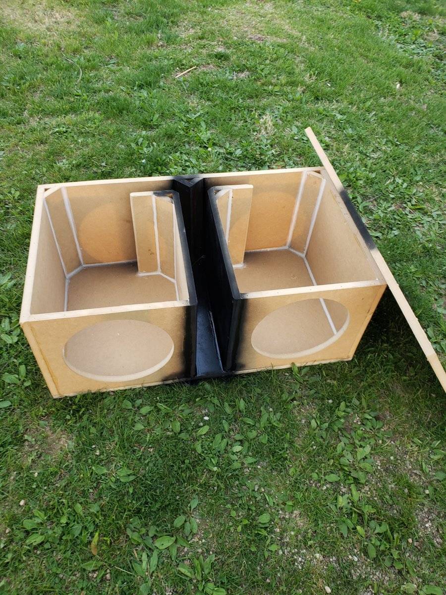

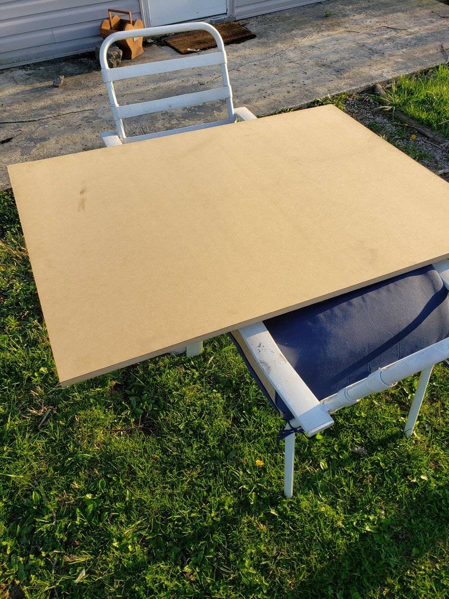

I remember my first box. Circle saw and a jig saw. Setting up fence every time you turn around with cheap azz clamps screws dusty  mdf measure measure measure and more measuring... oh i like your saw horses too. forget what i used..

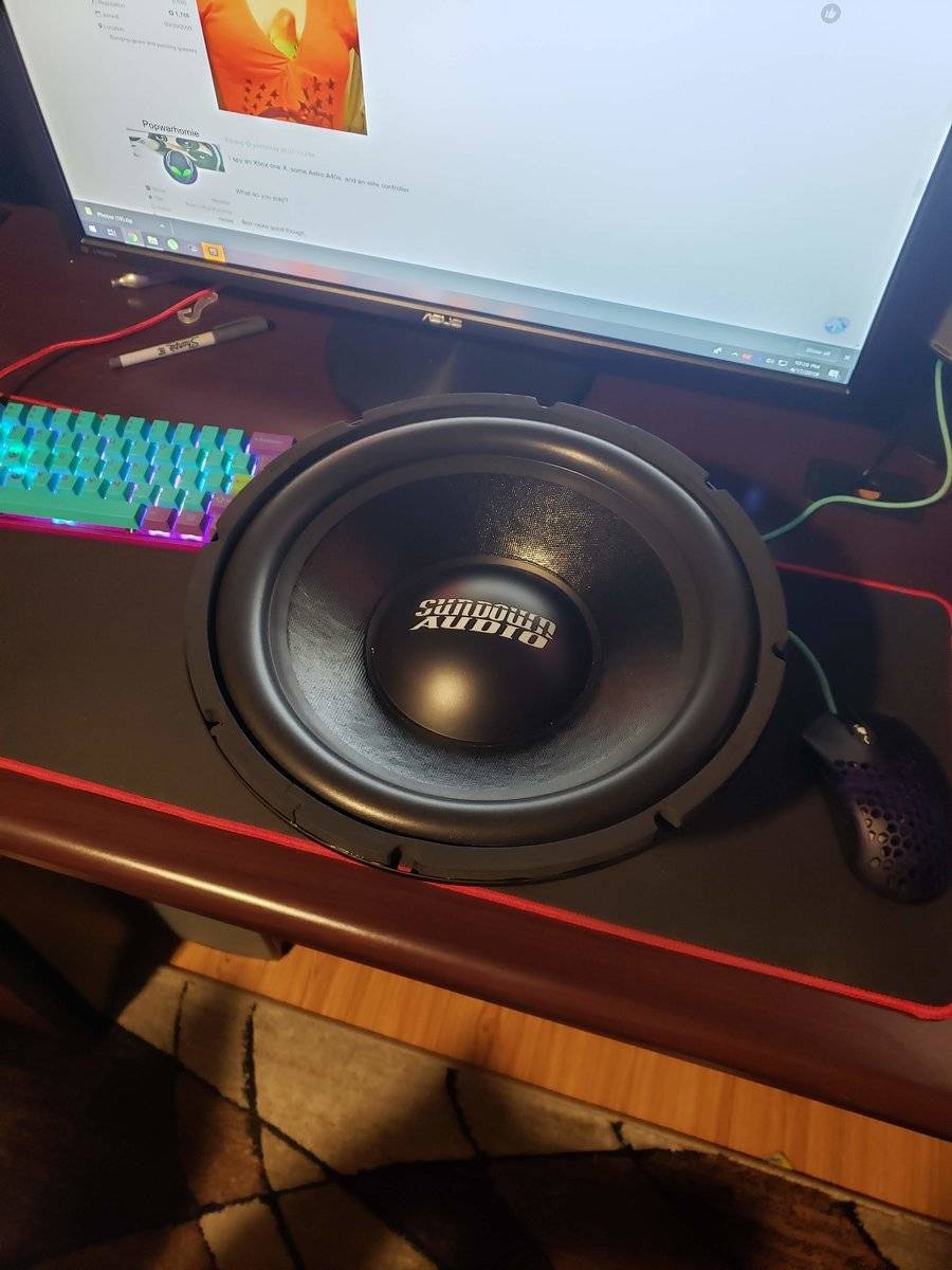

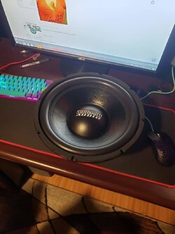

2 Sundown LCS Subs = 90$ shipped. Got these off the yard sale page for 90$ shipped. Checked the ohms on each VC and its right on 4. Hopefully they're good. Hopefully they went to yard sale because of the paint chips/rust.
