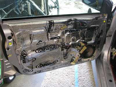

did better on the plexi this time around. not that the other side was bad...

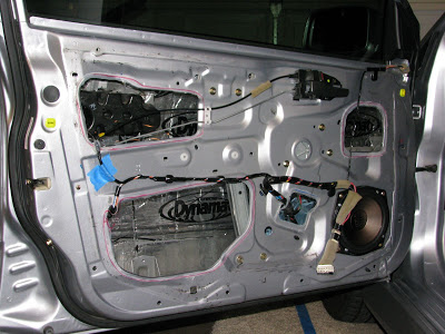

more dynamat xtreme. ruins scissors...

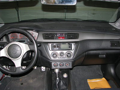

boring dash pic, i'll put a movie on for a little flair...where did i put 2F2F?
