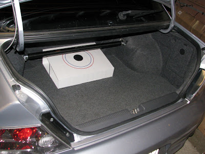

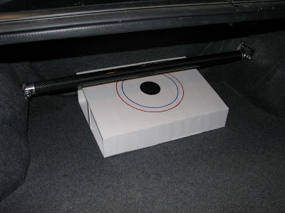

Trying to work out a sub-woofer solution. Made a mock up of a Rockford Fosgate P3L-S10 to see what kind of room I'd be losing with a similar style setup. I like the idea of a removable box or at least that it's movable. I have a couple sub woofers that I was going to try. One of them requires a 1.5 cu ft ported box, that's bigger than I want to go so I have another on the way that requires a .66 cu ft sealed enclosure. The Rockford mock up worked well because the trunk bar blocks that space from most things anyway. When I did need to fit larger things in my trunk(3 boxes of desk calendars) the box could be moved or put on top of the items. I really want to try and make a fiberglass enclosure. If I like the sub in the smaller sealed box then I think I will go ahead and try and make one.
the bottom of the bar sits 7.25" above the trunk floor
still allows for a pretty usable trunk

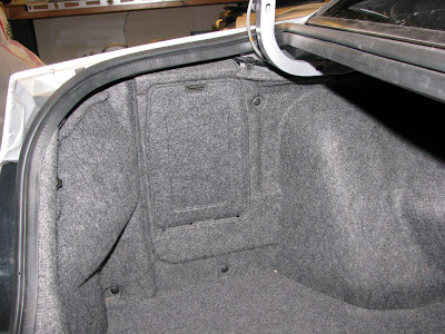

the space I'd use for the fg enclosure

Have you made any progress on the box yet? just an idea to throw out there to prevent any size requirements due to the strut brace...
Make a box with a 2ish inch tall cutout to fit around the brace, and make it as deep as the distance from the brace to the back of the seat. That way the bar can go through the box, instead of building a box that will only fit under it. thats what I had to do when I built a box for my buddys sti and it worked out really well. Whats nice about it is you can fab up a little hook for each side of the box so you can even use the strut brace to anchor the box in place so it doesnt hit the trunk lid every time you get lead footed from a stop, as im sure happens once in a blue moon in an evo ha

I have not started the box yet. I just got my sub on thrus so I need to get started. I went with the Polk MM1040DVC. According to Polks website the RMS on the sub wired to 2ohms will match my amp at 2ohms. The manual says different so we shall see. The two pluses were that they claim to use a Neodymium magnet for light weight and the recommended sealed box is only .66 cu ft. I've thought about doing what you suggested with the trunk bar but I hope I don't need to. This is my first box build and I'm hoping to keep it as simple as possible. I tend to use the space under the bar, anything less than about 7.5 in fits under it. I guess my next step is to buy packing peanuts and see what size box I'll be dealing with. If you have any pics of the box you mentioned I'd be interested in seeing it.

ill see if i can snag some pics when im home for thanksgiving, but unfortunately I dont have any with me right now. I would definately go by manufacturers specs for the box size, and if their specs fit under the bar, by all means thats gonna be the simplest build.

Ultimately I want to make a FG enclosure in the side pocket of the trunk. The mock up was of a Rockford enclosure I was thinking of getting. I won't have much time until after the end of the year to work on it. I think I'm going to buy a sealed box for the time being just to get it going while I work on the FG. Haven't really thought about deadening the trunk yet. You are right about the weight, supposedly my model year has a 1lb weight reduction on the trunk itself and the paint on the cars is notoriously thin for supposed weight reduction.
Side pocket enclosures are great for the simple reason that they take up the same amount of space, but generally dont take up much, if any useable space. Just make sure its easily removable. I found that out the hard way when i had to change a tail light bulb and the box was formed to some crevices that just didnt let it out. I ended up having to cut an access hole to the back of the tails and re-FG it. definately the most labor intensive light bulb change ever
