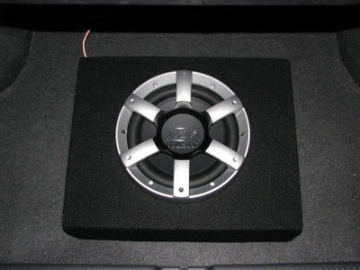

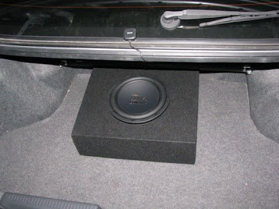

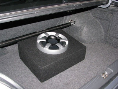

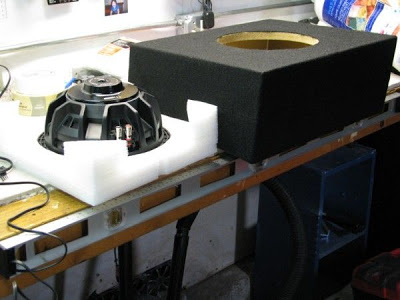

polk MM1040DVC, I think it's a nice looking sub
dual 4ohm voice coils, 270rms

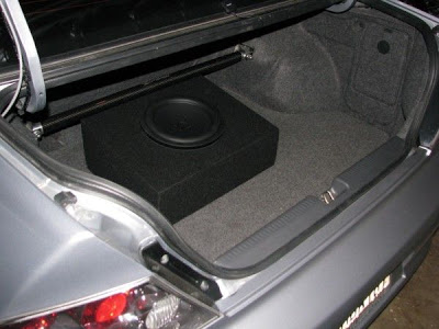

box is off ebay, I know, I know, but it is .7 cu ft, recommended is .66 cu ft and it fit (kind of) where I wanted it to
sub sticks out too much to get under the bar but that's ok.
Just let me say this is not my ideal setup. I don't have the tools to make my own box or I would've and I don't have the time to make my fiberglass enclosure right now. I added the grille because I thought it would look better than it does. I wanted the silver to tie in with the color of the car. I don't know, it looks just ok to me, a little awkward. I'm probably going to leave it, it'll be worth it if it protects my speaker. I'll probably ditch it when I do the fg or just paint it. Guess I could paint it now...
I ran into a few issues with the whole sub side of the setup. I connected everything and powered up the sub amp...then nothing. After two hours of checking rca cables, pulling the amp (without removing the seat) and rechecking all connections I hit the reset button on the h/u and bingo...some sound...very little though, had to put the sub volume to +8 (out of 8) to even tell its there. I wanted a subtle low end but this is ridiculous.
Come to find out my main pre outs front and rear are 5 volts and my sub out is 2 volts. I haven't messed with the gain yet, I just found out this info, not sure yet how if at all this is affecting my low output. I didn't know pre outs had rated voltage or that it matters.
My other problem is with the cross overs. The amp and h/u both have cross overs that are always on. It's my understanding to only use one but in this case I can't. The LPF on the amp is adjustable from 50-200Hz and my h/u has a selectable one, 55Hz, 85Hz, 125Hz. My thought is to turn up the amp to 200Hz and then use the h/u to do 85Hz. I read somewhere about cross overs introducing phase shift and causing problems when doubled up. I have no idea what that means, yet. Am I screwed with these two crossovers?

If the gains on both amps are the same then that's probably your problem. with a high preout such as 4v or 5v youll be able to keep your gain down, but with 2v the gain usually needs to be higher to match the voltage. set the gains properly for each amp & also the x-overs & see if that doesnt cure your problem.

I didn't mess with anything yet. I was waiting to get everything installed. All gains are at 0 or nom, I think thats what it says. I'll mess with it tomorrow. My main speakers sound great without touching the gains on the main amp and play plenty loud for me, I can't turn them up all the way, after 3/4 it hurts. I'll turn up the sub gain to see what that gets me, basically I want to balance the outputs. I started reading about gains but honestly it's a hard read and I don't fully understand it.
I think it sucks that I have two components that have cross overs always on. Is that common? If it is then it shouldn't be a problem. I'll be a little upset if I have to find a new sub amp.

with a dmm you can get the gains close to where they should be, that'll help a lot. & to be honest, I'm not sure about the x-over...all the h/u ive used before had an off setting for x-over points.
Looks good. Only thing I would've done different is build the box wider, shallower, and not so deep so it would've ran from end to end all under the bar. It would give it a much cleaner look. Otherwise, it's a nice looking sub. Great job so far.
nice job so far man why not look into a 8 or 2 you get a good amount of out put as well as weigh very little my 8 by it self only weighs 9 pounds and im running 250 rms too it and it has good out put
Thanks! I would like a box like that too. I did not build this one. I would like to utilize as much unused space in my trunk as possible. I'm going back and forth between a box like you described and a FG enclosure.
Thank you. I'm looking at 8's, not opposed to switching it up. 9 lbs sounds great.
