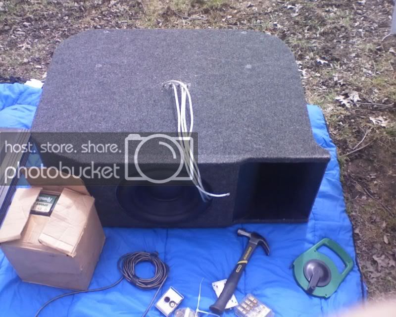

Just because you weren't at finals doesn't mean you couldn't copy his box to the exact dimensions.
Want proof?
Oh hey! Look at that! Looks pretty darn identical to me, even down to the sub model and duct tape.

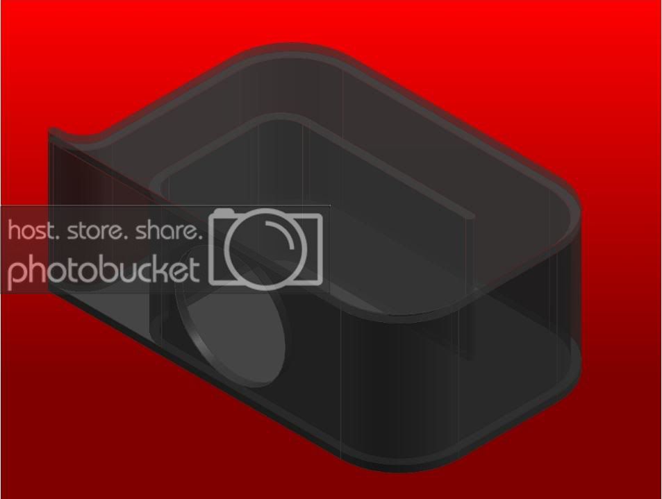

Designed and built this about 2 years ago. Shit optimized.

Copy? Not necessarily. Take notes and pointers from? Absolutely. You acted as though you tested tons of designs without referencing previous vehicles, which is a lie. Your boxes are seemingly identical to terry's boxes from the previous years. You're trying to tell me thats strictly coincidence? I don't buy that for a second. Everything about them is the same. The dimensions (which I used to have but can't find them anywhere, I want to say 12x12x24 or something along those lines), the ports, the orientation, everything is the same.

This thread gives he Lulz, Tuan. I dont believe anything you are saying. How did you bend the wood with out Kerf cutting? Soak the wood in water to bend it? lol....

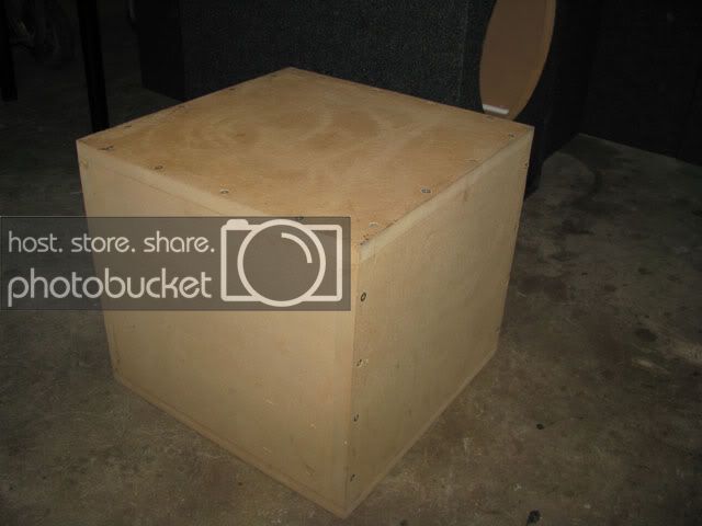

Don't believe me? Call Greg from US Amps/RE Audio or Roger Bridges from Crossfire. Both of them have seen all the boxes I've done. I started out with 14" x 12" x 12". Then I went smaller, 13" x 12" x 12". Then longer and smaller. After 12 boxes, you learn which works well. The box I ended with was the smallest physical rectangular box that would fit a 10" sub while maintaining the same volume. Then I placed 45 degrees in all 4 corners but changed the internal volume. This didn't work well. I went to look for 10" or 12" pipes but couldn't come across any before finals.
Like I said, I was building 2 to 3 tests boxes at a time. Here is a picture of a test box that I never used because I realized going skinnier had better results. I never bother cutting the port holes and sub cutout. This is still sitting here in my garage. I'm sure a ton of people had these boxes, but I surely didn't copy them.

I'm not here to sell boxes. Thought I'd share some pics...but lead to a bunch of non-sense. This is definitely not Kerf cutting. Do you see cut lines? Believe it or not...doesn't matter to me.

David, you can bend wood without kerf cutting. At least you can with good wood like birch, or pretty much anything that isn't made up of dust and glue (MDF).
I don't know which method tuan is using, but I have seen people use steamer boxes to soften the wood which allows them to make curves without breaking the wood.

There's really no method and I'm not bending MDF or wood. The port is a flared type. There are many ways this can be achieved. One way: use a quarter of an 8" PVC to achieve a 4" bend. Then reinforce the back with a 45 degree bend to strengthen and prevent any leaks. Nothing special to be honest.
Kerf ports are almost impossible to do for mass production. It's tedious work and are very fragile.

I agree that kerf ports are very difficult to do in large quantities. Even the method you mentioned is still a pain in the arse unless you have some tools set up specifically for cutting PVC.
I'll stick to aeroports!

Yep. Aeroports are the way to go...but they're also expensive. BTW: I'm sure you already know, but the flare ratio on the Aeroports are's the most efficient. There is a better flare ratio that will gain about 0.2 db...but requires custom building. Also a pain in the butt to build.
