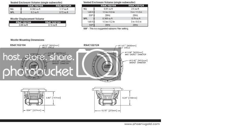

ssssooooooo.....can i get one yet ? lol.... id be intersted . pm me if you would like to make and ship me one and price... it would be for one of these pg rsdc 12"s..
Here is a link to the full Manual (which includes the T/S parameters, physical dimensions, and recommended enclosures.
Its a whopper 23MB (for only 8 pages?).
http://download.phoenixphorum.com/Manuals/Speakers/RSD/RSdC%20subwoofer%20manual.pdf
