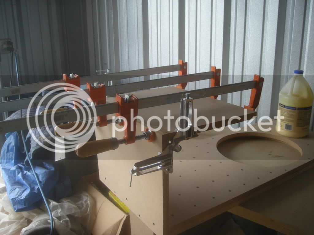

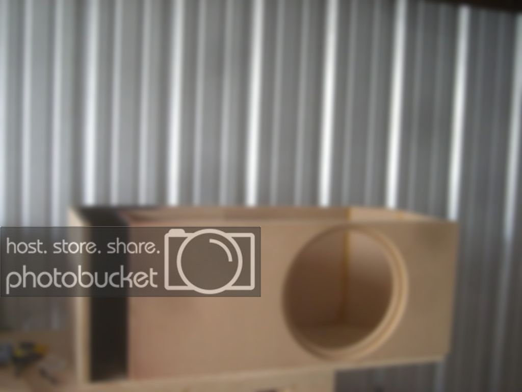

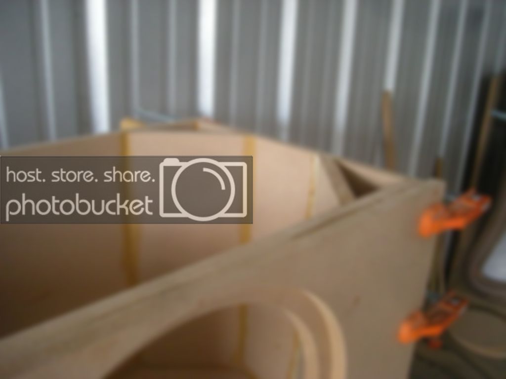

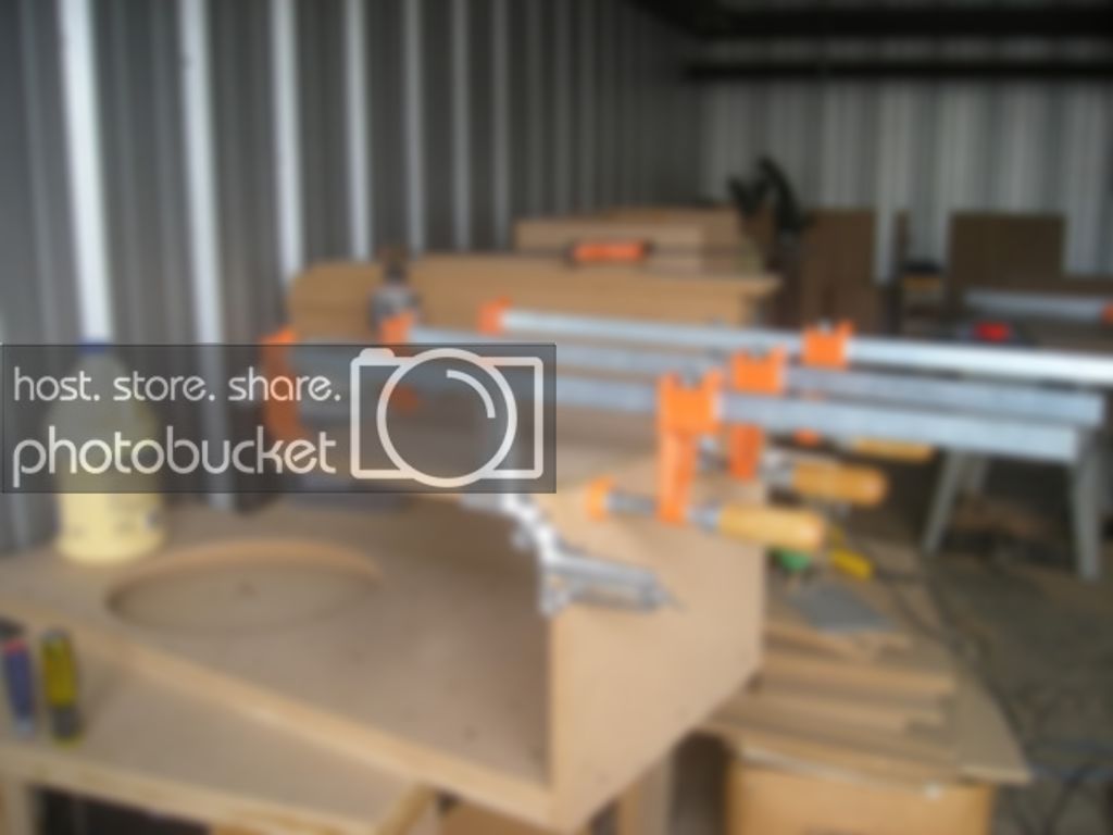

Enclosure build for Koon's single 15"

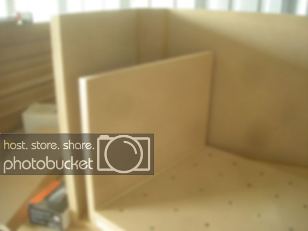

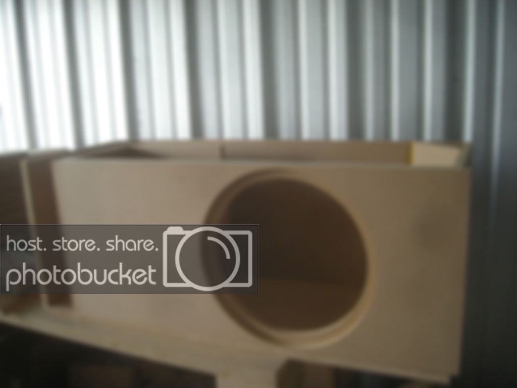

Moar..

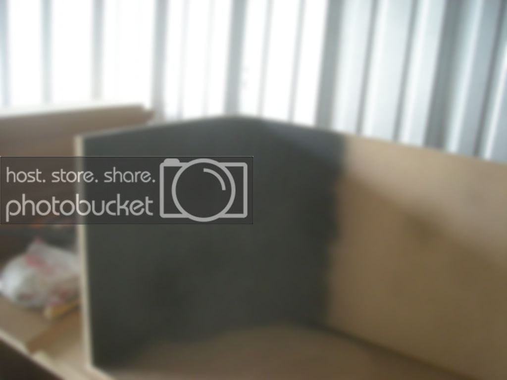

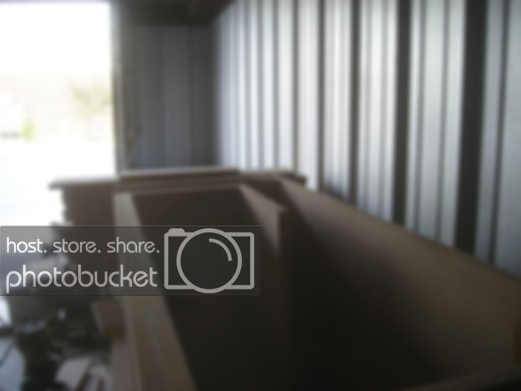

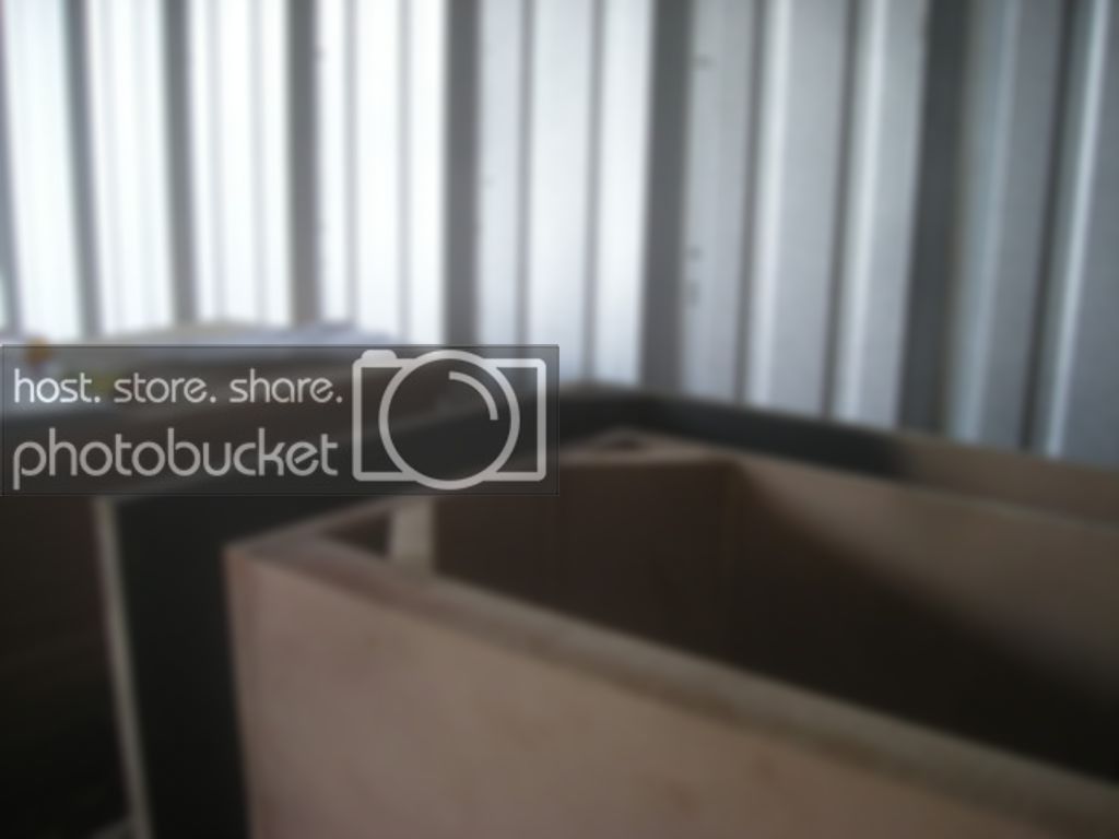

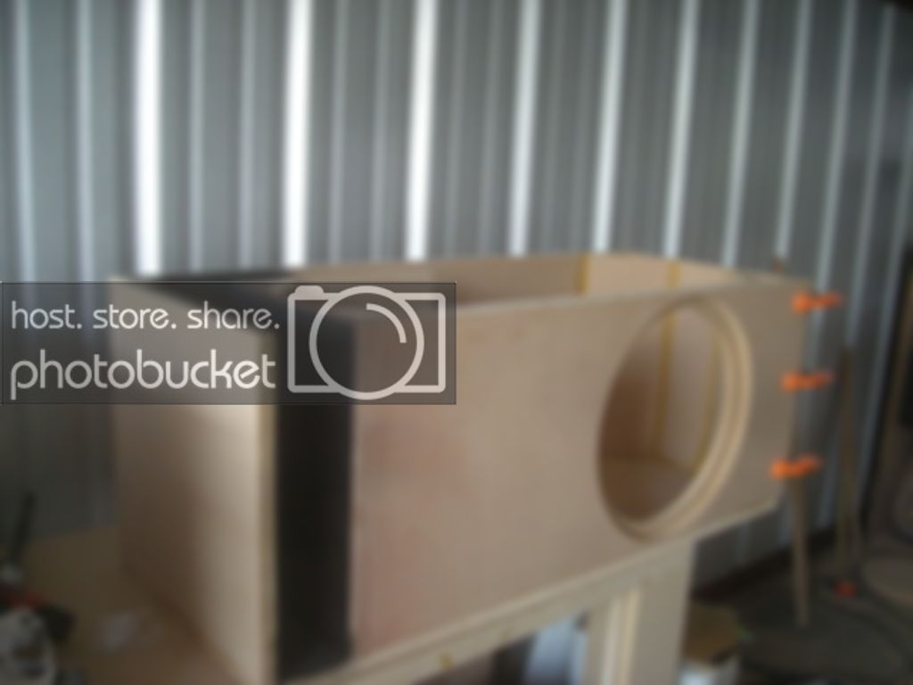

Port pieces going on the face..

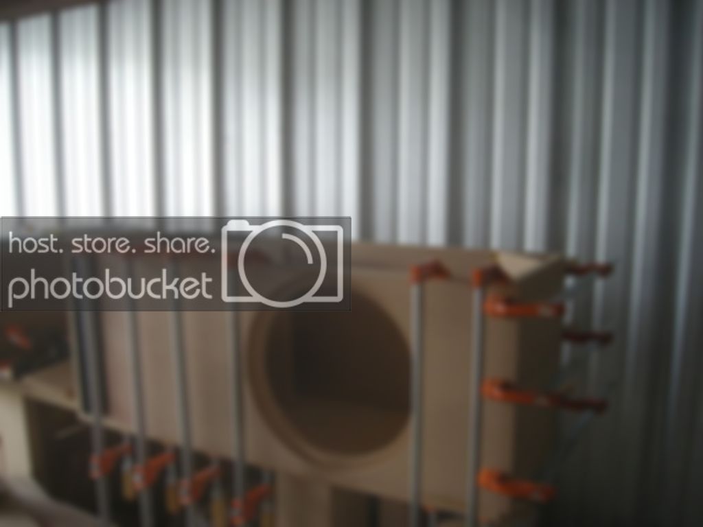

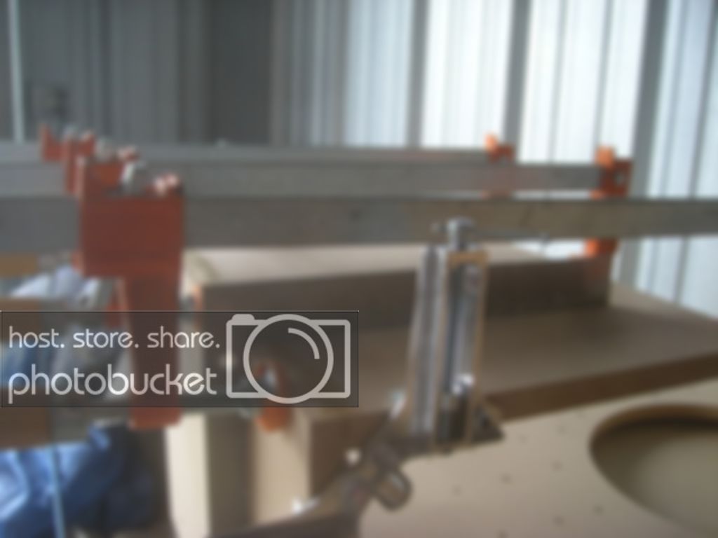

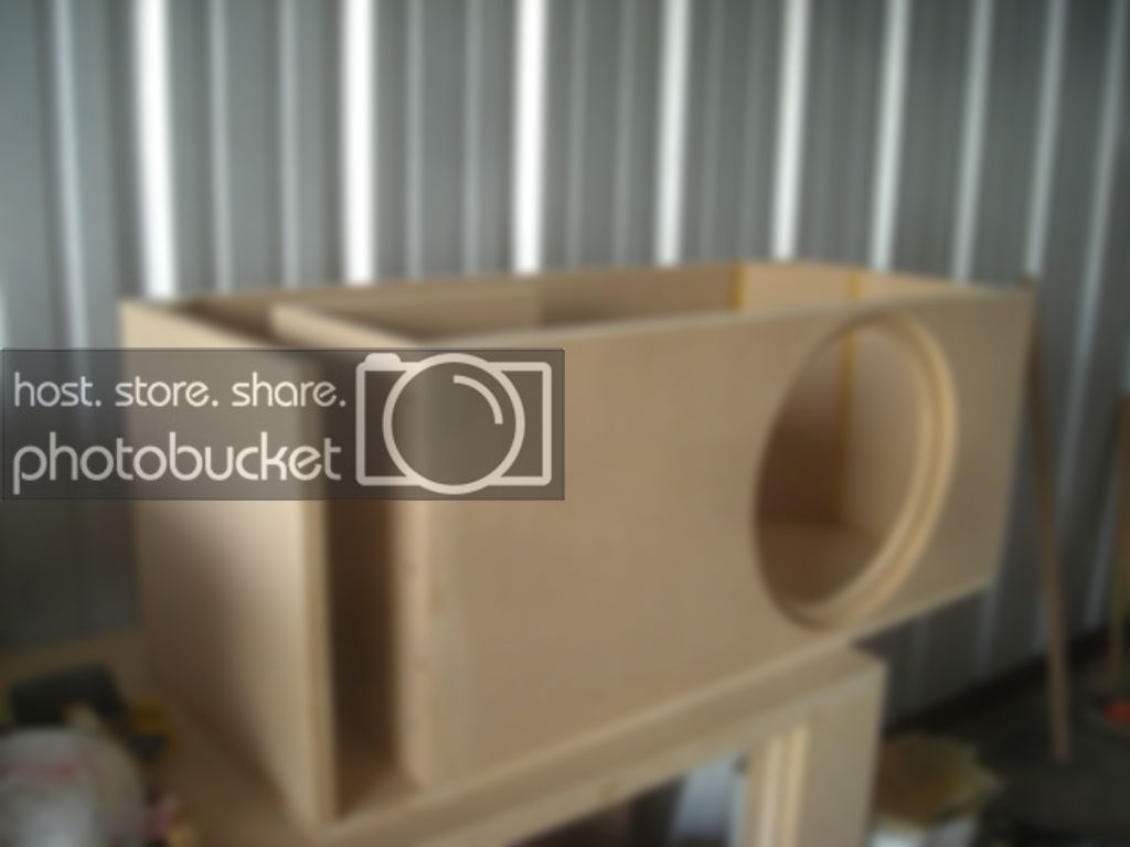

Quick look at it..

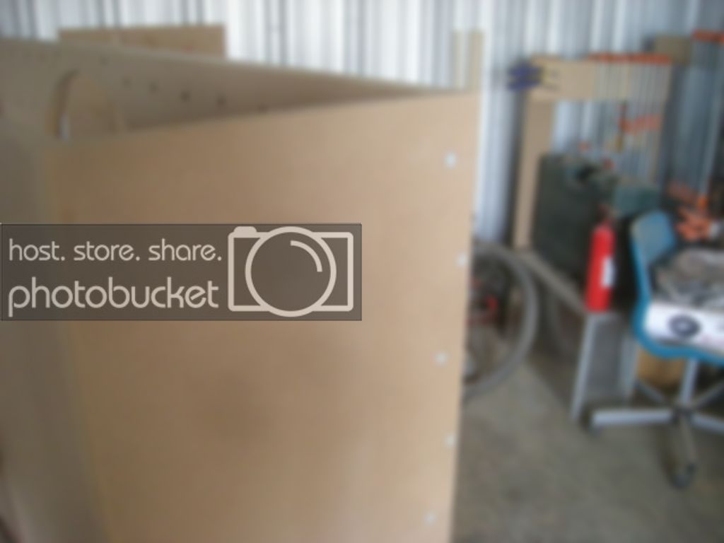

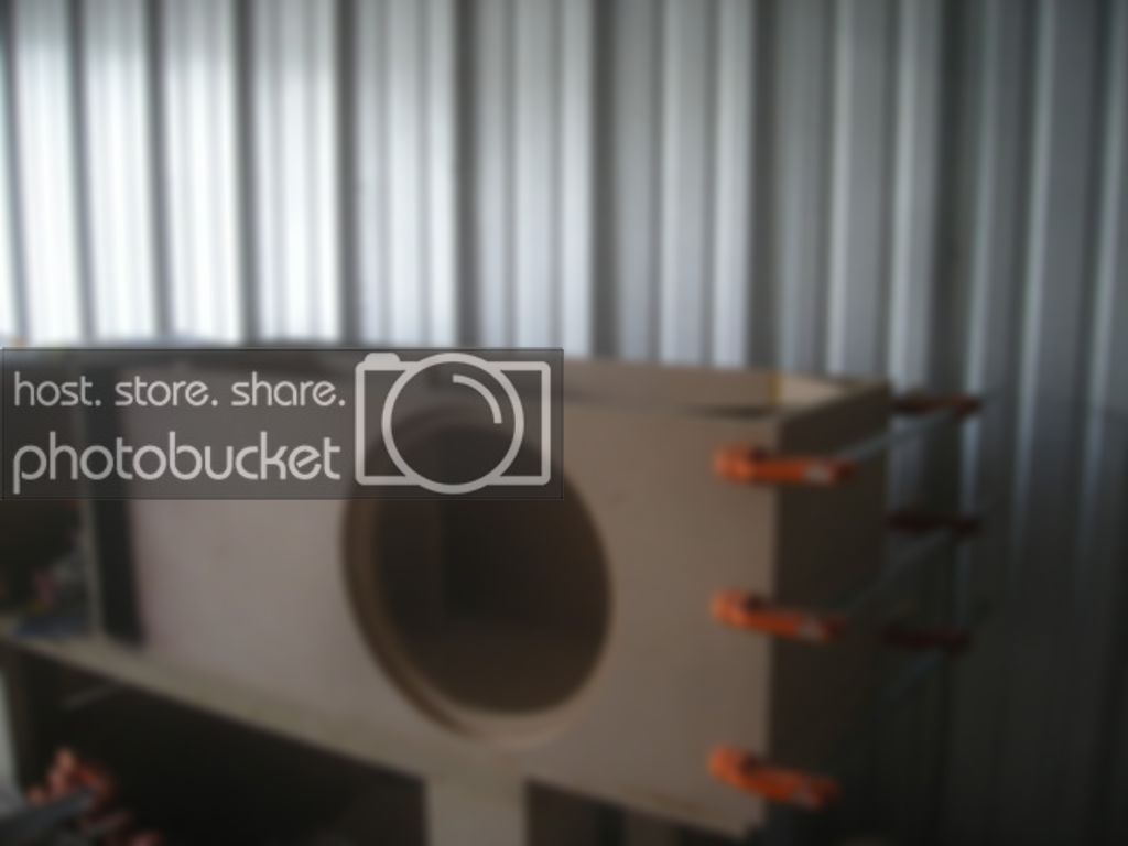

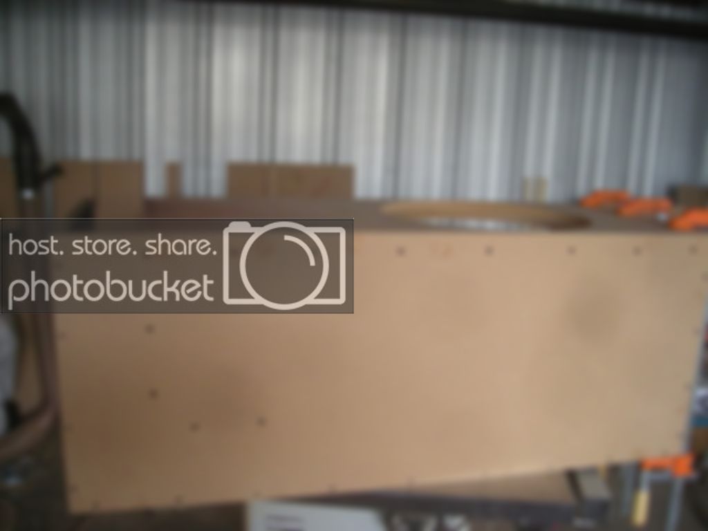

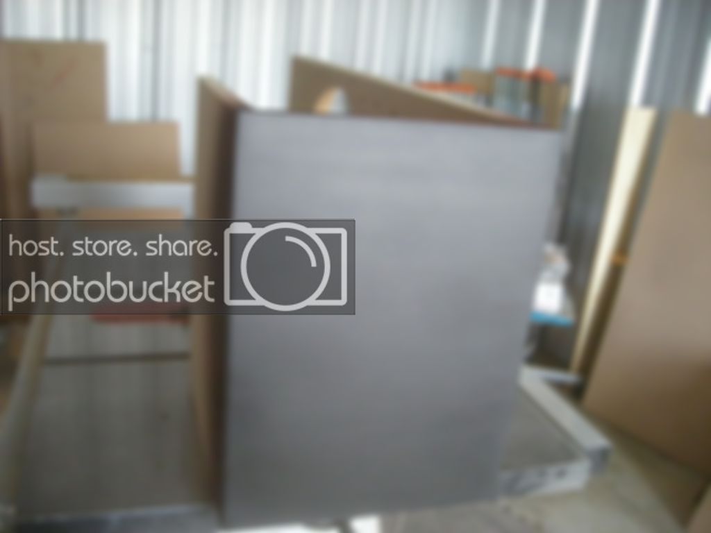

Filling in screw holes..

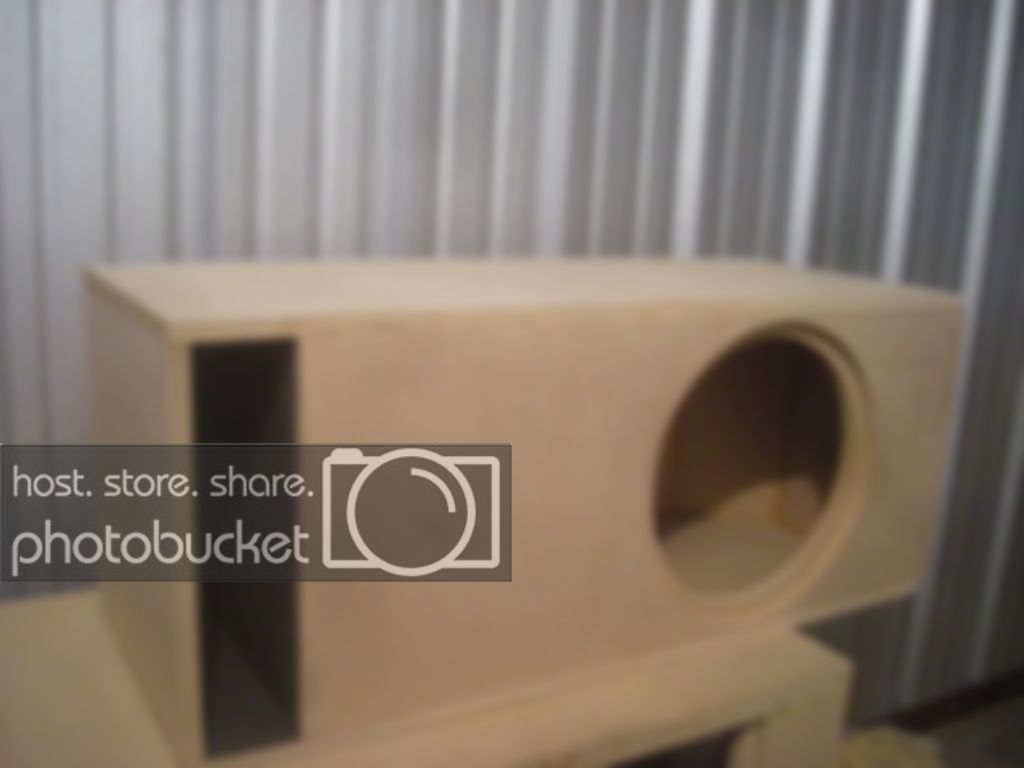

Sanded down..
good as alwayS:) nice saturn

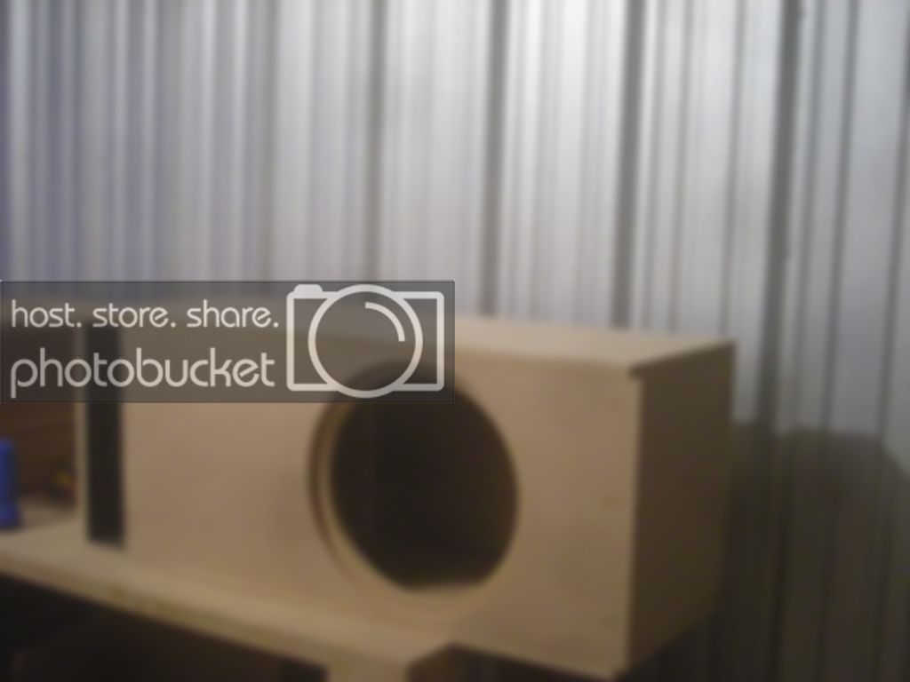

Out of curiosity, other the the port, how do you decide how big to make your 45's?
nG
The ones other than the port corner I use to take up the uneeded space when designing the enclosure and to add some support...I really just start crunching numbers for the specs and see that it's a bit larger than I wanted and tuned a bit lower than I wanted so adding support helps me out there, I then just do the math for about how much I need to lose to get 'X'...and guestimate sizes until it all works out.

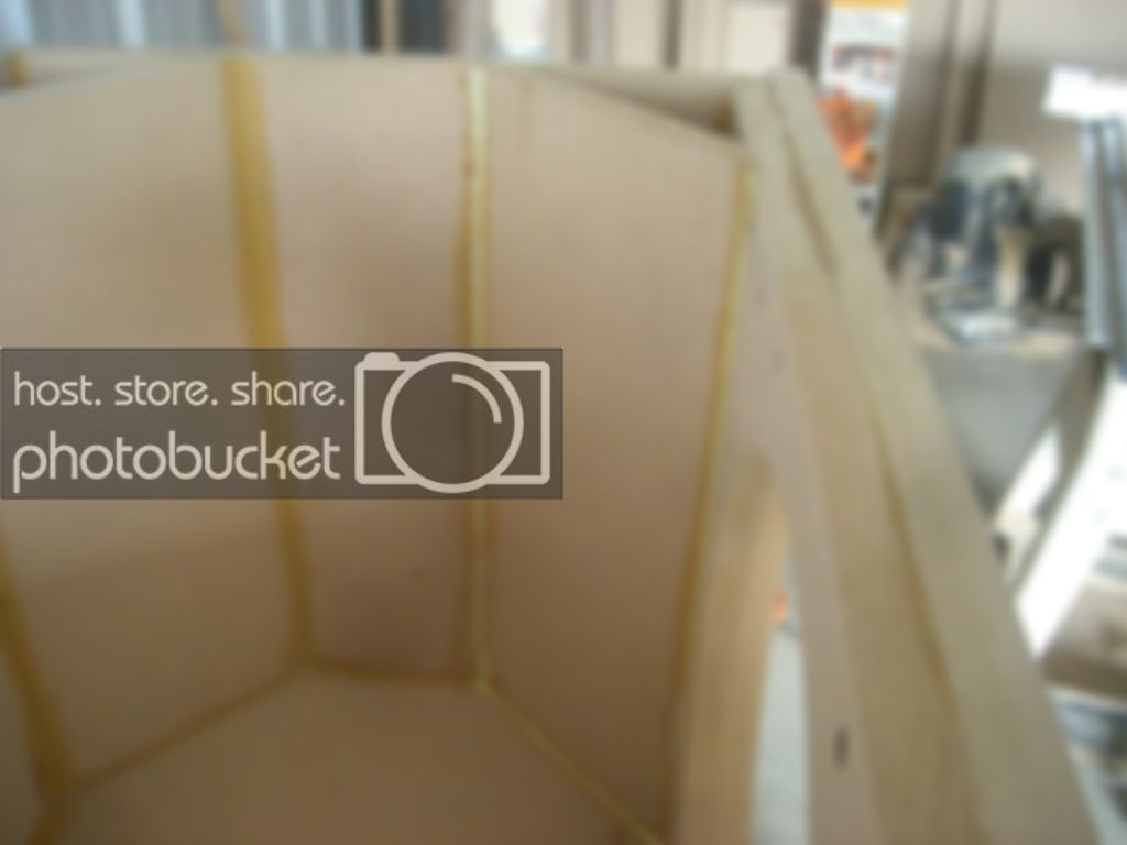

Got the top put on today and it cleaned up a little...need to clean it up more tomorrow and then the suede can begin..
And again, the overhang will get taken care of as well.
Werd, I end up making mine quite a bit smaller... so I was just wondering. Then again I'm usually trying to squeeze every cubic inch I can... //content.invisioncic.com/y282845/emoticons/wink.gif.608e3ea05f1a9f98611af0861652f8fb.gif
