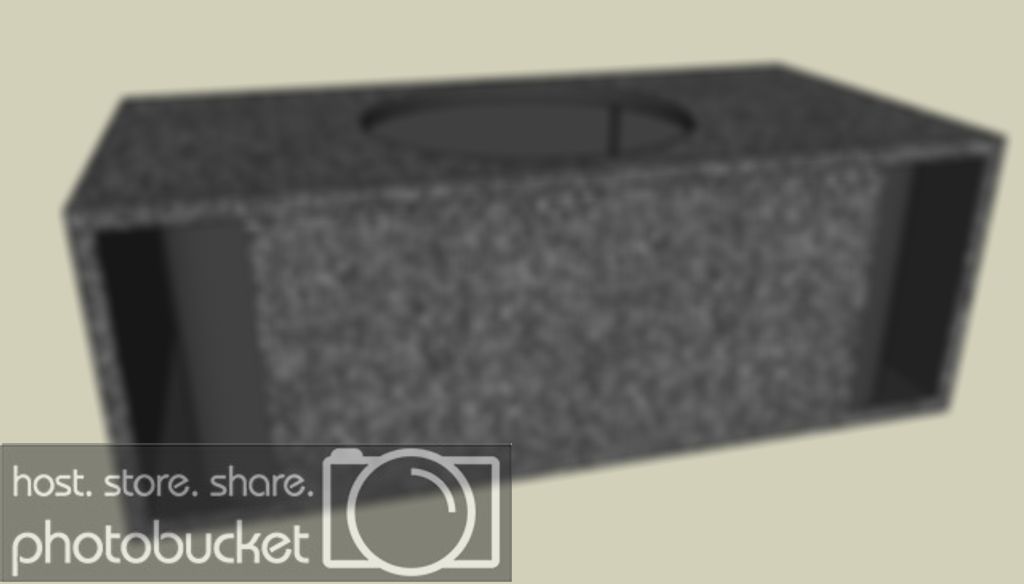

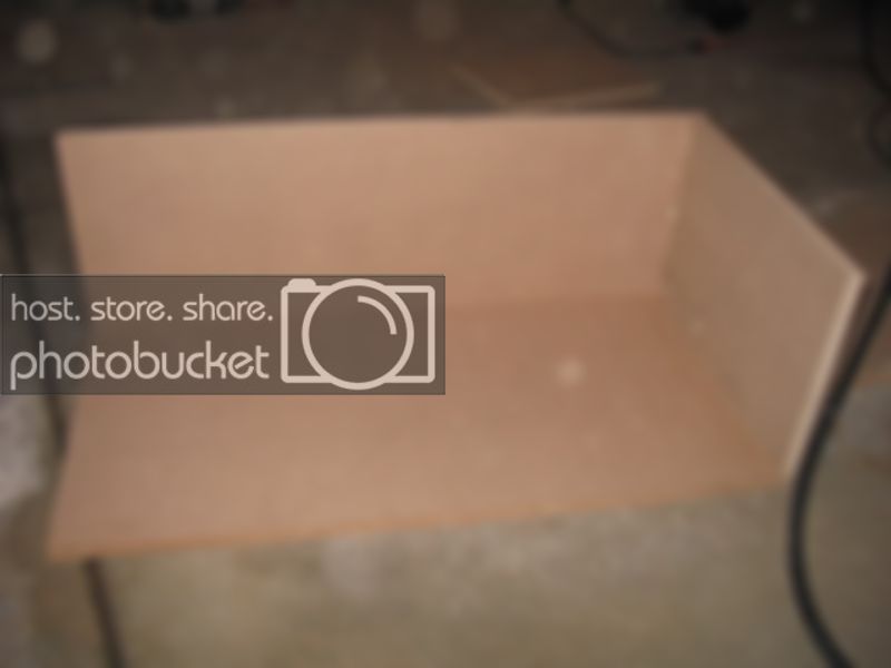

OK so this box will be for either a 12 ssa icon or 12 fi q. if he ever makes up his mind:verymad://content.invisioncic.com/y282845/emoticons/laugh.gif.48439b2acf2cfca21620f01e7f77d1e4.gif but it is 2.5 cubic feet tuned to 33hz. it will have 2 flared ports:crazy:

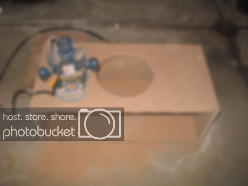

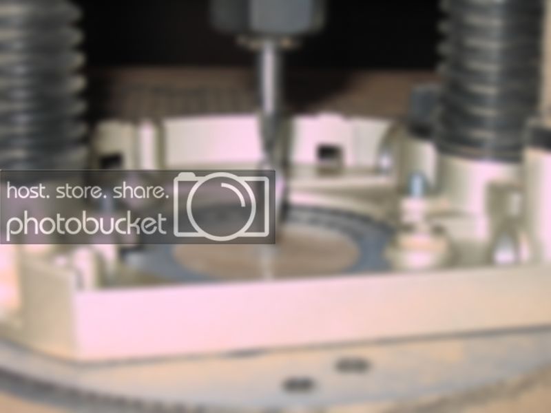

my new jasper jig plus spiral upcut bit

loookin goood ... becareful with that bit i have the same one... make 3-4 passes with it to cut a hole and it will last a long time ..... where be the ports?
Dang I almost want to make a new box, the dual side ports looks good and my dad just got a router for Christmas so I could use that on this build //content.invisioncic.com/y282845/emoticons/smile.gif.1ebc41e1811405b213edfc4622c41e27.gif

A little more background on the box and what car its going in.
As Twisted already said, its ~2.5 cubes tuned to 33hz with twin ports.
The outside dimensions will be:
34"w
17"d
13"h
It will be wrapped in black carpet, the ports are going to be painted black with bedliner. I'd like to cut a 12"x8" piece of lexan to put on the front and add another terminal so I could put a neon light in there to make the sub glow.
Its going in the back of a 2008 scion TC. Thats about the most I could squeeze out of my little trunk. Still one 12 should be plenty loud in a hatchback //content.invisioncic.com/y282845/emoticons/biggrin.gif.d71a5d36fcbab170f2364c9f2e3946cb.gif
