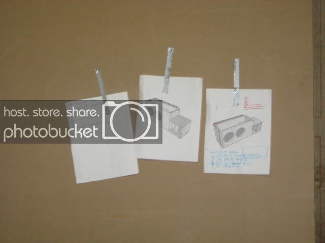

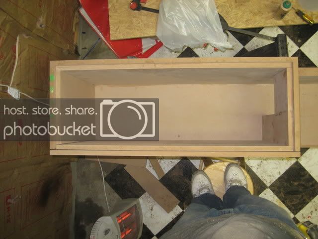

Hey everybody this is my first build log so bare with me. I Decided to make a new box for this season. I am running two Fi BL 12" fully loaded with 2000 watts apiece. the new box is 3.84596 cubes with subs tuned to 35.6Hz with 75.9 cubic inches of port. This is only the second box I have built so we'll she how this turns out. I just started last week. here are some pics of what i got.
sad to say but there is no way i will have this done by the comp next weekend. As for the amps, there is going to be an amp rack on top of the port.

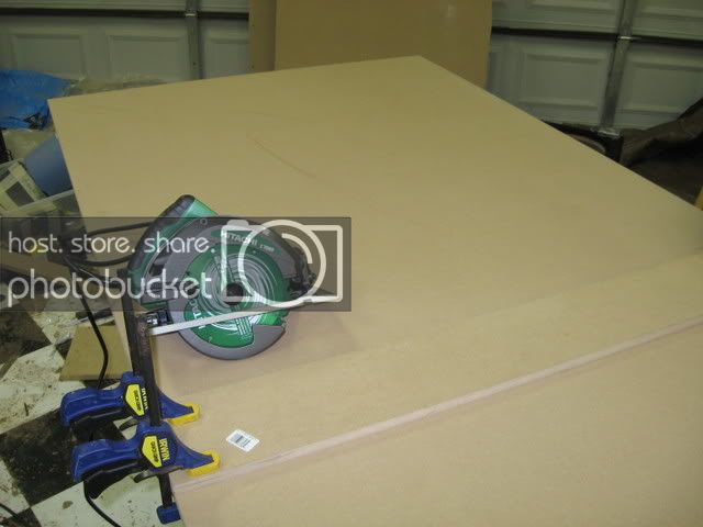

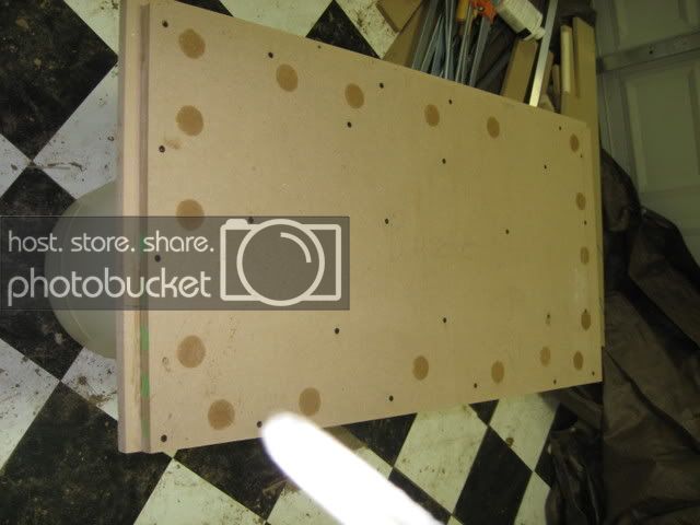

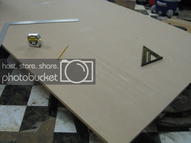

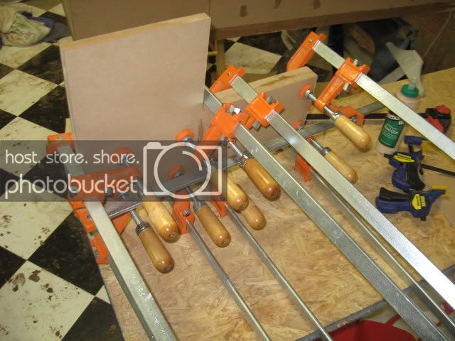

Ok over the last couple of days i got some work done. Got all the sides cut and started glueing

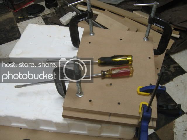

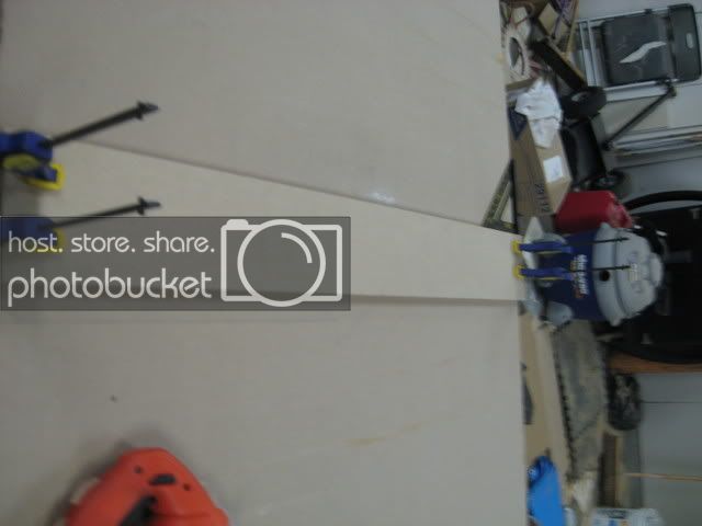

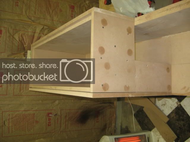

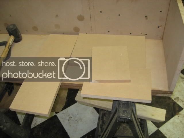

I fitted both sides and front plates before i started gluing

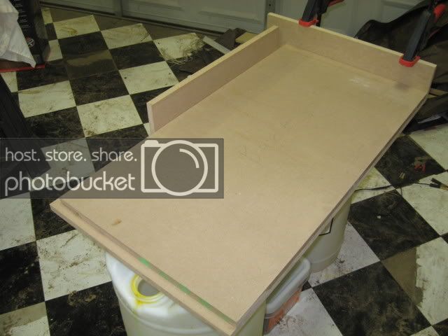

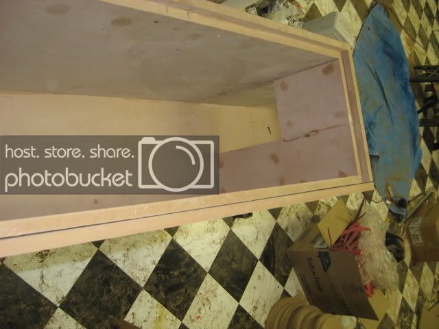

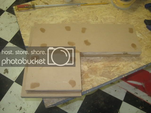

Started with the wall that has the port on it(had to make it out of 4 different pieces)

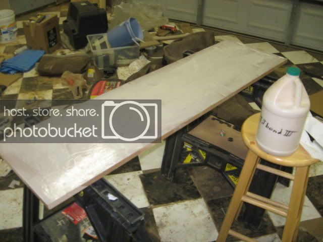

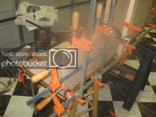

took a couple stages to get it all together

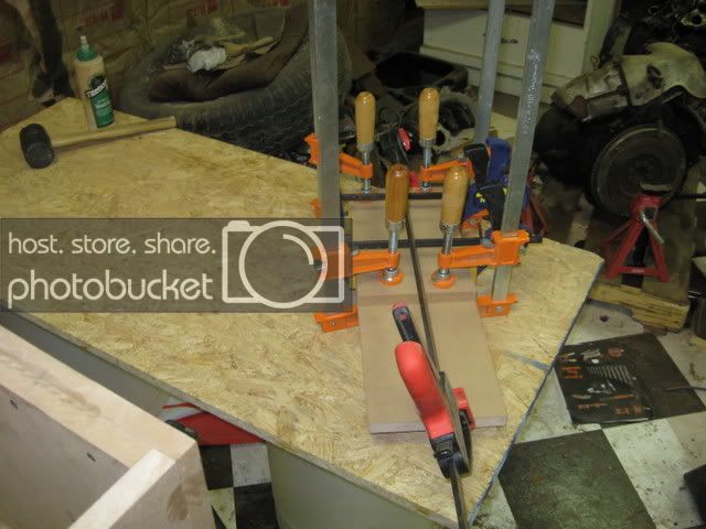

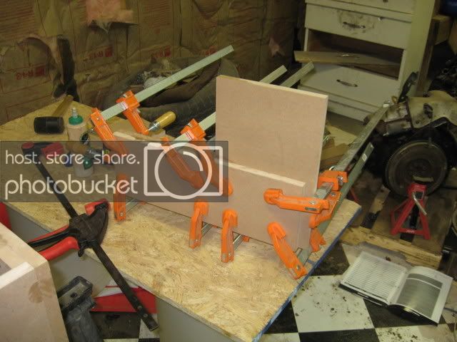

Lined up the other side for gluing

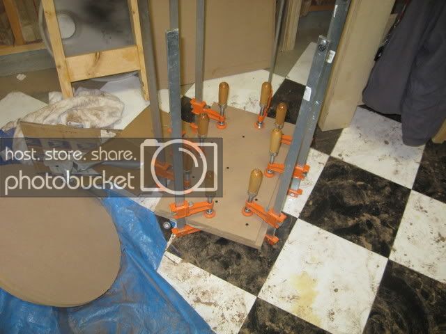

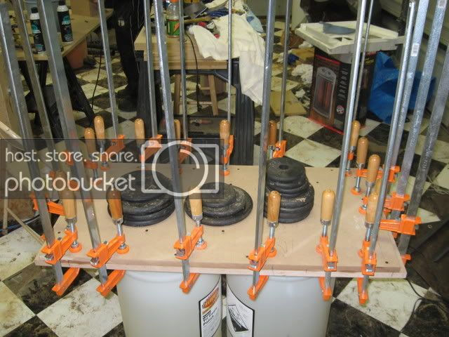

got it nice and tight with some screws and clamps

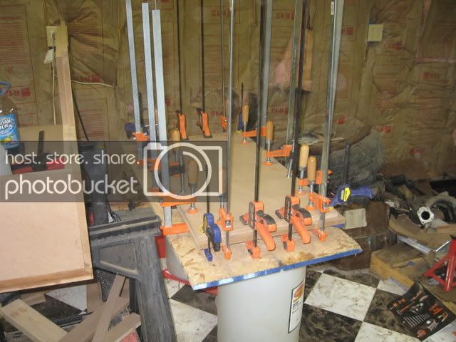

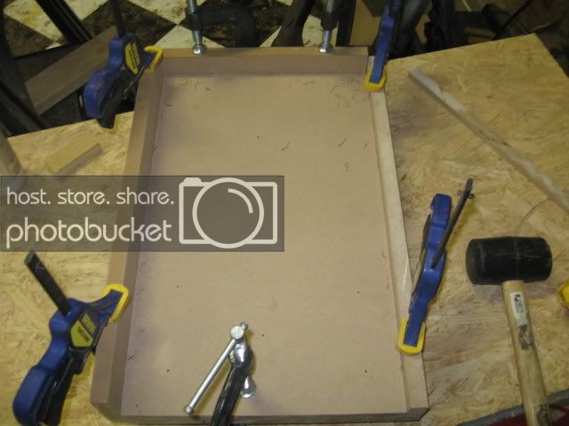

did the same with the face plate
I hope in the next two days to get my cutouts done and the sides glued:D
