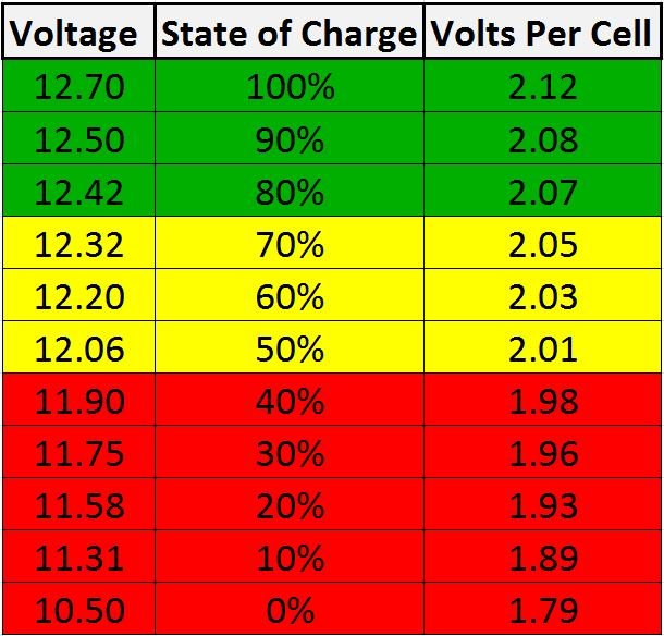

State of charge with vehicle turned off:
That's aka resting voltage. Really doesn't imply if the vehicle is running which should be right around 14.4
Have bought a few batteries new that had resting voltage of about 12.8 before swapping within my vehicle so that's good number. Any idea how often they're charged sitting on the shelf?
12.8 is perfect resting and 13.8-14.4V is the charging voltage recommended with the vehicle running. I think you may of misunderstood what I was trying to say. I'll try to clarify better.

While I find it hard to believe he was able to get the charging system down that low, in the unlikely event that he did, I wanted him to understand the amount strain that he was putting on the electrical system and that a resting 10.5V was 0% charge. Hopefully, If he understood a resting 10.5V was 0% he would understand how bad it was for his car if he was running it down into 9V while running. (I can only imagine how happy his alts rectifier was!) I recommended to NOT shut off the truck right after doing something like that (if he did it again) as his car battery would effectively be dry and he would be unable to start it again without a jump.That is beyond any other potential long term damage that it may do to his alternator or other systems on the car.
