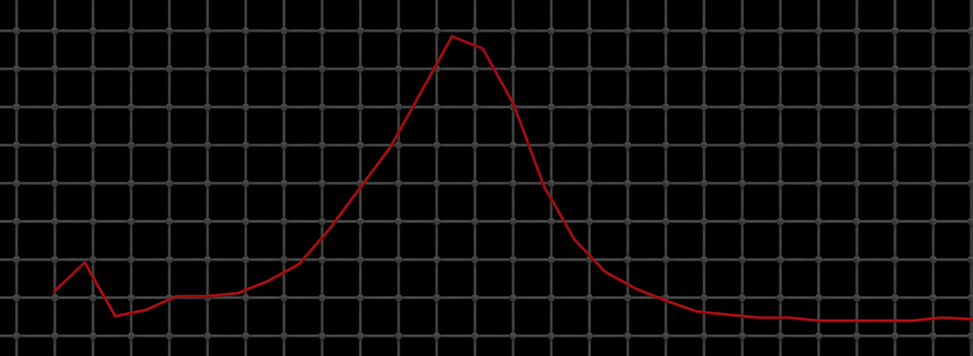

box rise refers to the impedance of the sub due to the inherent nature of operation at various frequencies in a particular box.
If you have a 2 ohm sub the actual impedance as "seen" by the amp will rarely, if ever be 2 ohms.
I pulled up an impedance plot for an RF P3 at 2 ohms -- in an average size sealed box it peaks at 14.5 ohms at 42 hz, and is above 4 ohms from ~25-55hz.
Ported runs a little lower, but is only close to 2 ohms at 30 and 70 hz.
