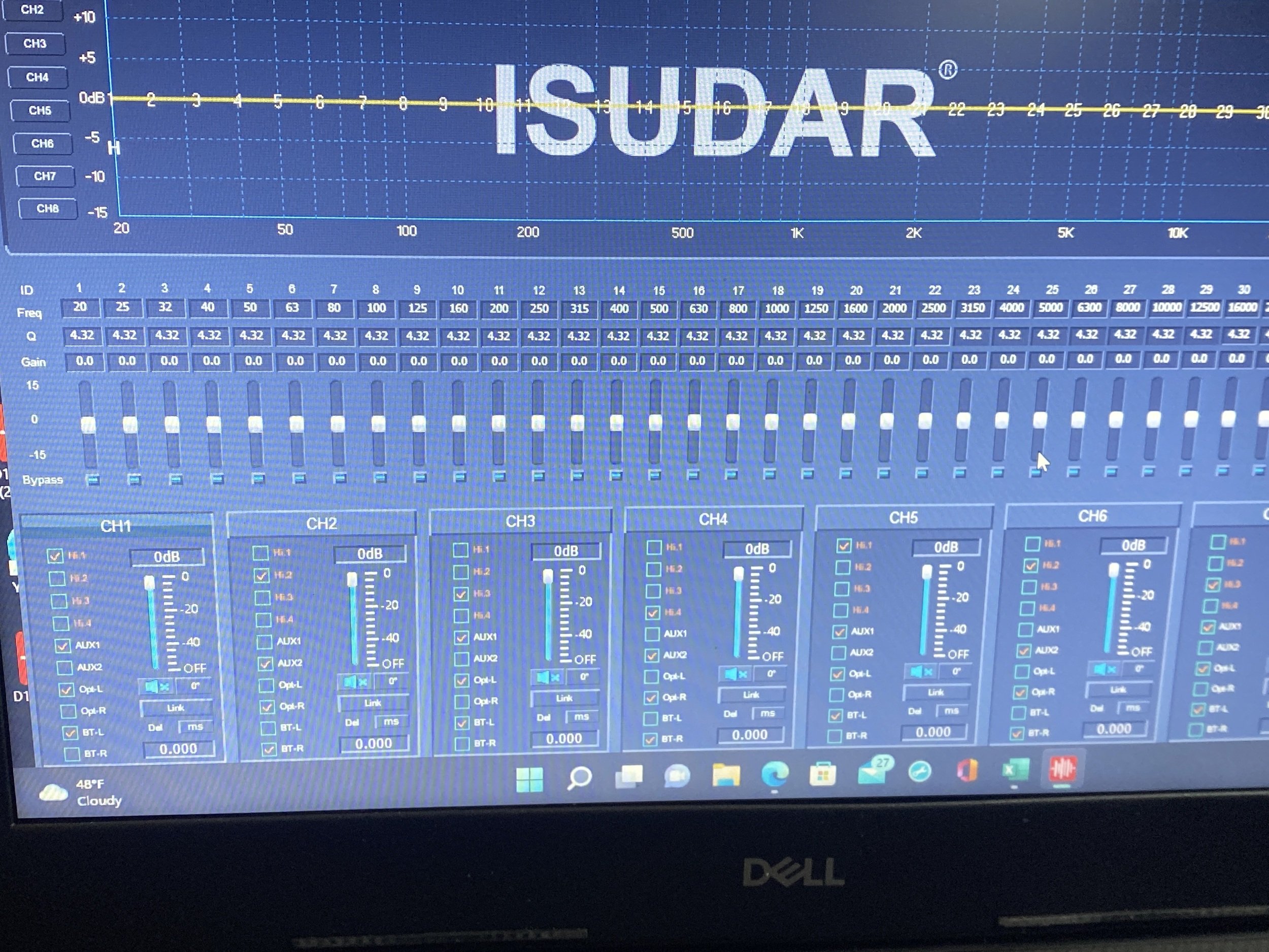

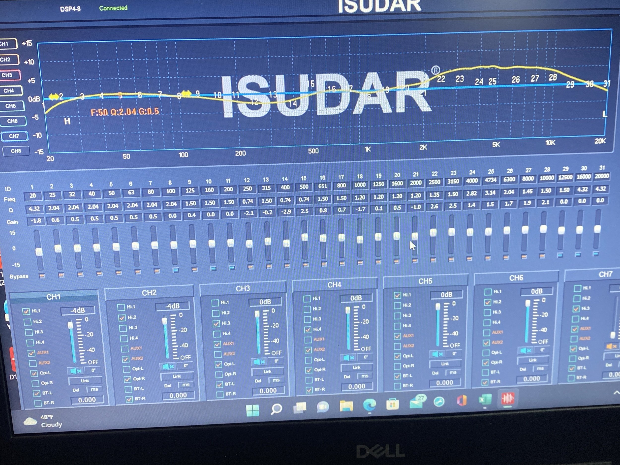

Hey i have a dsp and im curious i know very little about q factor.i have a sundown u15 on 1700 watts rms.
What should i set qfactor at say 20-100 hz.i have it at 1 right now but i dont have a clue where it should be set.i had it at .74 but sounded like floppy butthole.
Any experienced users got a number where i should prob set it at to help me out alittle.thanks

This is factory default settings for the q
It looks like 4.32 is the factory Q setting. If you are finding that when boosting in the 100hz range for the subwoofer is making your midbass speakers have too much bass, lower the Q at 100hz to 4.00, if it still is too much, 3.50 and so on until it isn't affecting the midbass so much. Does this make sense how it can be used?
