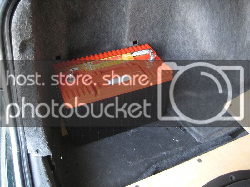

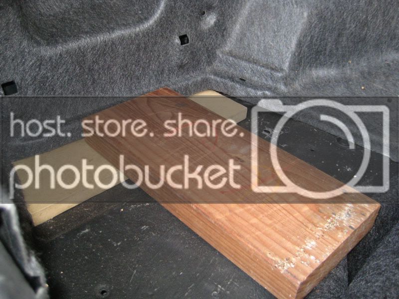

Started doing some more planning. Here is where the battery will go. As you can see it is uneven.
To solve this, I found a scrap piece of 3/4" MDF and it did the trick. It's pretty even. There is a block of wood for comparison.
Here is how the battery will be placed. I will be making a box for it and bolt it to the chassis.

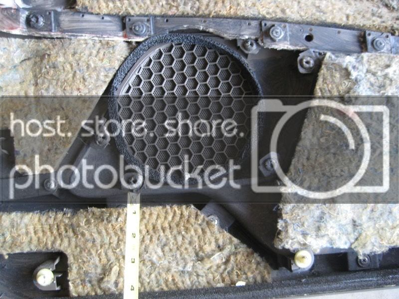

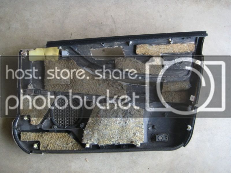

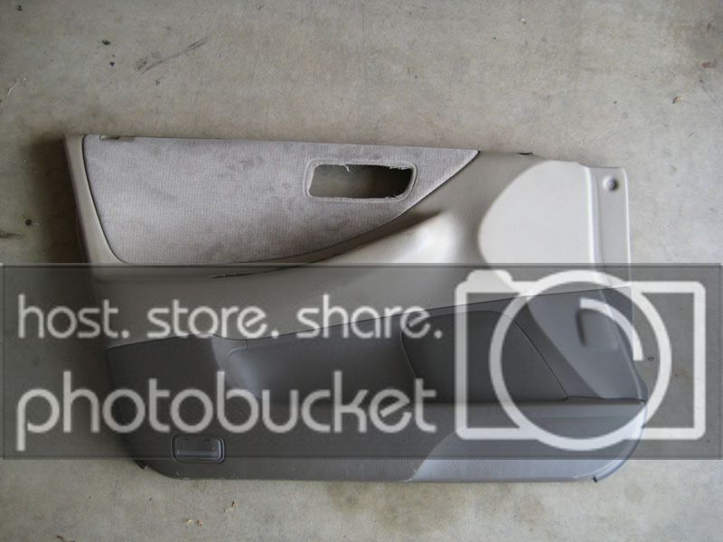

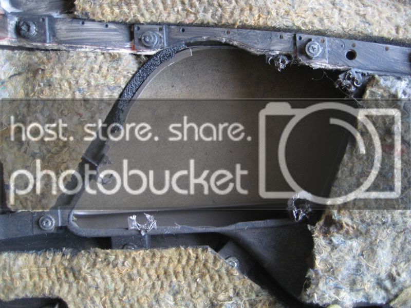

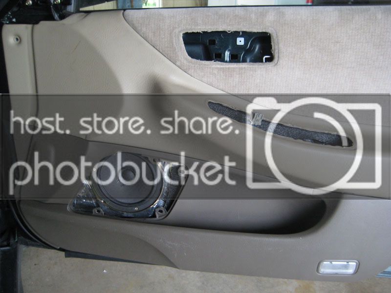

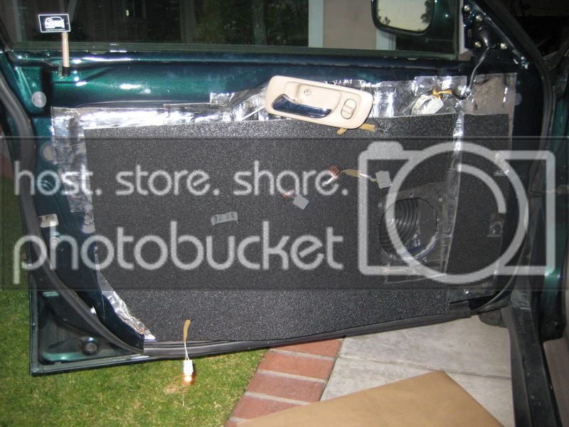

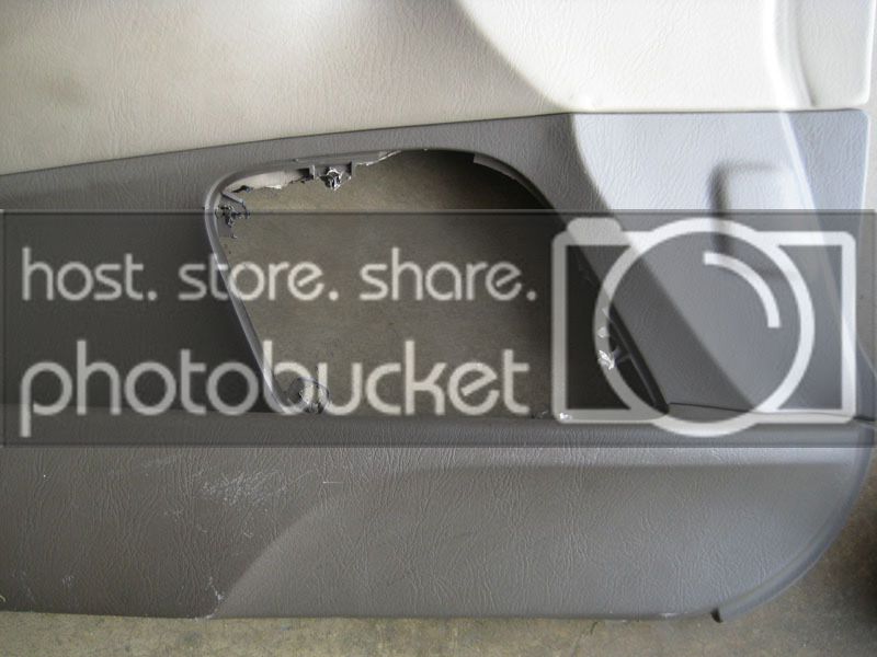

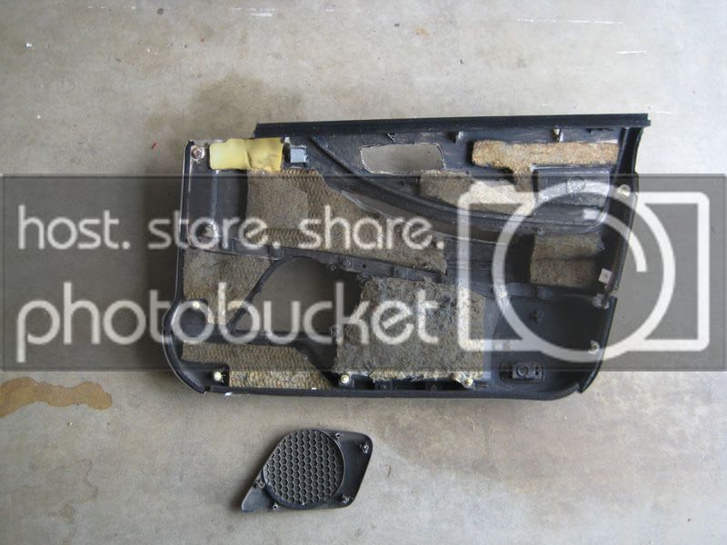

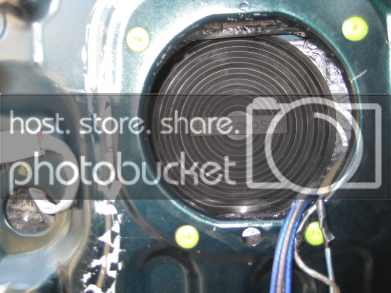

Onto the doors. I will need to use 3/4" and possibly 1" baffles instead of the 1/2" baffles that are currently installed once I get the Zapco's in and the speaker will be pushing up against the grill so I have to take them off. I wish it were clips that were holding them in place, but the clips were actually melted, thanks Honda (bastards). I used a hot razor blade to cut them and popped them off with a screwdriver. Some pics as shown below.
The tape measure shows the melted clips.
Continued from above.
I'll be needing to make a custom grill, though I'm not quite too sure how to go about that, so any suggestions would be great. Here's how it looks with the P.O.S. stock mid.

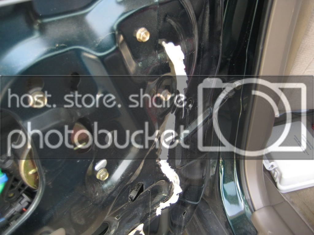

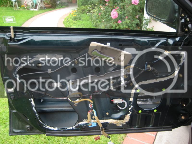

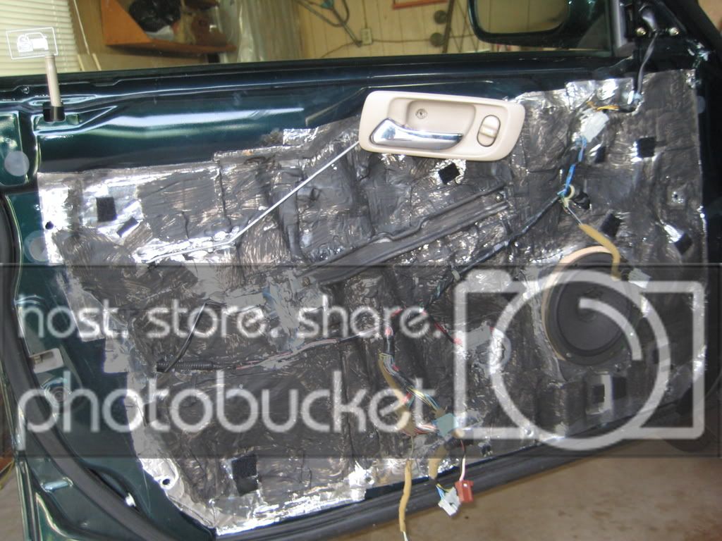

I'll start with the doors. I have a picture somewhere of how the factory door looks without the panel. There was a plastic sheet covering the door so I took that off and also took off some of the tacky dough, or whatever was used on the door to keep the plastic in place.
One layer of Damplifier on the inner door.
One layer of Ultra Kill over the Damplifier.
Speaker tweaker pad over the Damplifier.
One layer of Damplifier on outer portion of the door.
One layer of Rattle Pad over the Damplifier. It looks a bit different now since I had issues of the door panel clips staying on. I also used velcro to keep the Rattle Pad in place.

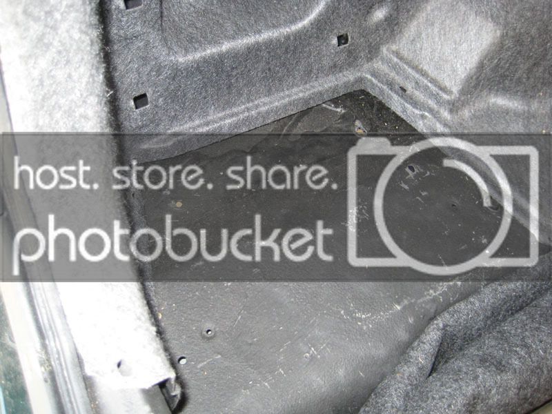

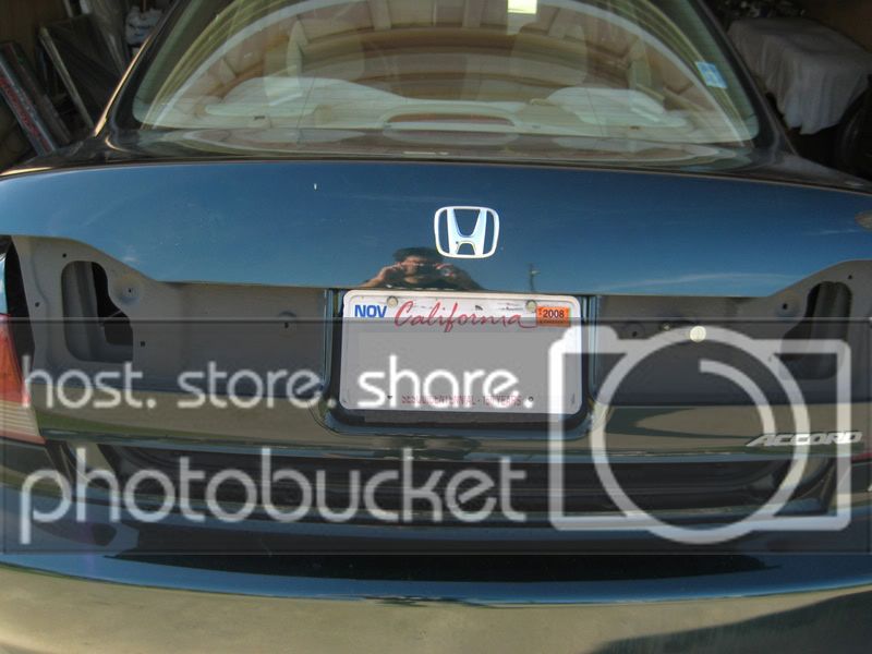

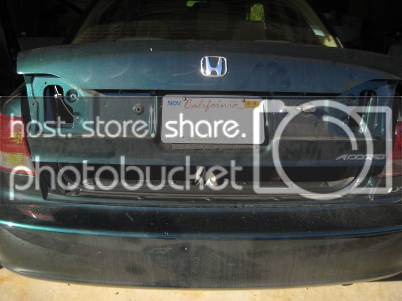

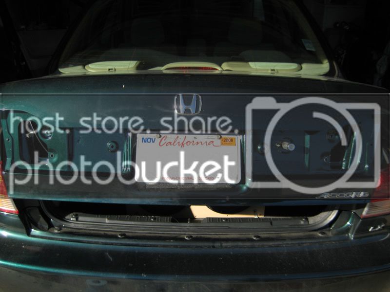

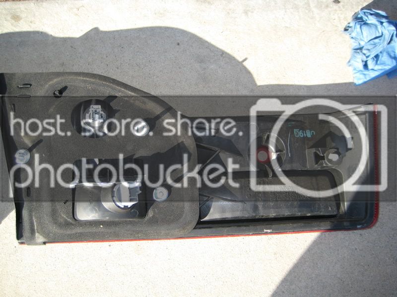

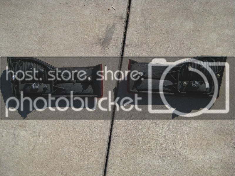

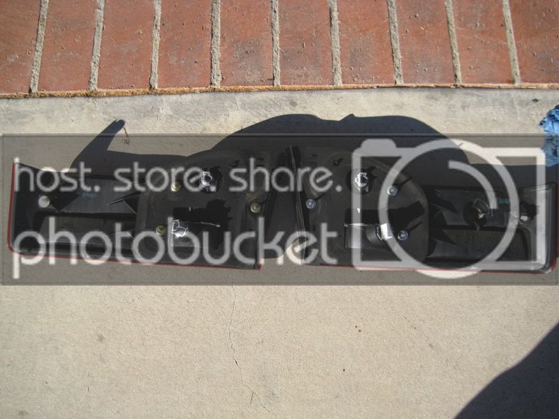

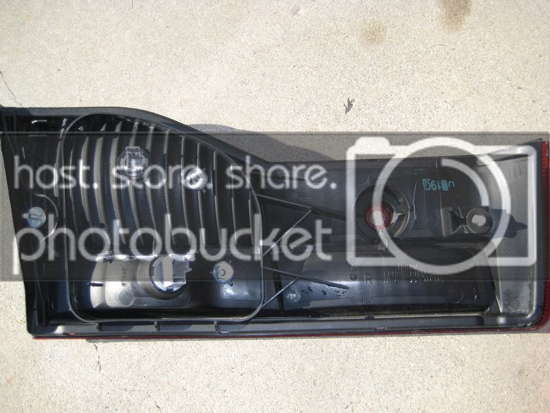

Onto part of the trunk and the trunk lights. Here is a before picture, quite dirty as you can see.
Cleaned it up a little bit.
Applied Spectrum.

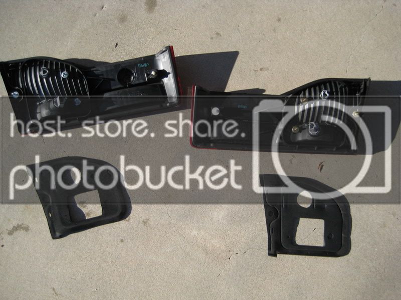

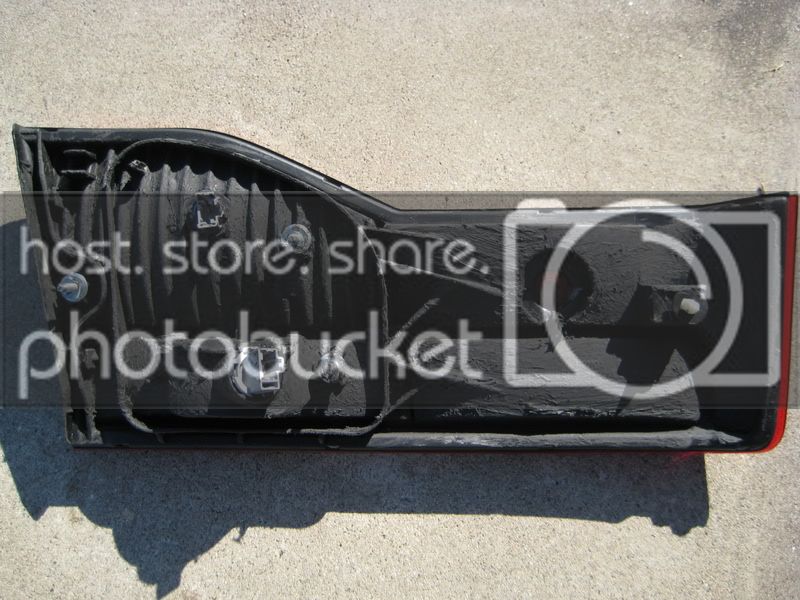

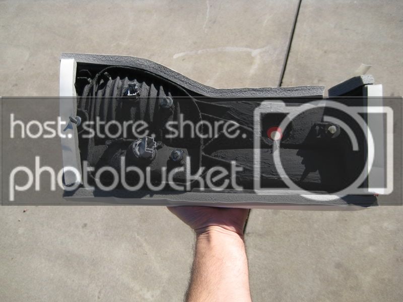

I added some 3/4" foam tape, but I'm going to replace it since it makes the lights stick out a tiny bit, just a few mm. I might use some Ultra Kill or Rattle Pad or even strips of Damplifier.

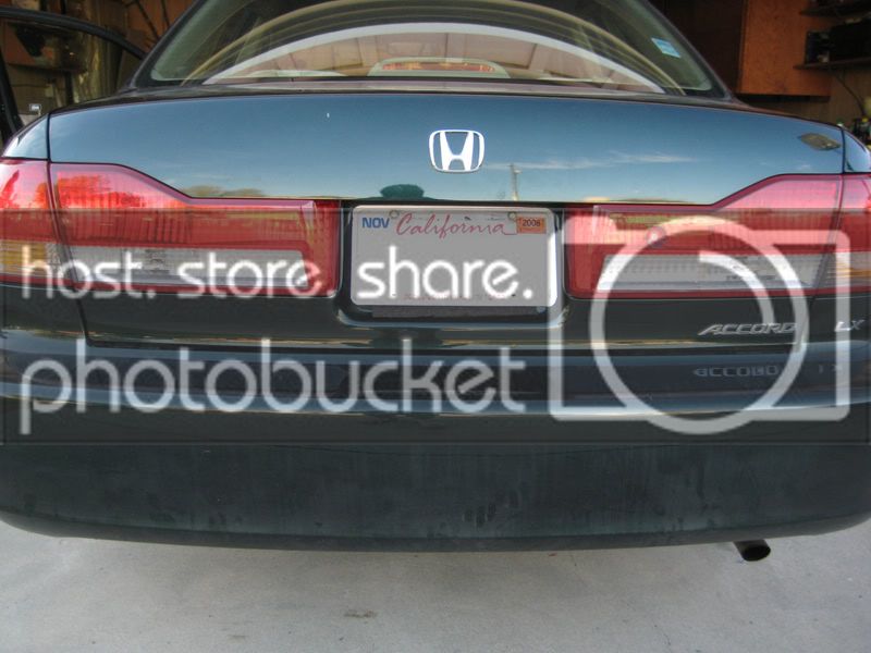

Completed picture, looks like nothing was done //content.invisioncic.com/y282845/emoticons/smile.gif.1ebc41e1811405b213edfc4622c41e27.gif
Also, now that I have the time and I have nearly a full gallon of spectrum leftover, along with putting more of it on the rear deck, trunk lid, and such, I will put a couple layers on the front doors and maybe a layer or two on the rear doors. Rear doors don't have any deadener, but they could be deadened to reduce some road noise. I think I will also order another 20 sq. ft. of Damplifier and some Rattle Pad or Ultra Kill.
I messed up putting that foam tape behind the lights. I thought it would help, and it does slightly, but as mentioned it pushes the lights out by a good half inch. I will use some rattle pad or ultra kill for that, not sure which to use or maybe there is another solution, gonna ask Ant at Second Skin. If you have an Accord from the same gen, a lot rattle comes from a tiny piece on the trunk lid. I'll snap a quick picture when I get off work and upload when I get home of what I'm talking about. Basically, it's a weight so the trunk lid doesnt just close when wind is blown. With so much deadener, I don't have to worry about that, but it SIGNIFICANTLY reduced the rattles.

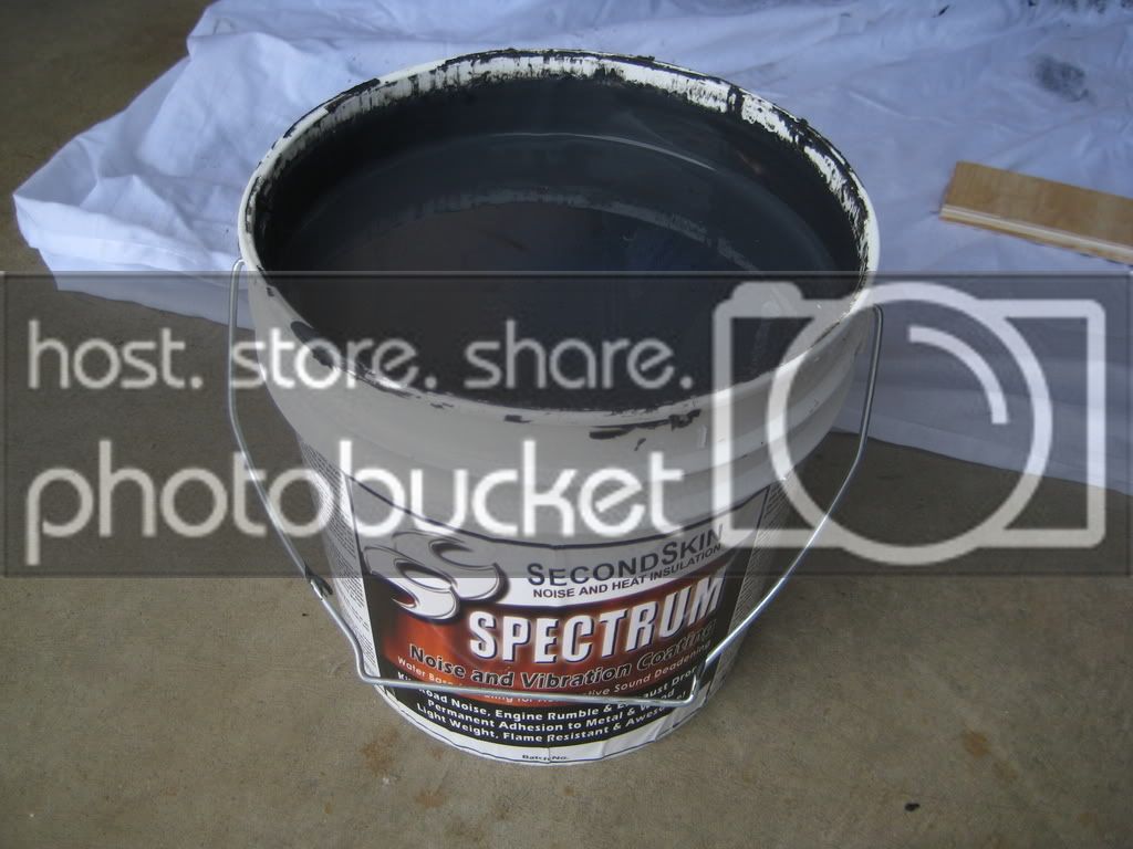

This is how much Spectrum I have left...more than I thought //content.invisioncic.com/y282845/emoticons/biggrin.gif.d71a5d36fcbab170f2364c9f2e3946cb.gif

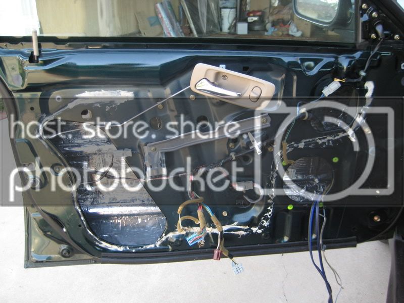

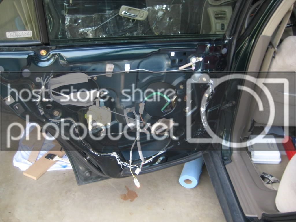

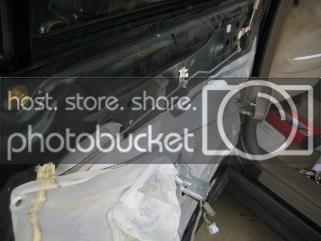

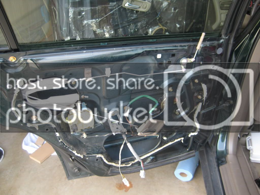

Decided to do the rear doors. Originally I had mentioned I would post a pic of what the front doors looked like, well it is exactly how this one looks.

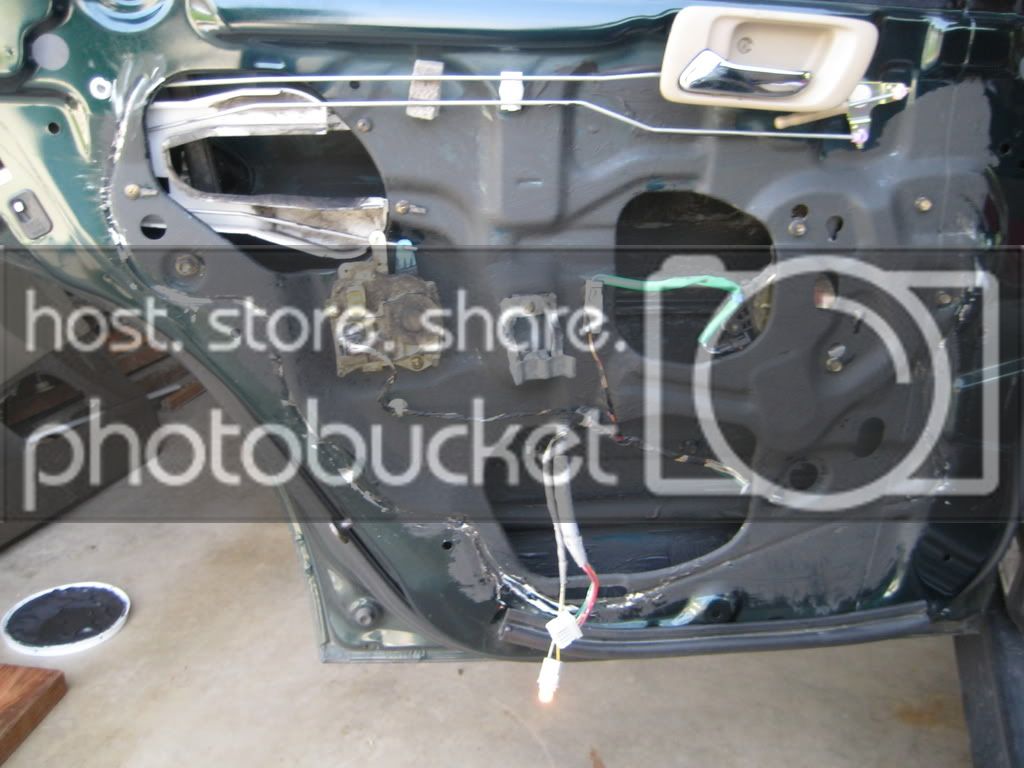

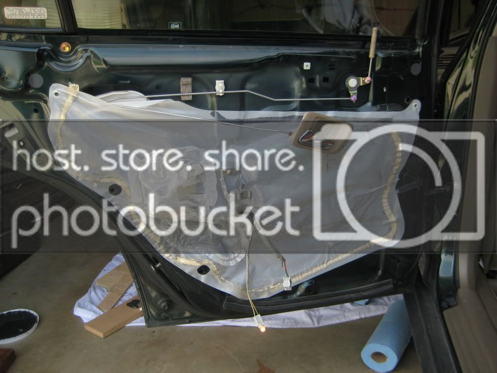

Took the plastic cover off and you can see 7 years of dirt, ew!
This is the sticky residue, kind of like a sticky dough.
Cleaned the door and took off as much of the sticky residue without spending too much time on it since it really doesn't matter.
All dried up after 1 layer
I ended up doing one more layer on the inside of the door. I noticed that it did help a little, I haven't driven the car yet, but I'm sure road noise will decrease as well.

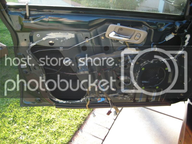

Decided to do the front door. This picture is with 1 layer of Spectrum. I did 2 layers but forgot to take a picture after the 2nd layer was on. It looks much better with the 2nd layer.
Not sure how those two layers will help, probably will elimante some road noise, maybe not, I just did it for the heck of it.

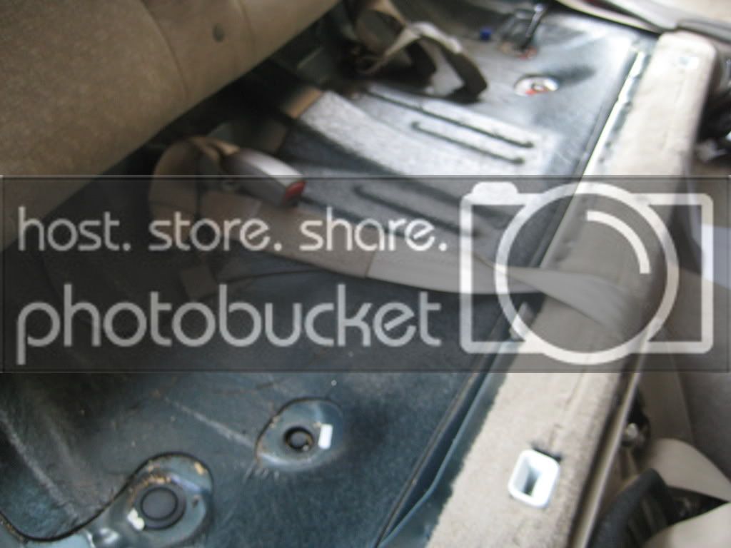

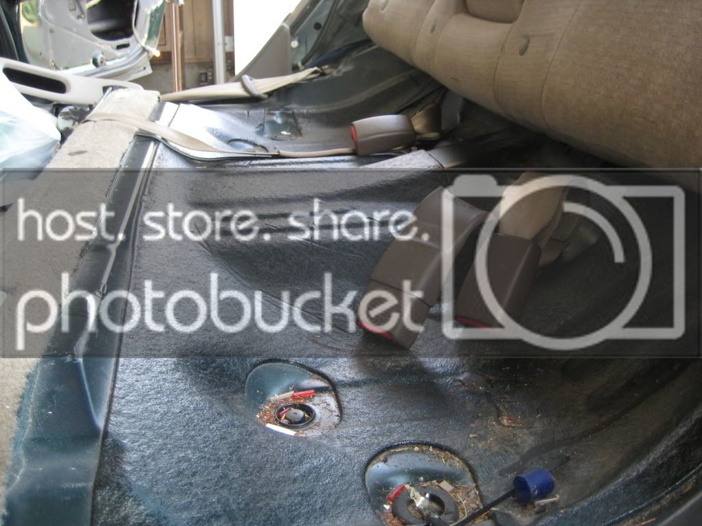

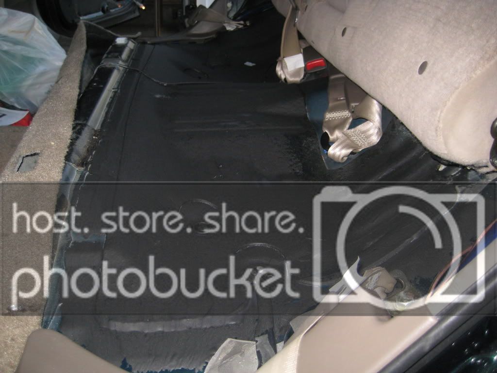

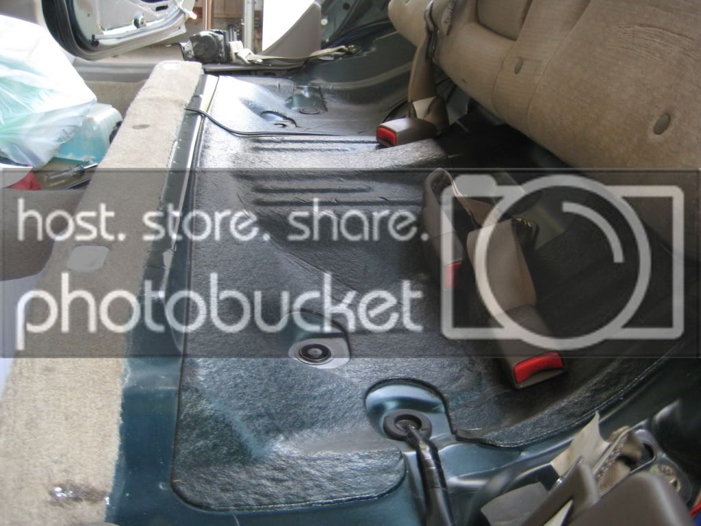

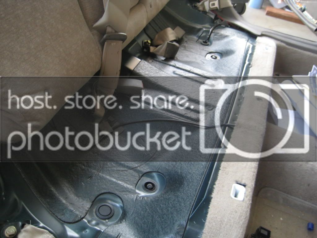

Here is underneath the rear seats, quite dirty as you can see.
Vacuumed and cleaned with a damp towel.
And one layer applied.
I might do another layer, but for now I want to save for what is more important, like the top and bottom of the rear deck, trunk lid, hood, and tire wells. If I have any leftover I will go over the bottom of the rear seats and anything else I come across. I have also put expanding foam in the rear quarter panel and it help ALOT! I do not have pictures, but once I take the panels off in the rear I will take some quick photos. I plan to put expanding foam in the C pillars sine they are pretty dense. I'm supposed to pick up the Zapco's today so hopefully they'll be there when I pick up //content.invisioncic.com/y282845/emoticons/biggrin.gif.d71a5d36fcbab170f2364c9f2e3946cb.gif. Pics of those will be up possibly tomorrow, but Sunday for sure.
Looks good man. Only thing different I would suggest is to cover the major holes in the door with a rigid material, rather than just laying mat over the hole. Its not too late, just cut some wood/sheetmetal/ABS/whatever to the proper shape, and screw it down over the layer of mat you already have in place. Slap a lil mat over the top of that, and your doors will be much stiffer and less noisy.
I thought about doing that before but passed on it, I think because I didn't want to bother with the work. I actually did buy sheet metal so I can use that. Do you think it will make a difference for the rear doors or are the front doors enough?
If the rears have speakers in them, definitely do it. If not, up to you, but I still would. Im kinda anal about such things tho. Doors are where the majority of road noise enters most vehicles, and doors tend to rattle like a *****. So I like to stiffen them as much as possible and create a good solid surface to lay mat across.
