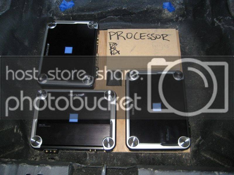

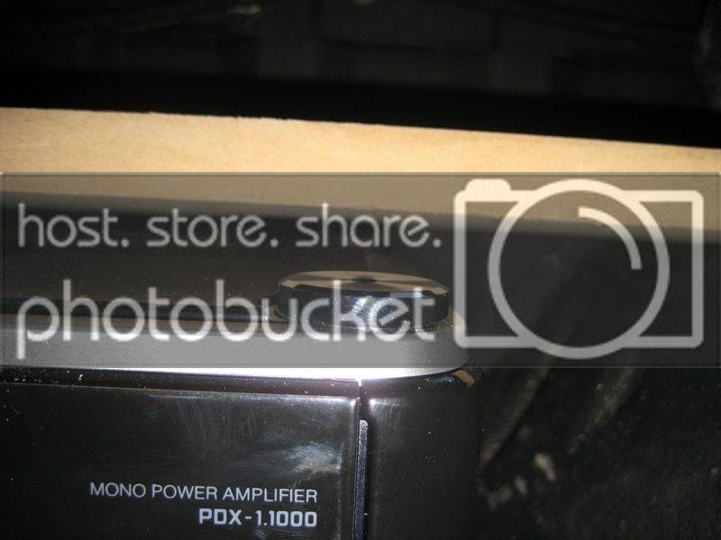

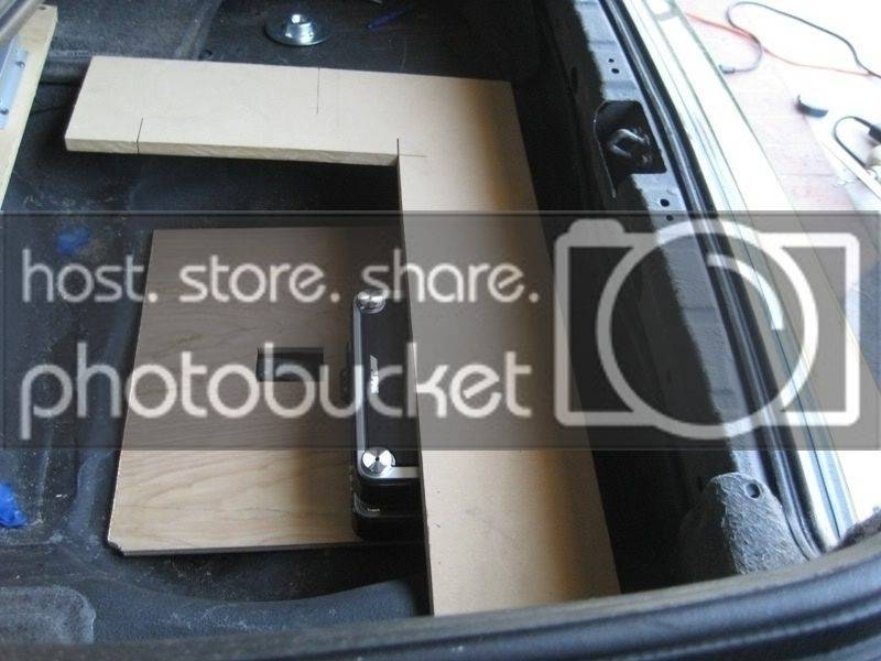

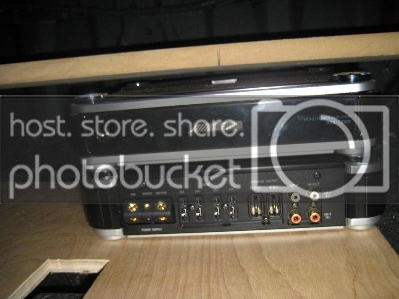

Here is my layout for the amps and processor. As shown in the first pic below, this is how it will look. However, I will have 2 amps stocked on the bottom portion. Those will be the 1.1000's while the one on the top to the left of where the processor will be is the 4.150. I have just barely enough room for everything to fit and barely enough room for clearance.

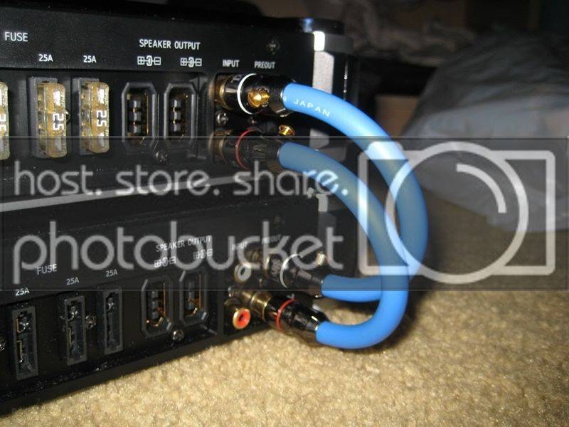

Test fit of the RCA's is shown below. I will be daisy chaining the 1.1000's.
Never thought about fans. I don't know if I'll need any. But now that you mention it I think I will do what megalomaniac did with his sub, which is drill a bunch of 2" holes. That should help with ventilation, but the PDX's don't too hot, at least not like my Kickers did before. I can put my hands on the amp and hold it there after a good 30 mins of cranking it and hold it there for quite some time and it will be hot, but not burning my hand.
