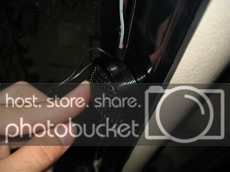

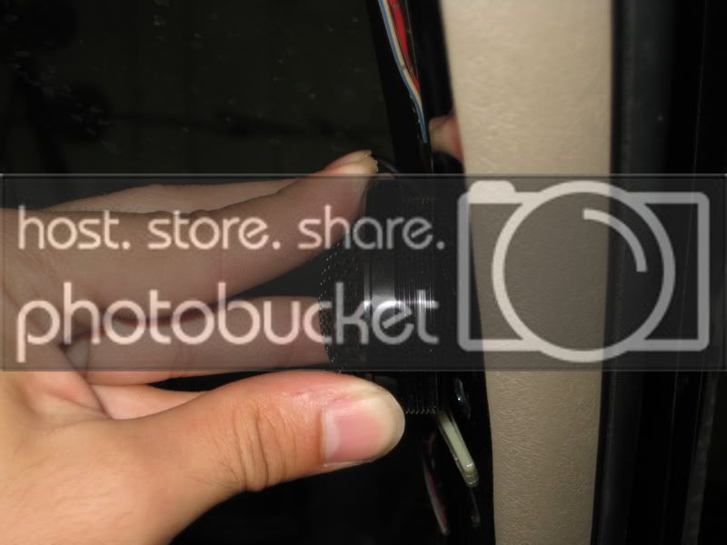

Came across an issue just now. I wanted to hide the tweeter behind the a pillar. The mounting depth of the tweeter is fine but the grill cover is curved so it extends out. I can't figure out a way to mouth the tweeter from inside either so that it stays stable. I thought about mounting to the frame, but the frame is angled and if I were to mount it so that it's not angled, it would be hitting the a pillar and sticking out.
I think what I'm going to have to do is this
I guess my concern is the way the tweeter is pointing. I'll take pictures so you guys have a better understanding of what I'm talking about and can possibly provide suggestions.
It would be aiming down like this and I assume that would mess with imaging.
I would have to extend it out quite a bit and it would hit the pillar and would probably extend out the hole that I cut out for it. Plus once the grill cloth that goes over the entire pillar is put on, it will look as though there is a little bump, and it might be better to just top mount the tweeter over the pillar.
Here is the gap.
The pillar is slightly angled pointing down, but not nearly as much as the frame, so I think I would be fine with that. Any suggestions?
