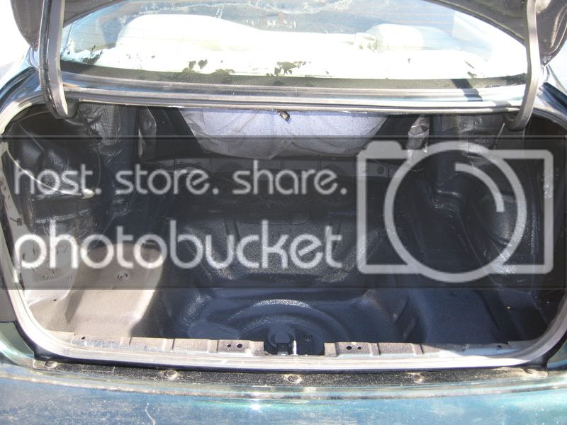

I'm facing some issues now. Originally I planned for the enclosure to be a wedge style facing the rear seats (sub on the wedge face). Here's a pic to get an idea of the angle I'm dealing with.
I can't deal with any measurements since the vehicle is in the shop for about a week, but I'm trying to get ideas of how I will mount the sub in the enclosure and get the enclosure in the vehicle. The seatbelt casing that hangs from the rear deck causes me to lose a good 2 - 3". Because of it, I'm restricted to about 16 - 17 inches of height for the enclosure.
I do want some trunk space towards the rear of the vehicle, plus the amps will be there and i don't want to move the enclosure every time I want to show the amps or something.
I am possibly thinking about considering IB, but not sure if I want to deal with the hassle or if it will even work with the 18.
I do have a question though. As far as loudness goes, would I notice a difference between the sub firing upwards or facing the rear seats?
