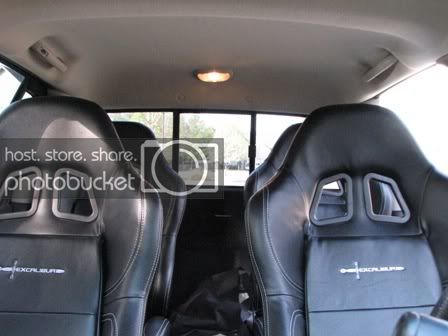

not nearly enough for a 6.5 ft^3 box + 2 amps + 2 batteries =/those bucket seats do look awesome though, how did you do that?
If you ran the console from the dash to the back wall it could be done.
As for the rear seats, just used some U-channel and welded up some brackets at the right angle and used the stock mounting locations in the rear of the Dakota and then attached the U-channel to the seats mounting points.
