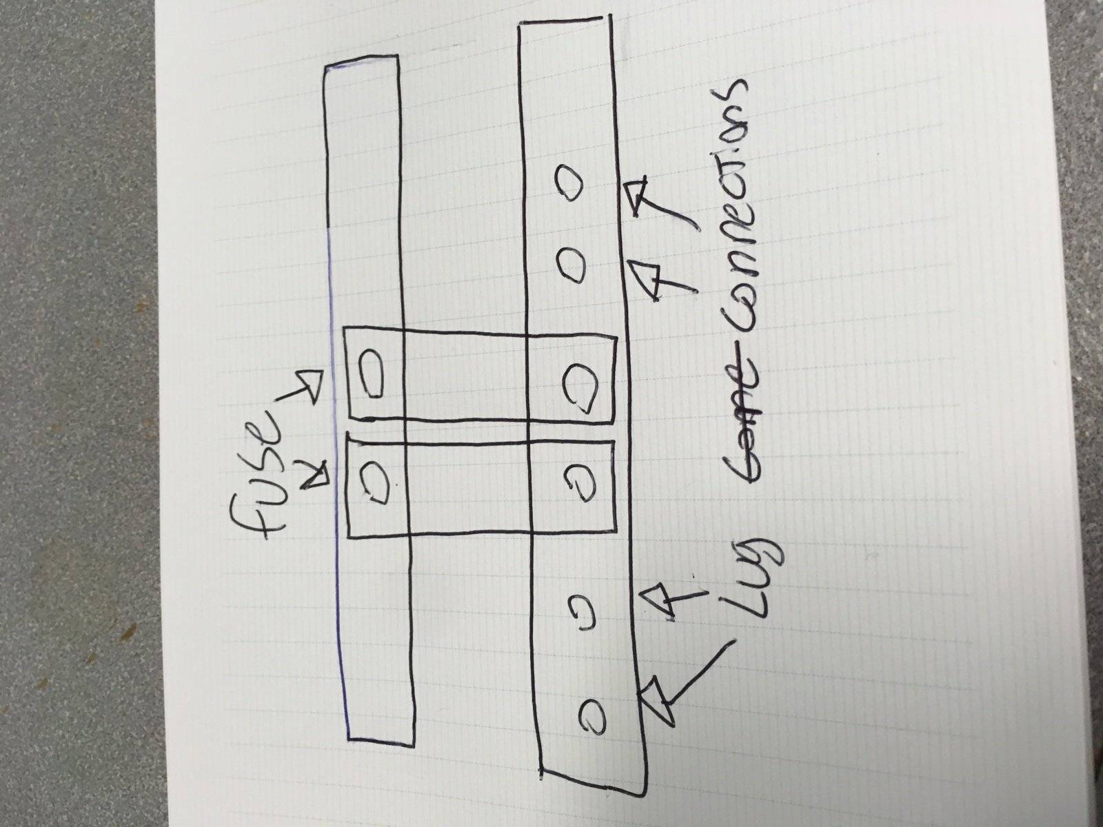

Sorry for the bad drawing. But I have mdf laying around and cans of spray on bed liner or plasti dip which is a rubber pretty much no? I can spray the mdf with it will be mounted to my back of the back seat. I want to run two leads to side I and fuse across and connect 4 amps to side b. Or should I just use 4 fuses at that point? Here's what I have in my head. Would steel bar from Home Depot work or no?

Like a hybrid fuse block/busbar

So would stainless bolts and nuts/washers work? Will be using a ppi 900.4 ct 75.4 for mids and highs and either one cab 1600
At .5(yes they can run .5 but I wouldn't recommend it) or maybe two cabs strapped so each amp is seeing 1ohm final. Running two d2 15s
Steel "works" but raw steel isn't ideal. That's why i mentioned aluminum instead.
If you go steel, at the minimum, it should be zinc plated.
If you decide to use MDF, have you ever painted MDF before? It's ridiculously porous. You will have to paint it over the course of some days to let the paint properly sit in before the next coat. I think this method is involving too much over-engineering for something too simple.
^^thank you for the advice. And yes I've painted mdf and have plenty of time to work on it. I do maintanace for 3 schools so I have a shop and all the tools needed and figured why not build it vs buy one. And I can do aluminum for sure.
Ok. I was also going to use a layer of rubber in between the back of the seat and the wood just for added safety. So aluminum for the bars and stainless bolts? I may be able to find copper unless the stainless is justs as good. Sorry. Noob when it comes to my metals. Going to spend a few with google and do some research
