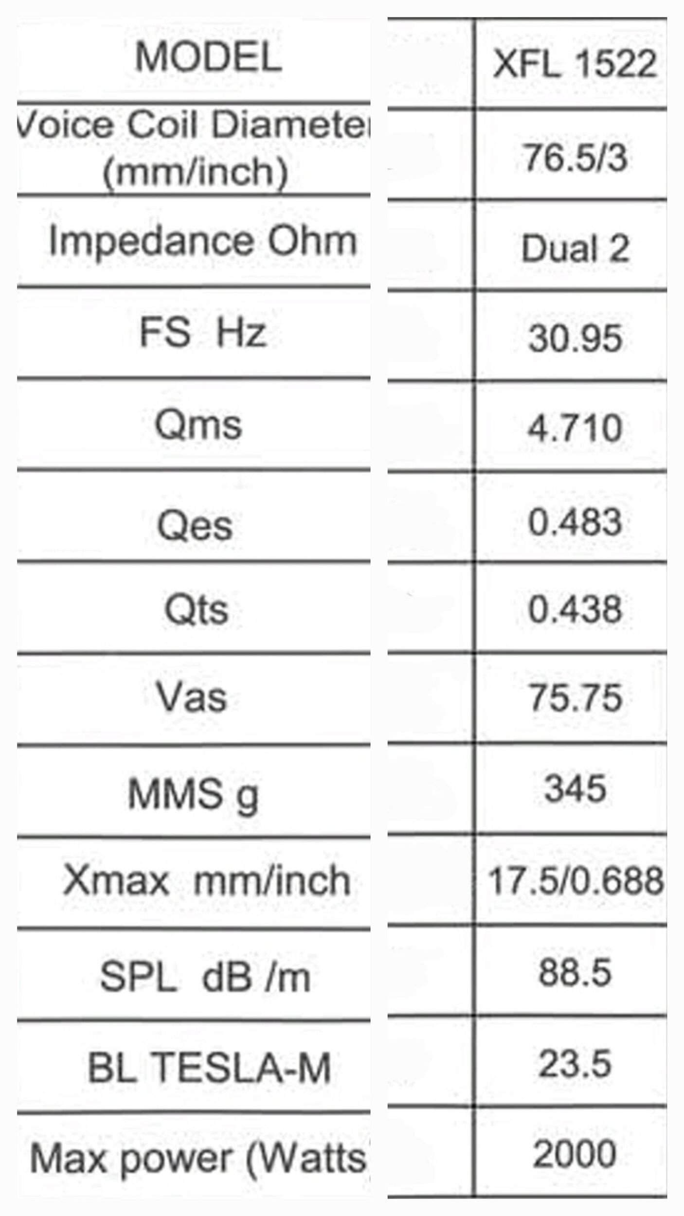

Powered by a RF Prime R1200.1. Planning big 3 upgrade. Plan to double baffle sub wall. Would prefer to have sub down firing if possible. ANY help for this old man is greatly appreciated!
AB calls for 2.75-3.25 but I know manufacturers sometimes list smaller size than what is optimal.
I'm having trouble finding a definite answer on sub displacement but according to one person it is .05474
I attached a screenshot of the other specs I found for the 1522. Thanks!
How much airspace does the sub you want to run require?

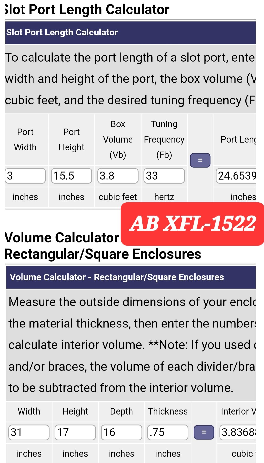

Not sure if this is reliable but trying to figure it all out on my own at this point. Does this look good?
