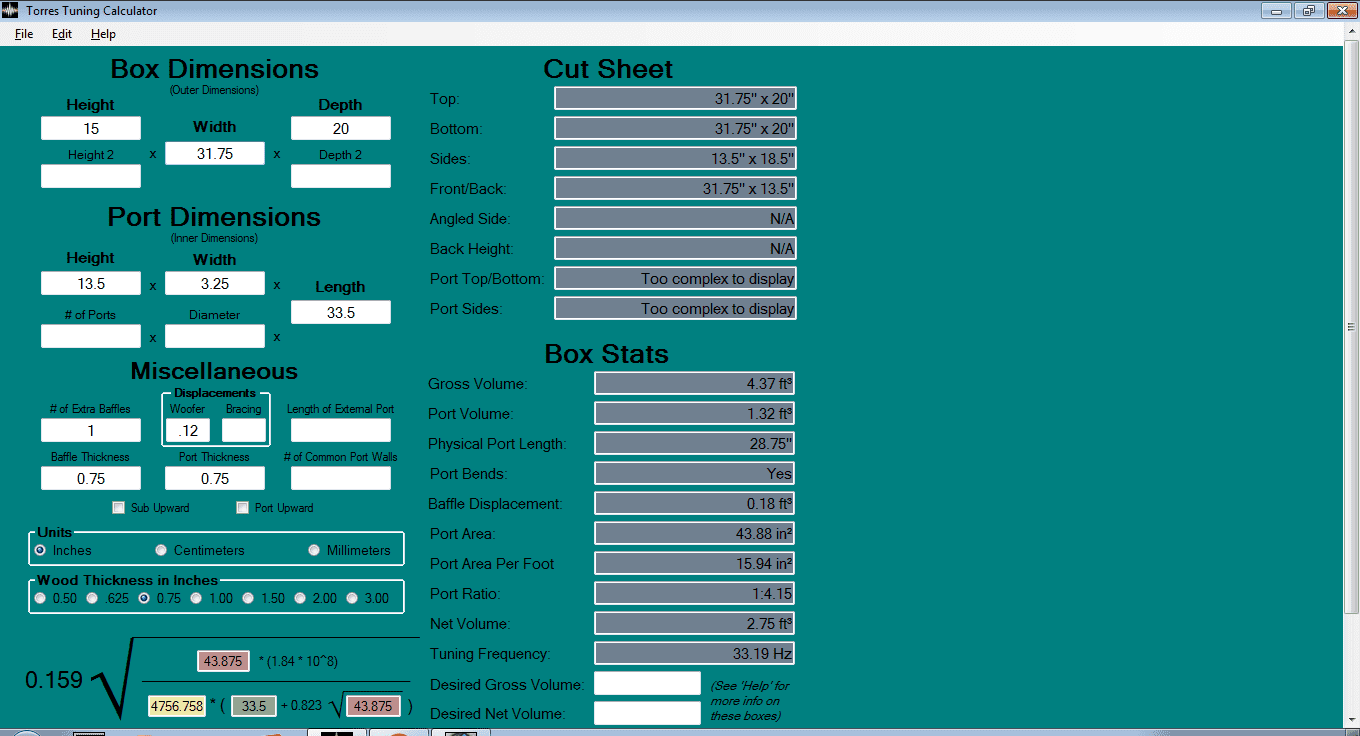

This is mine

I can't seem to get the parameters to work right... IDK... it's a big peaky box with a ton of port area and length... 33hz tune that looks like it goes LOW... I don't trust things I don't like... it looks allright but seems too good to be true if you know what I mean... anyways would you like to see what I came up with?.. no predictions or guarantees tho... sorry, I tried

Can you check this?... lotta port area... it's for 1.5k plus before rise... lol... I'm on the fence about this one...

Hifonics Brutus BRX1116.1D @ 1ohm for now till i can get another sub if i decide i want more. And Shredder I reckon see what we can come with in the 2-2.25 range at 30-35 like Kush was suggesting. And for ports which is better slot or aero? Does it even matter? Just curios. Aero ports look **** especially dual ports except the ones that stick out the box....whats the point of them sticking out? Is that second box 2.75cf? I dont know if im reading the stats right or not.....Thats all alien to me lol
