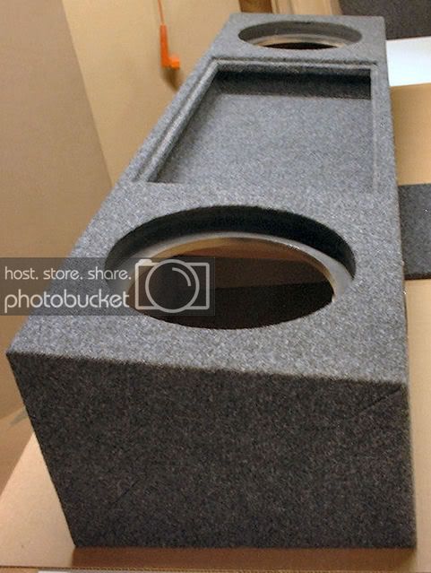

Design Q12 Ported - 02 silverado ExCab
Mr Cabinetry
Details - Fi Q12 Ported - Down Firing - 2.0 cu.ft. Net Volume - Port @ 33hz, Amp Tray
Additional Detail - Due to the spec's required relative to the size need customer is willing to raise the rear seat 1.5" and the enclosure protrudes past the front of the seat edge 2".

I'm assuming there's going to be a foot of some sort on the side of the enclosure where the sub is? Or are you going to just set the cone flat on the floor? lol
Well, geez, I was just going to let the that side of the enclosure flop around. //content.invisioncic.com/y282845/emoticons/rolleyes.gif.c1fef805e9d1464d377451cd5bc18bfb.gif
That side will have two supports that can be attached so they don't get damaged or snap off in shipping.
That side will have two supports that can be attached so they get damaged or snap off in shipping.
I think you left out a word that significantly alters the meaning of that sentence //content.invisioncic.com/y282845/emoticons/smile.gif.1ebc41e1811405b213edfc4622c41e27.gif

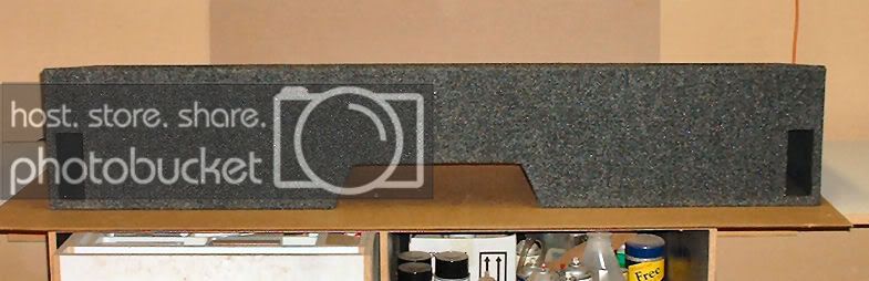

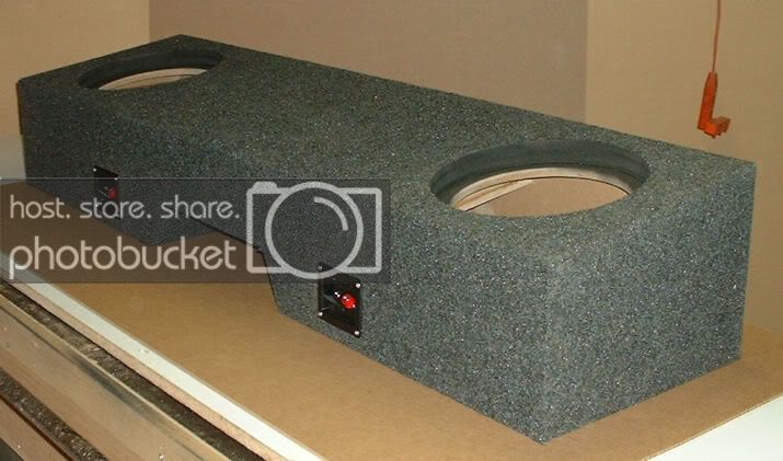

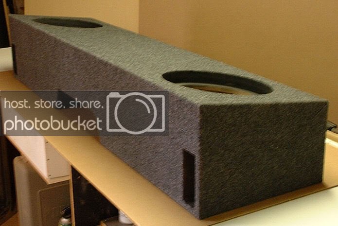

BTW, the design was revised to this:
