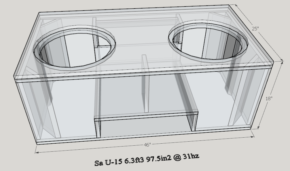

Dimensions would help. It sounds like your going to have to wall it off to do it right Whats an Azera?.. subcompact?
This went into a Tahoe...
Nice on a decent 5k if I do say myself
Yea it’s basically like a Hyundai Azera I’m running a 4500 watt amp with a lithium bank and the biggest box dimensions I could do and doesn’t have to be this big but can Is L: 42 inches W: 19 inches H: 27 inches
But if I did a trunk build I could fit a bigger box something more like that build for that Tahoe
If you got 42w x 37d and 19t why not trunkwall it? Subs/port forward sealed off from the trunk. Its more about install when your doing a trunk build in my exp. Trunk boxes do ok but 2 15s in a trunk? I say face em forward just do some prep work 1st...
Make it slide-in and solid. Deck too. Jmo.
Best I got
That's a big ol box man... why not give us a realistic measurement? Like what fits in there maybe? You know... the trunk opening and what slides in? What you think you got and what's available are 2 things unless you want to build it in there... 🤣 Or maybe it fits pulling the seats out and loading it from the cabin?.. you tell me. Its your car after all. Its a B when door size becomes a consideration tho.
