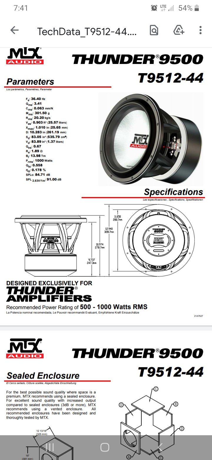

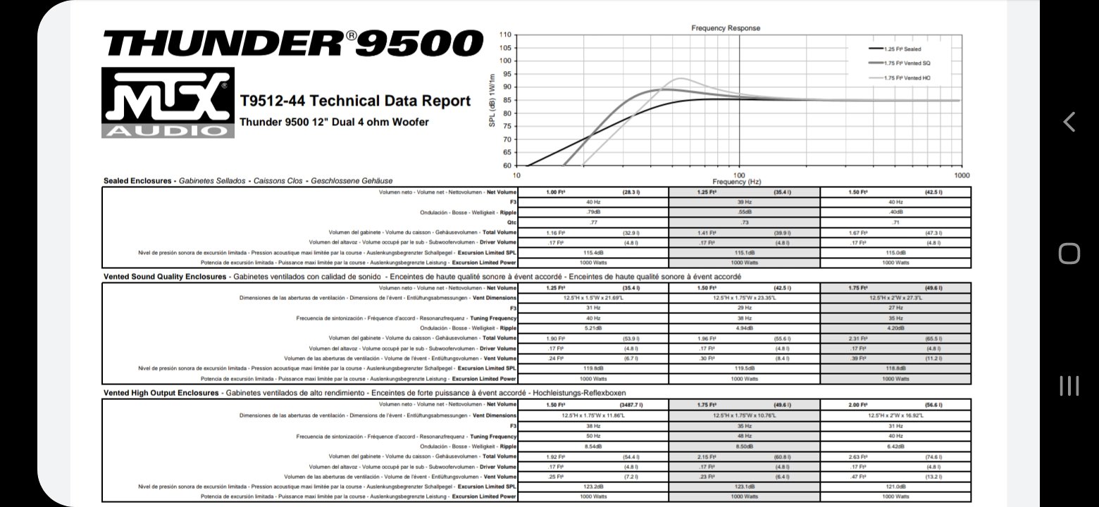

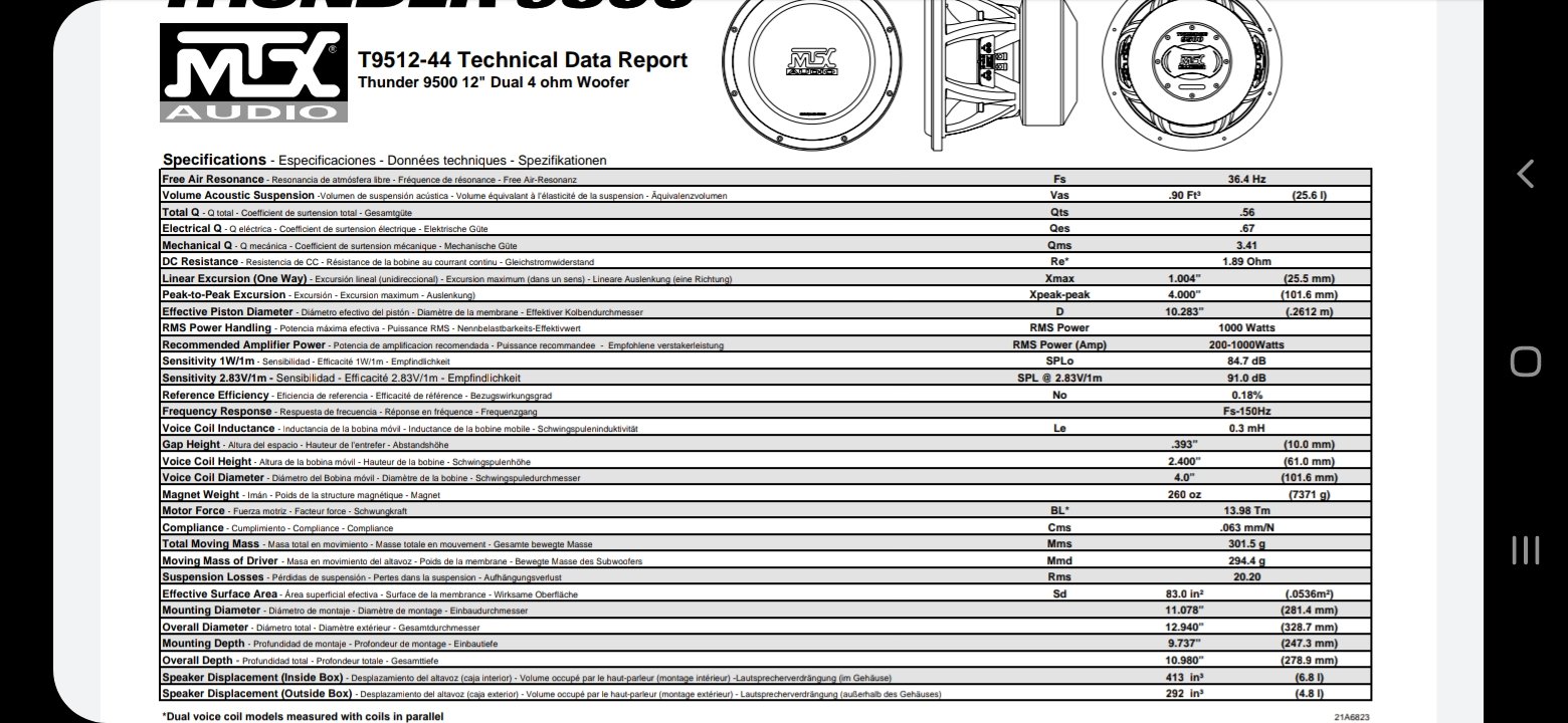

I'm currently running a slotted sq box but I want a ground pounder and heard the 4th order bandpass is the way to go. It's going in a 04 impala ss on a skar rp2000.1d. It sounds great overall but I know this sub can pound alot harder. Someone plz help me out.thanks in advance
