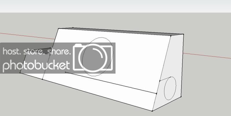

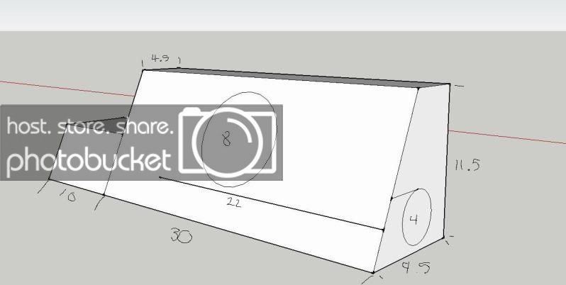

ok hey i have some questions i have this box designed for my single cab ford ranger. i was wondering if that bottom left part of my box is going to a dead zone because the port is so close to it the line represents the ports length or if i moved the sub down and the port above it would it be more efficient if you need more information just ask
details
8" sub
4" aero 22" long
That placement will have no effect on the sound. If you were to move the sub down above the opening of the port that could cause a problem with port/sub interaction.
To answer your question, no there is no dead zone.
What I was saying was that the only problem you can have in a ported enclosure when it comes to design like that is that if the opening of your port inside the box is right next to the sub. Otherwise, answering your original question there is NO dead zone inside a box. In a properly built enclosure all the air inside is common and changes pressure with the movement of the cone and has very little effect on efficiency. I think having the port on the bottom would be best for clearances on your port though.
