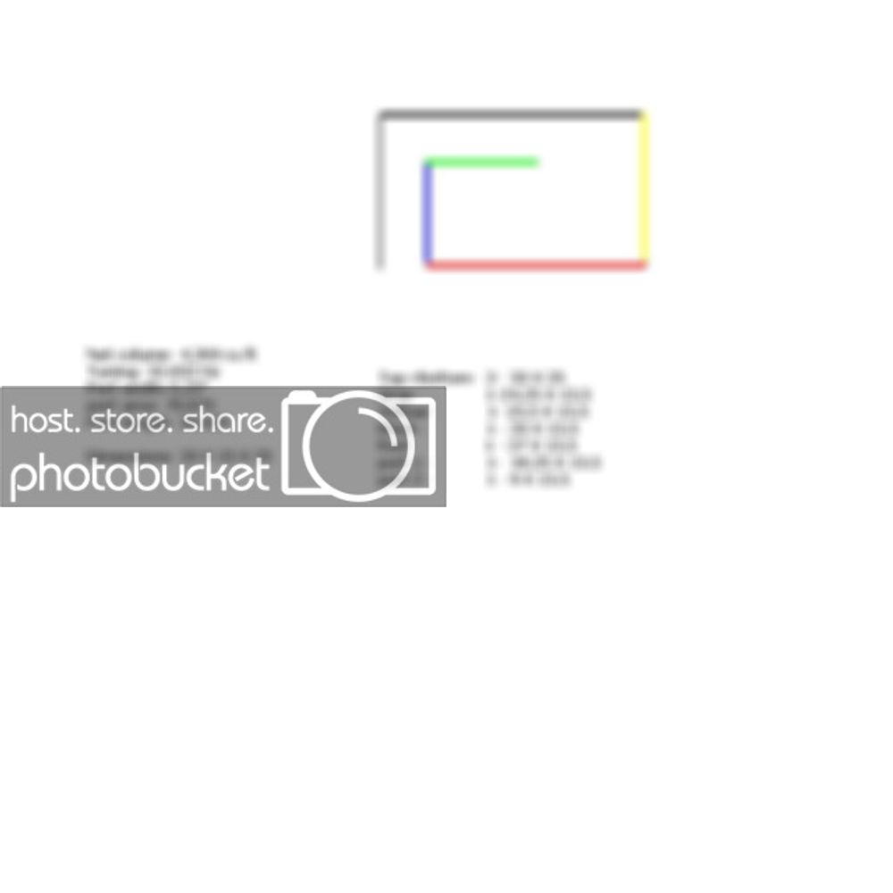

Made this using the re calculator. making sure everything will be alright.
running 2 re se 12's
Enough port area? is the port to wide?etc.
Thanks
I will model it up today, but in my experience it should work
out slightly smaller net and tuned slightly higher once all
displacements are accounted for. But it will still be a great box.
Total volume gross : 5.783
Port volume: 2356.59 / 1728 = 1.36
Port wood volume: 27.25 x 13.5 x .75 = 275.9 - 275.9/1728 = .16
Speaker displacement : .15 + .15 = .30
Total displacements = 1.82
Net volume = 5.783 - 1.82 = 3.96 cubic feet
Port length: 33.25
Port area: 5.25 x 13.5 = 70.875
Approximately 4 cubic feet at 34.3hz
