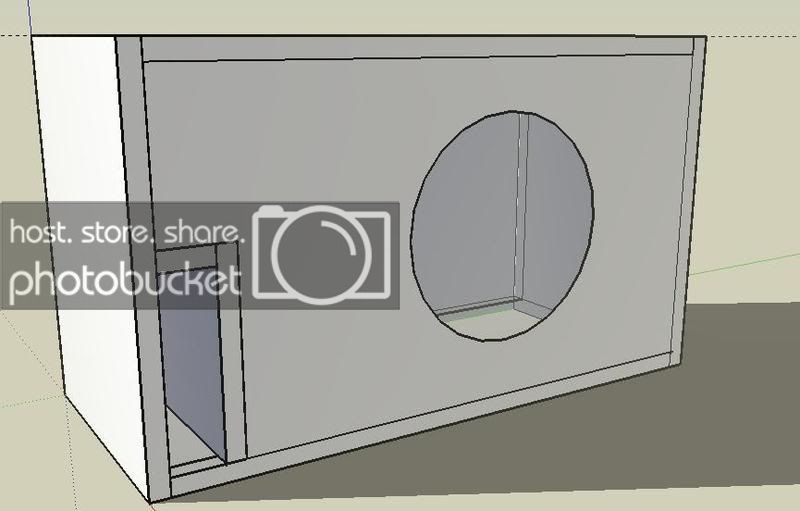

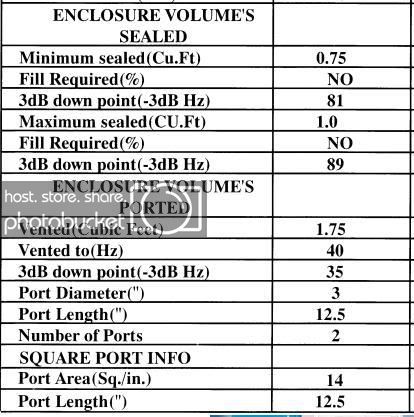

I used the instructions in the sticky to design this box using Win ISD
Sides 11.5X15
Top/Bottom 11.5X24
Back 13.5X24
Front 13.5X22
Port Area 14in2
Port Height 7in
Port Width 2in
Port Length 10in
Gross Volume 1.86 Cu ft
Net Volume 1.75
Tuned to 40hz
Please let me know if I've made any mistakes.
Make it 15" x 30" x 11 1/4" with 2 4" round ports 20 1/2" long. That will be roughly 1.75 @ 40hz with 25 inches of port. That port disturbs me. If you use a aero port you could get by with one port......make it 15 x 30 x 10 with 1 4" aero port 9" long that has 12.5 inches of port.
