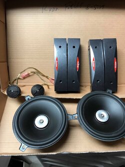

I’ve may have a lead on some Boston SL60s, If I get them, I’m gonna do some fabrication, to turn my 6x9 holes to 6.5s, and put the Boston rally’s in the back...that may be the better route, then just getting 6x9s and rolling with it. Front stage is important, for SQ.

I bought the Boston SL60s
