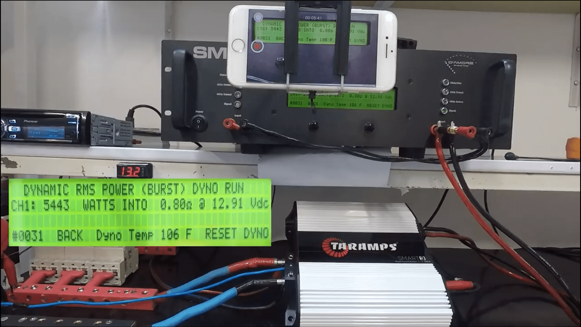

I would have no problem running that amp at .5. They are stout amps and should be perfectly fine at half ohm. You could always sell it and get a Taramps Bass 8k and run it at .5 or an MD8000 and run it at 2 ohms.
Yep. Smart 3 amp. 👍
3k at 1 and 2 ohms.
.5 stable
4v input friendly.
1/0 inputs.
