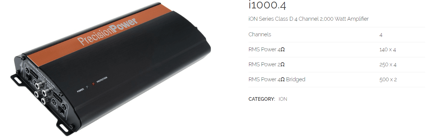

Im setting up crossover on amp for a couple Beyma 8s. The 8s have a freq. response of 65-6k hz.
The proper setting on my amp would be to set the hpf at 65hz correct?
Just wanting to make sure.

I assume these will take a "break in" period before they are working at their best. Should I avoid giving them max power during this period? They are rated at 250 RMS.
19423
If I'm not supposed to give them full power for a while, was wondering if I should wait to hook them up bridged to ensure they don't get too much power too early.
Thanks.
Personally I dont think it matters. Just set your gains clean is what matters. No clipping. Just listen to the speakers, they will tell you if they are straining or not. You might set your HPF at 100 for the first week and get a feel for the speakers and how they sound, then lower the HPF and listen for signs of stress.
