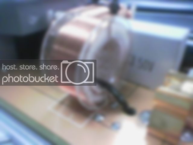

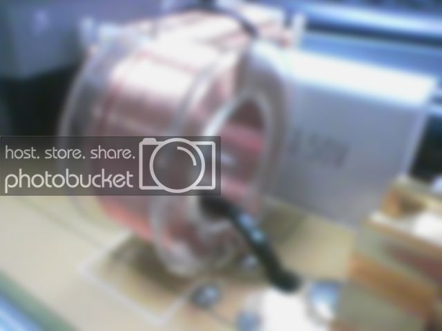

Also, I realize one of the XO's (the same one with the light issue) is having some problems. I had incorrectly connected the XO's but after doing it the proper way I was testing out the mids. I had the gains up maybe 3/4, and one XO was fine but the other started smoking. The first pic is the XO that is fine, and the second pic is the one that got smoked. This is the only difference I saw.
Good:
Smoked:
