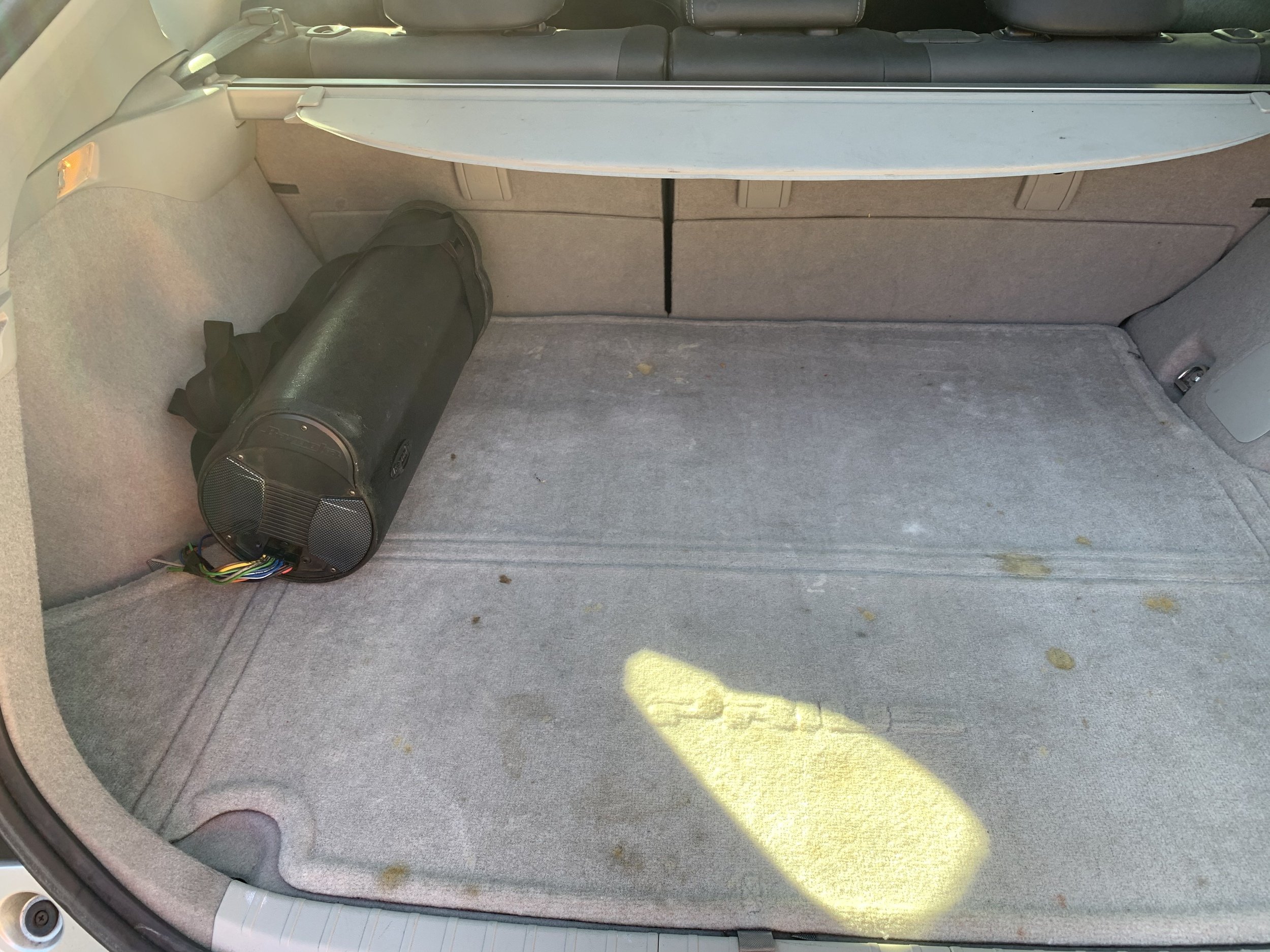

Thanks for all the help guys. Got up up this morning and gave it a shot. Ended up tying all blue wires and seems to have worked. Excuse the mess but here is a pic.
