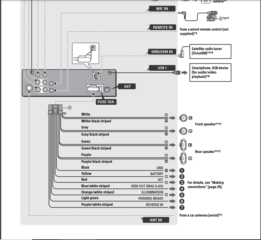

When I installed my after market HU (using a PAC harness), the directions had me connecting 4 blue and blue/white wires together (see image below). The 2 blue wires appear to relate to the antenna and the two blue/white wires to the amp turn on. So now that I want to install the sub, I have ZERO idea how to make the remote on connection. I figure there are about four possibilities:
-tie the blue wire from the powered sub to this entire bundle (so five wires together)
-tie the blue wire from the powered sub to the blue/white from the Sony HU
-tie the blue wire from the powered sub to the blue/white from the PAC
-tie the blue wire from the powered sub both blue/whites (from the PAC and the Sony HU)
In all cases, I imagine the remaining wires would be bundled together. Does anyone have any idea how this is supposed to work? Thanks.

1st recommendation: tie the blue wire from the powered sub to the blue/white from the PAC.
2nd recommendation: tie the blue wire from the powered sub to the remote blue/white from the Sony HU
In both cases the remaining three wires stay together? FYI, my head unit has a blue white but no blue wire. And, I do have a factory amp if that matter.
Maybe simpler to follow the suggestion of using another source for your sub remote wire. As JRsmoothee suggested, tap into the fuse panel and use a fuse controlled by the ignition switch. Or you can tap the power wire coming from the ignition switch and going to the radio. A wiring diagram should help.
Did you try the power antenna wire? Youtube.com install videos can also be helpful.
Thanks. Haven’t tried anything yet. I’m a novice so trying to understand as much as possible before starting. Looked up the fuse box option and looks like I would need a piggy back adapter, which maybe I can grab from an auto part store. The only thing the videos I saw didn’t show is what amp fuse I should be using. And since a wire would now be coming out of the fuse box, I guess I would need to find a way to close the panel.
