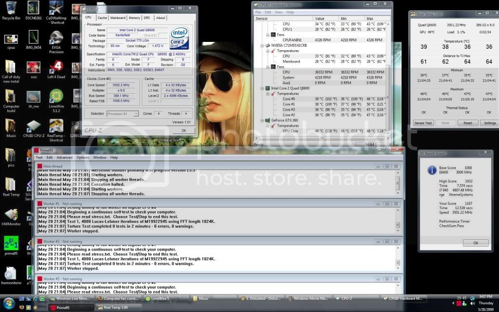

No I can't get it stable at 1.45 at 3.5@ Sec i will post a a ss here in afew seconds
I think I call braging rights this is only 2 mins of prime its pretty much maxed 24 hours of prime will only raise the temps about 3C more. . . I hit 4.0 on this chip at 1.53Vcore for benching

i noticed your FSB is extremely low for such a high OC.
Run a higher FSB and lower your cpu speed just slightly.
You will need to start tweaking the north bridge voltage settings and GPL, skewing, anything and everything possible.
I had to pull up research information for my chip and board for months, about 4 months actually before i got enough info to go by to ensure i could safely OC without fear of failure.
It's also true that higher FSB will result in faster pc. CPUs today are way fast but the rate of information transfer still lacks. Increasing this, FSB, you'll be very happy.
Only downside is ya gotta have some **** good capable memory of maxing out the FSB or it's impossible.
