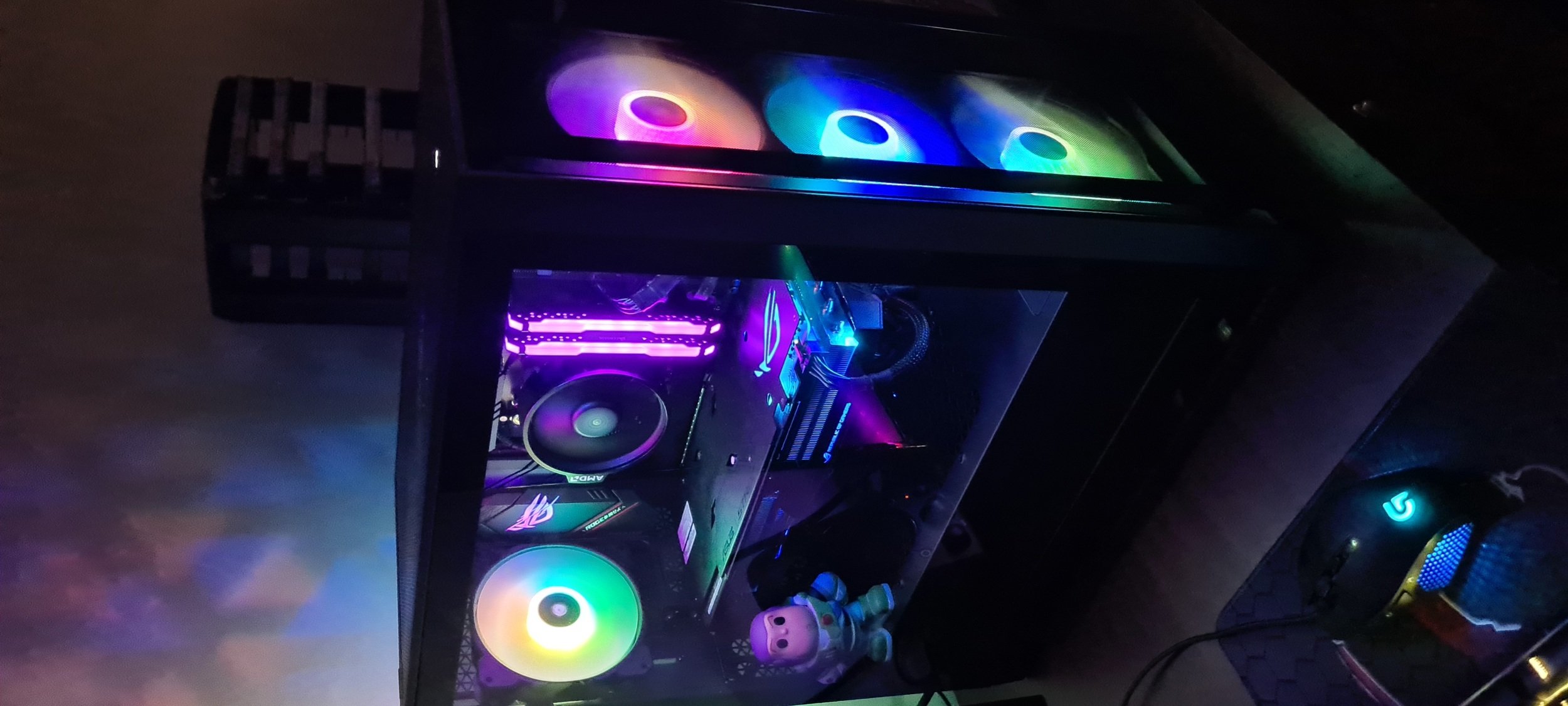

Nice, I build them fairly often for family and friends. This is my current rig.
