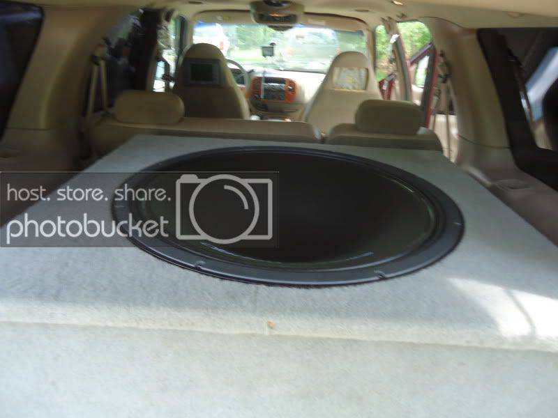

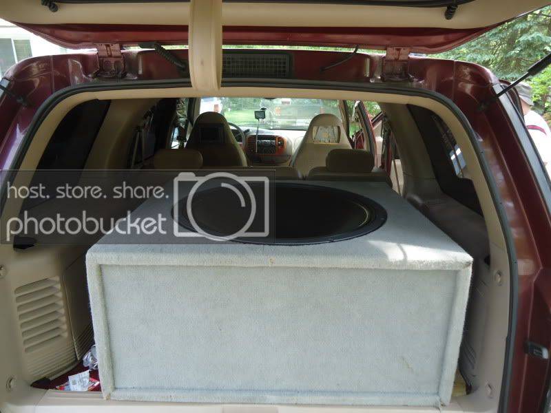

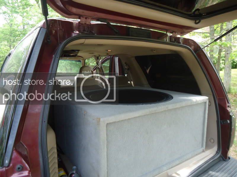

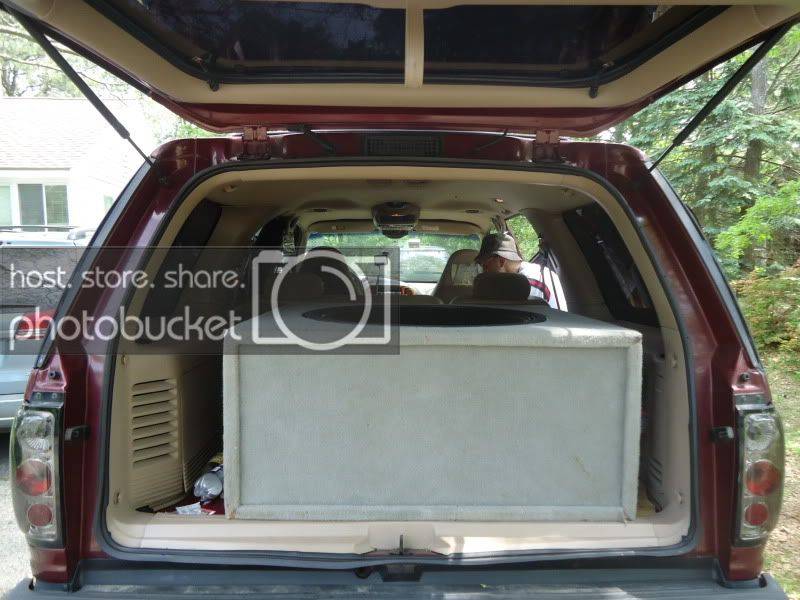

Also pics of 32" sub in Expedition:

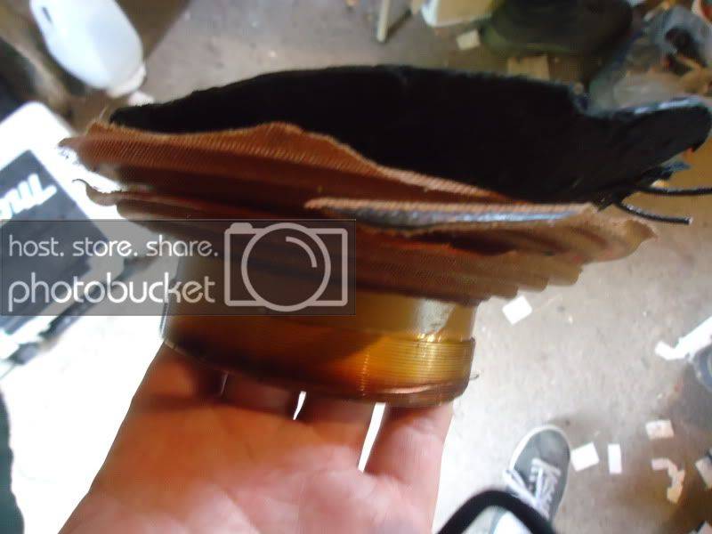

The coil.....
I cant see the top plate because the motor is encased in the frame, but I suspect this is underhung. Actually wire gauge is a bit thicker than I expected.
We may just end up having some new coils wound for this which would **** because minimum order is 10pcs and you don't get a good price break until 200 or so, but compared to what this guy paid for the sub I guess even 500-600$ worth of coils isn't terrible.
The coil.....
especially is he blows coils while testing
sounds good are u gonna make a higher surround or do u think it wont have much excursion?
It is very limited by the depth of the gap and the distance between the spider landing and the top plate. Really assuming a better design the current surround would have a ton of throw
