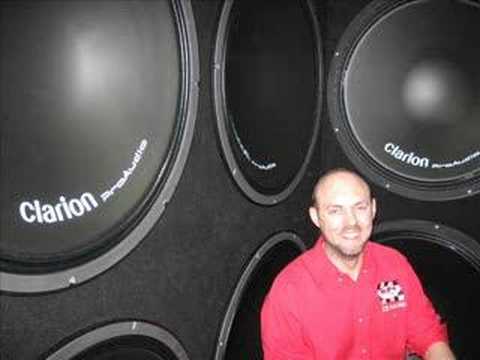

Friend of mine has a couple of these. One running in about 13 cube sealed on 250W doing 140.6....not too shabby for a sealed box and 250W!
Anyway apparently while these claim 1000W max, he proved the hard way that they don't handle 1000W well at all. So, kind of wondering in anyone has any clue who actually built these or if there is any possible source of 32" cones. (I believe the coil is 4" so I suspect I can come up with one of those somewhere and spider appears to be 8" so that shouldn't be an issue).

they didnt make them for long because they had too many design issues.
They seem very impractical for everything except drawing a crowd to check it out at shows....they should have named it the "WTF" because that's what you say when you see it.
