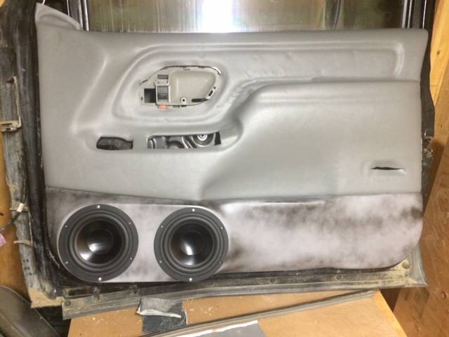

Ya I made fiberglass A pillars and door panel pods. I will be happy to help you out with your battery set up when your ready. Heres some more pics,

Great mid bass though !
I've been using them for ages and agree. My doors do not have an easy line to follow to build up a mounting panel though and I simply haven't had time to really dig into it. I do have some extra door panels here and I have been meaning to get the second pair mounted somehow.

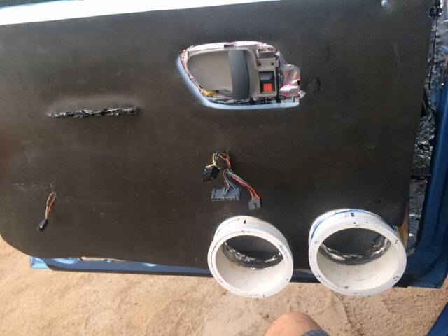

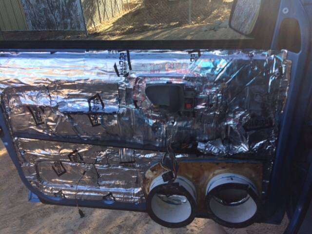

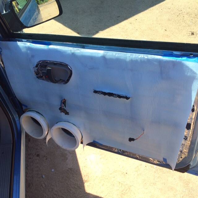

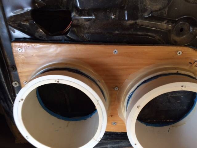

I took me a while to come up with this mounting idea and they are sealed to the door itself via pvc and plywood mounts I made so the doors are sealed up with sheet metal over all the holes in and then the doors are covered inside and out with deadner all the panels and then inside of the outside panel is covered with fiberglass flex ceiling tile sheet. The mounts were made from 6" pvc and couplers and glued into plywood to provide a mounting flange so to speak and the fiberglass work on door panels is just to cover them up. I will be doing a little more work on them soon and I will post pics for you. I did have a bunch of pics but due to a computer problem I lost all of them:(
Here is some pics had had posted on another site
