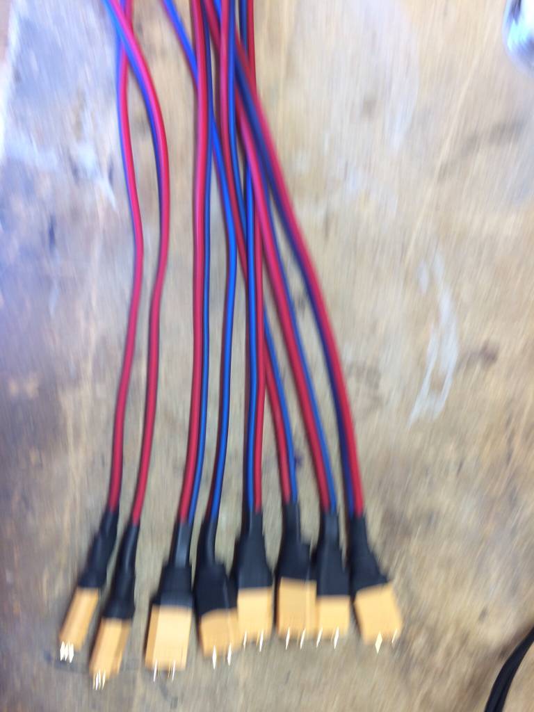

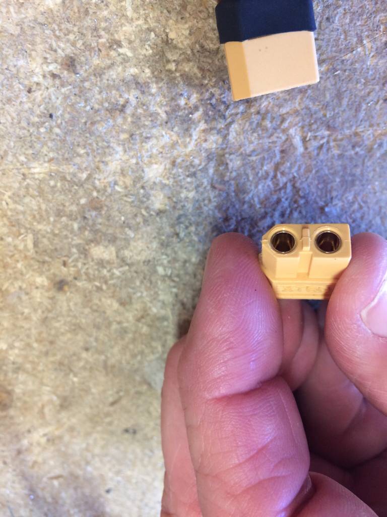

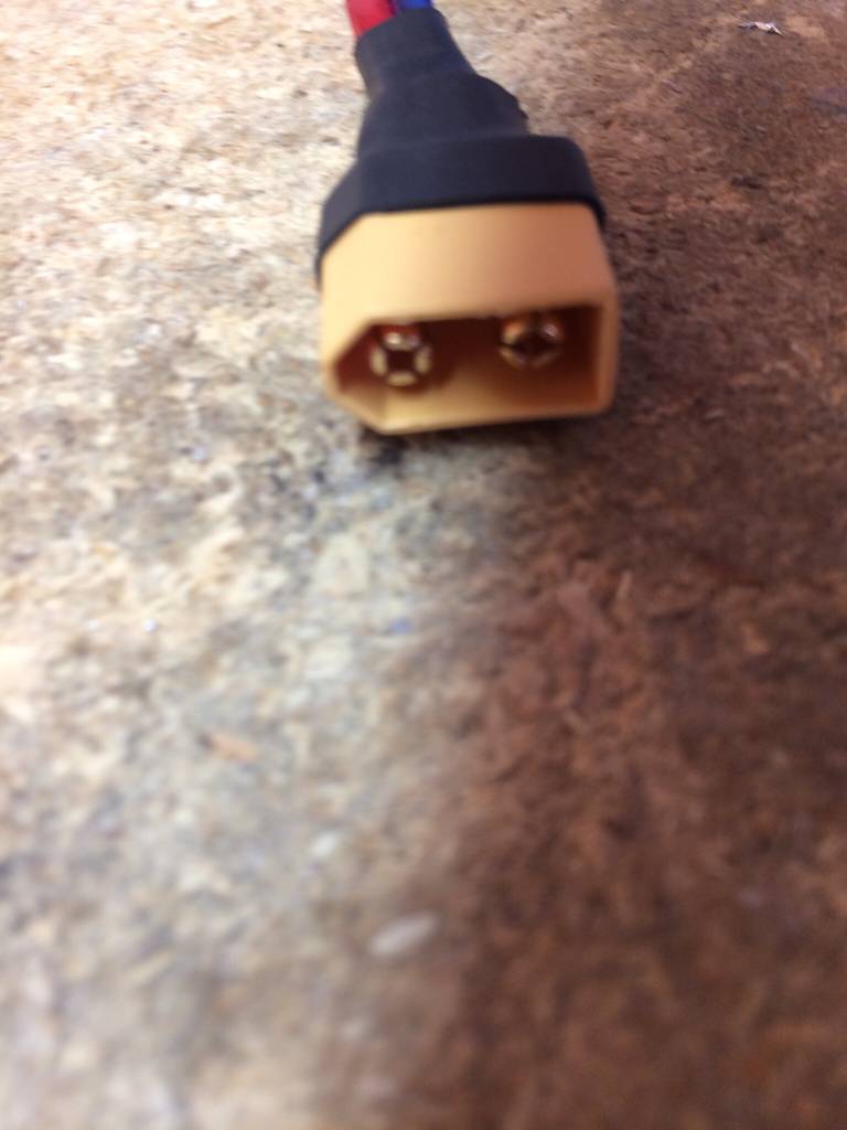

3 Rewiring mids and tweets to clean up wiring and adding 2pc xt60 connectors at every speaker so easier to remove and replace -not that you couldn't do that with other connectors but these looked cool so I got them. Add terminal blocks for each speaker run again easier for amp changes and maybe build a new amp rack and add an amp, maybe sundown 200.4 or another ppi 900.4 and bridge it like Jeff did and use it to power my 2 pr anarchy's. I may get a sound processor and go to a 3 way front stage but not sure just yet and if I can handle that lol . 4. Going to drop subs down to .5 I have been running the Taramps HD 15000 at 2 ohm so I should get a little more out of it at .5 or burn it the fug up lol !

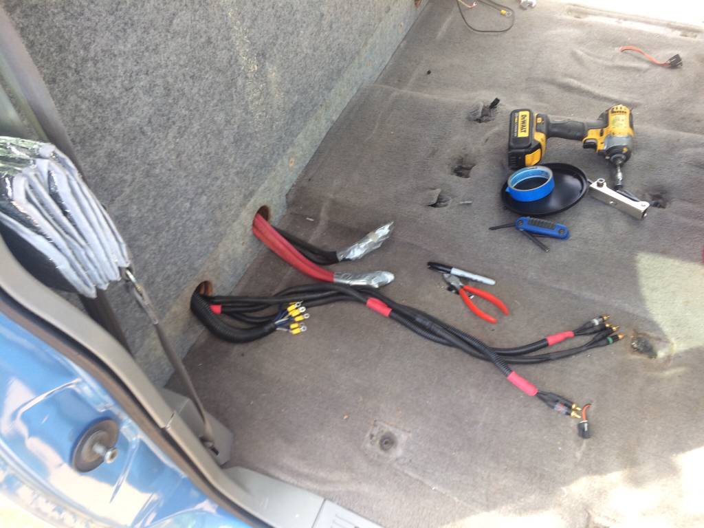

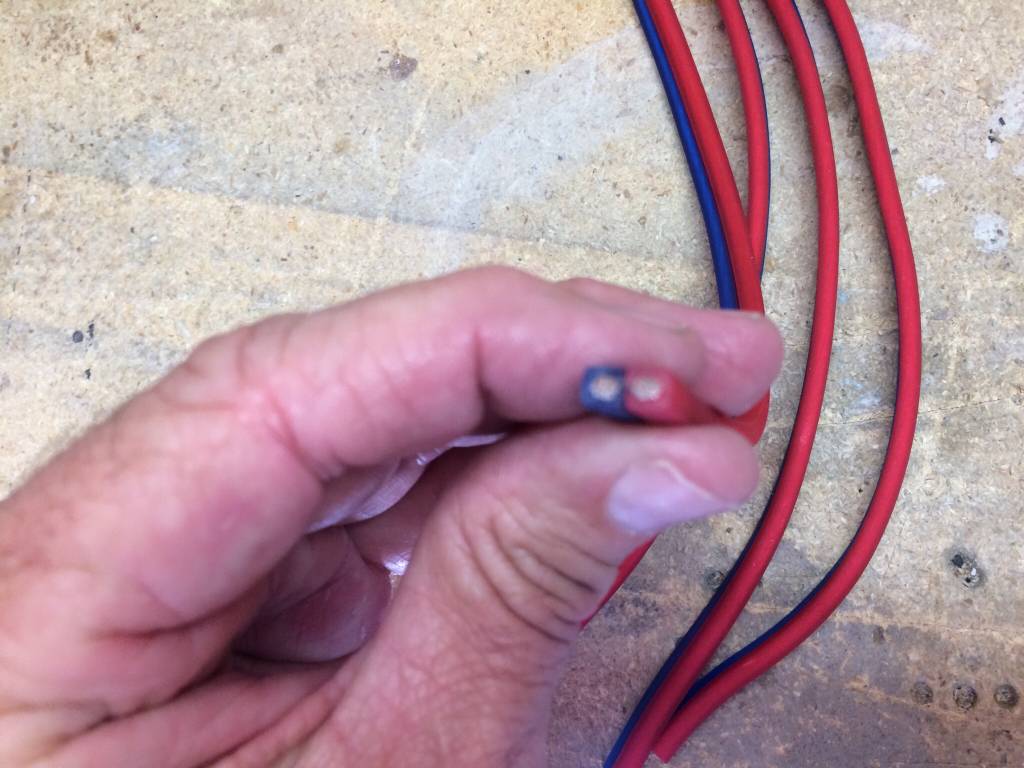

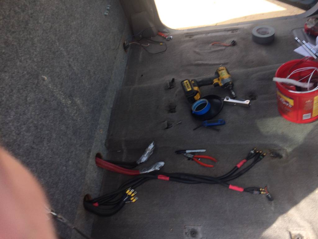

Got started making my new speaker leads and that's all I got done today.
i like deans connectors the most, i have it on all my lipos, but i feel like all connectors are just too bulky for car audio besides spades.. but its your truck and if you have room i dont blame you at all

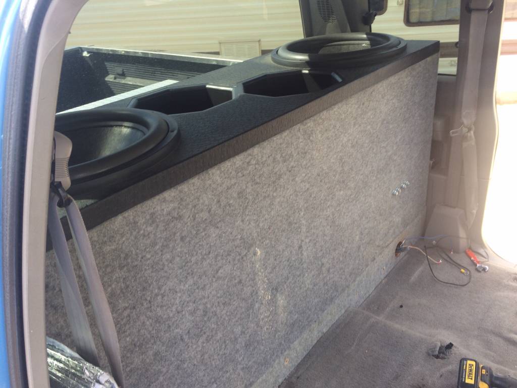

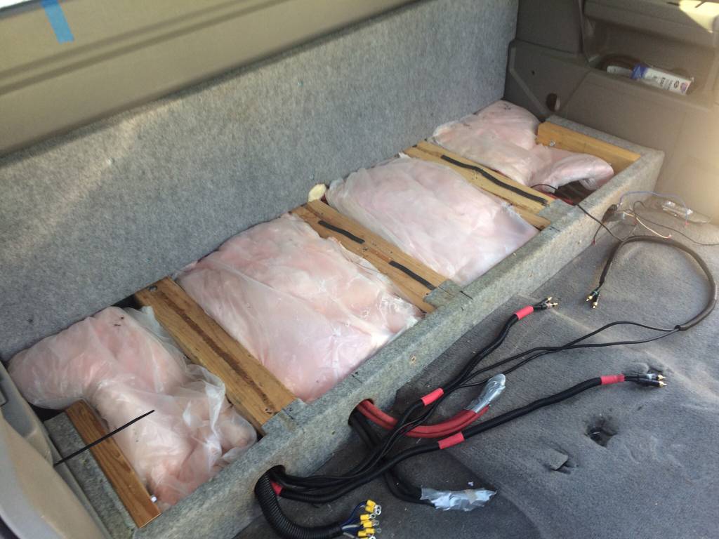

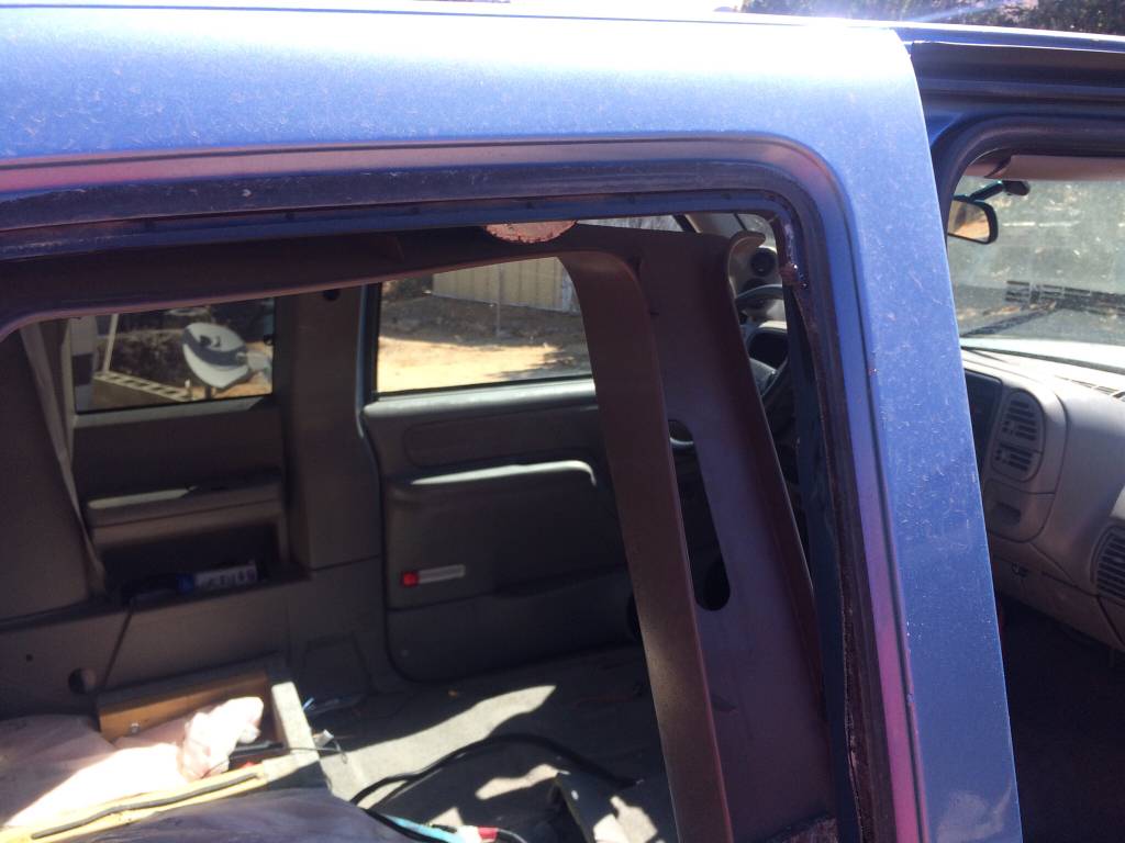

Got started tearing it apart and got most of it pulled out. Forgot subs are heavy AF especially in the position they are to get them out of box - just enough room between box and headliner and not easy to lift in that small area. And getting box out isn't real easy either.

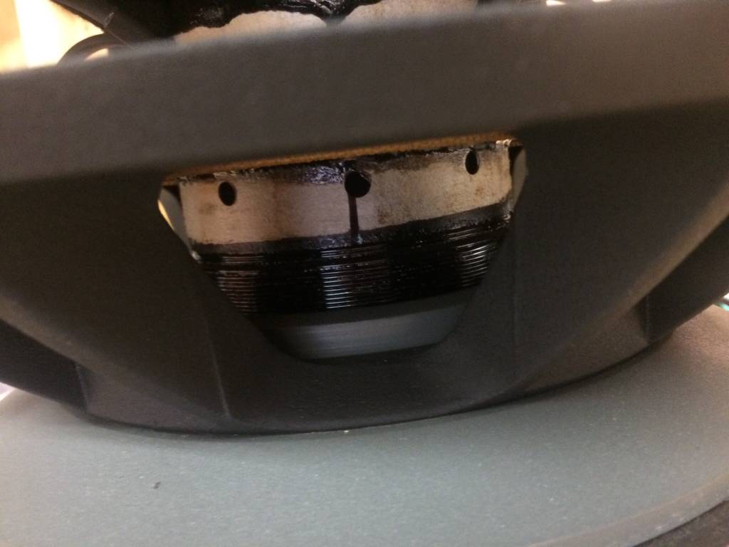

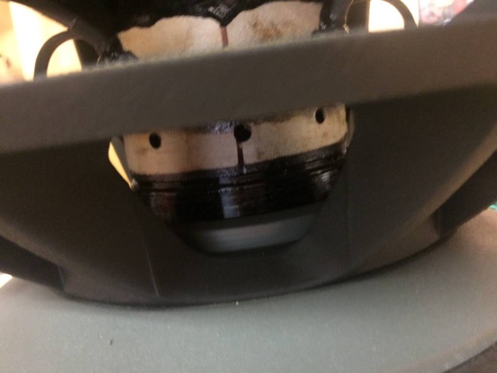

How do coils look ? Seems like they look the same as when I put them in. Tomorrow I am going to try to get quarter window pop out frames out and windows glued in stationary. And get some wiring done too.
Oh ya ? I have often wondered about the ppi dsp88r, it had some bad press but I have heard quite a few people that like them too and its not too terribly expensive to give it a try. I am not that good of a tuner so laptop is no problem and I have one with me for work all the time anyways. As far as caps go what is 2-3 banks, instead of adding another battery or add both ? What do they cost and where do I get them ? I have never used them any articles on them ? I will search the web.
coils look like stock psi coils to me, no scorching on the paper part of the coil so im sure its just fine

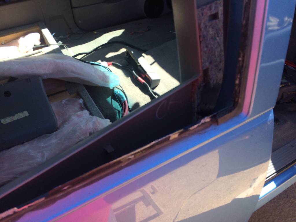

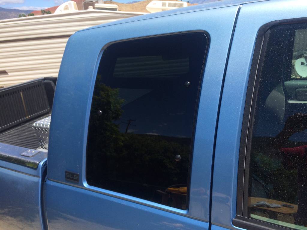

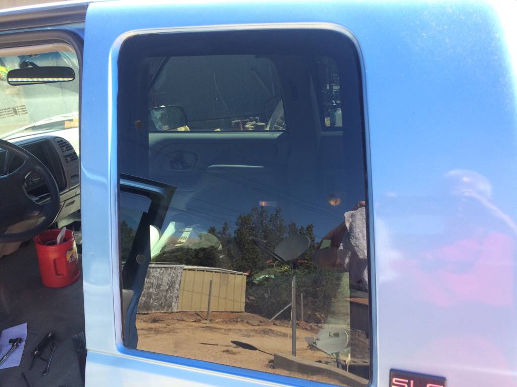

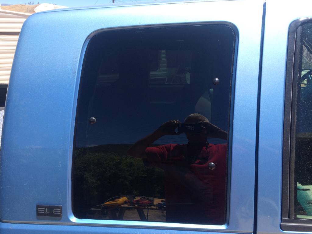

Well started on my quarter window project and turns out I was correct and the pop out frames are glued in just like most glass but you gotta cut them out lol not for the faint of heart ! I used a saws all to cut most of it away and cut the rest away with a razor knife cleaned it all up and layed a bead of caulk and stuck it in and easy as that. I should gain 3 db just from the lack of window flap ha ha and more importantly it will be much quieter inside . Now I just gotta go do the other side and it will go faster now that I know what to do.
Something I should have done a long time ago !

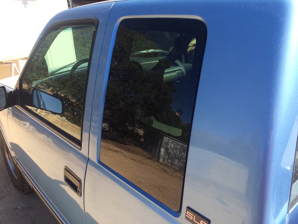

Thanks but Mine is not happy with it lol getting cleaned up and adding another amp and maybe a sound processor. Got the other side window in and all came out pretty good, other than my hands, that windshield glue is some nasty stuff my hands are black even after washing them with acetone and even tried gas and still won't come off! Should have used latex gloves since i have a box Smh lol

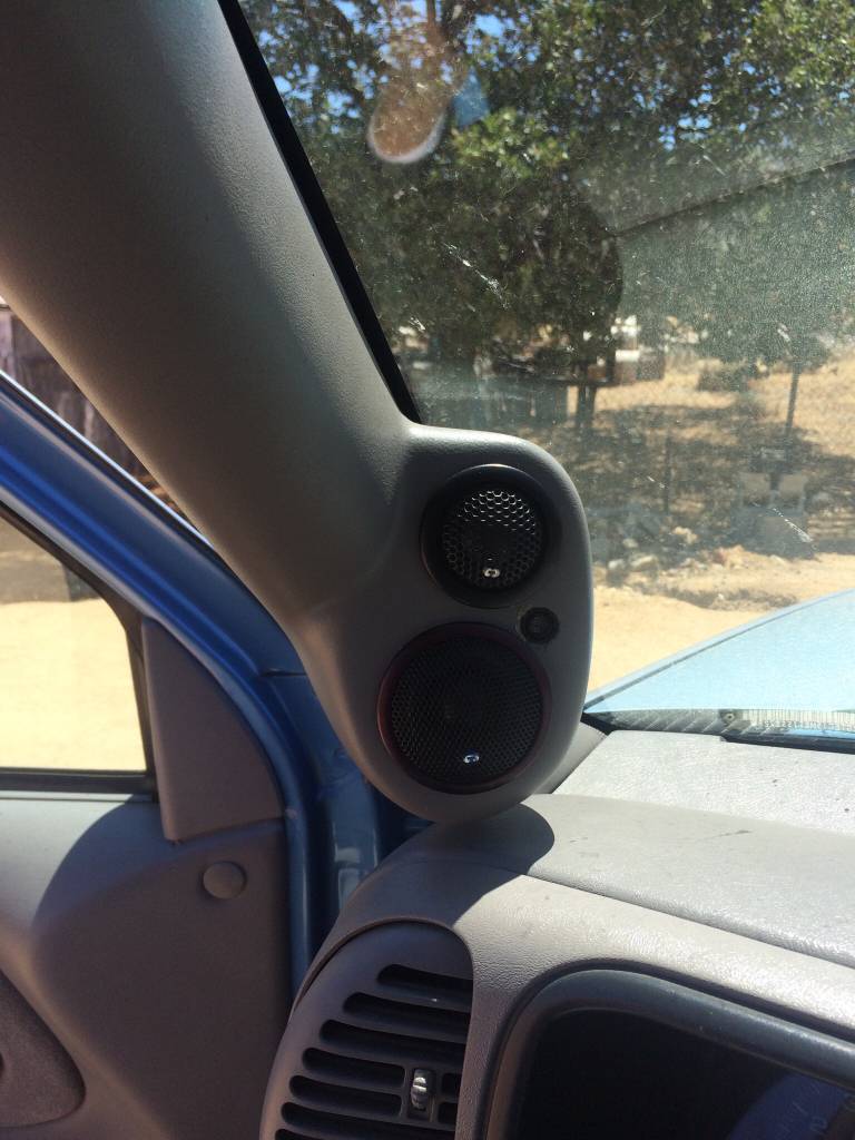

I got my alarm cleaned up and added another shock sensor for a total of two and also got a ultrasonic sensor that is two stage so if I leave a window down and you start to reach in it will give a warning first and if not stopped alarm goes off and it really works well. I also added a glass breakage / audio sensor it really works nice turned all the way up you can just rattle your keys outside the truck with windows up and goes off and it's two stage as well . I mounted the mic for it just under the dash but the ultrasonic sensor had two Mics, one for each side to mount on A pillars but I want to flush mount them into me speaker pods in my pillars. I will work on that next and will have pics. I forgot to takes pics today but I guess it's probably not too smart to post your alarm and where everything is in the truck lol. I still gotta put pin switches in the tool box and under the hood too, maybe tomorrow. May also get my hidden ignition kill switch done too.
