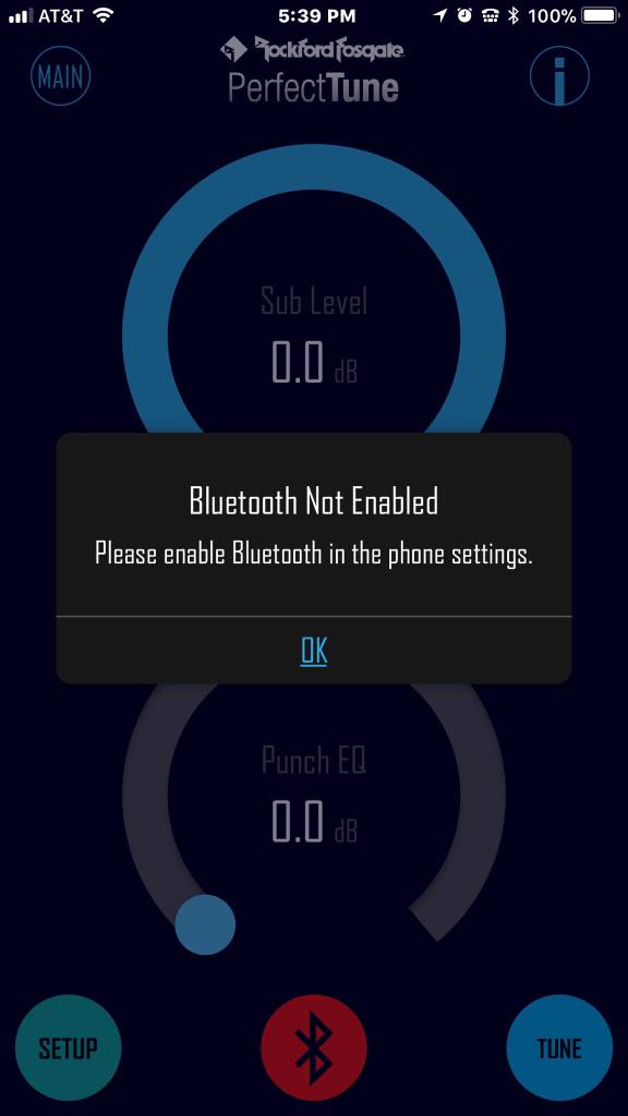

Are you android or Apple ? My iPad works flawless with DSR1 but my phone won’t, processor s/w says turn on bluetooth in phone settings and it’s already on? Turned of and on , erased app and reloaded and still says it’s turned off on phone ? I pad is great at home but I don’t want to carry it with me till I get this dialed in so phone would be so much easier . And phone Bluetooth works on other connections?
The process is just have your bluetooth turned on, Go to the rockford app and go to connections and connect in there. You cant connect via phone's bluetooth options, it has to be through the app.
Ya I get that and works fine on iPad but my iPhone won’t , when I open Rockford app it says Bluetooth is turned off and go into phone settings and turn Bluetooth on ? Only it’s already on ?
save your tuning settings and unplug the power harness on the dsr1 and plug back in then try to see if it works or not. Its a little wonkey on android. Took us a good 20 mins to figure out wtf was up with the connection issues.
How do I save ? In presets ?
It should be in preset manager. Try calling RF customer support tomorrow about this issue, I never seen that message pop up before. Chris uses a galaxy note 8 and I have a zte axon 7. Connection lost here and there and issues connecting if there is no open line of sight to the dsp but it connects.
Mine works like a champ on my iPad just not on phone. I will call them and see what they say. I do love it so far though and the amp upgrade , really woke my system up and sounds 10 times better and I don’t even really know what I am doing so it can only get better !
