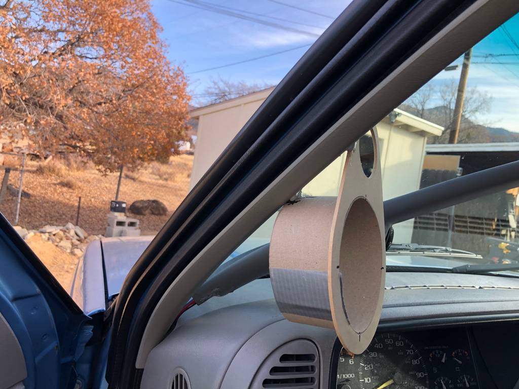

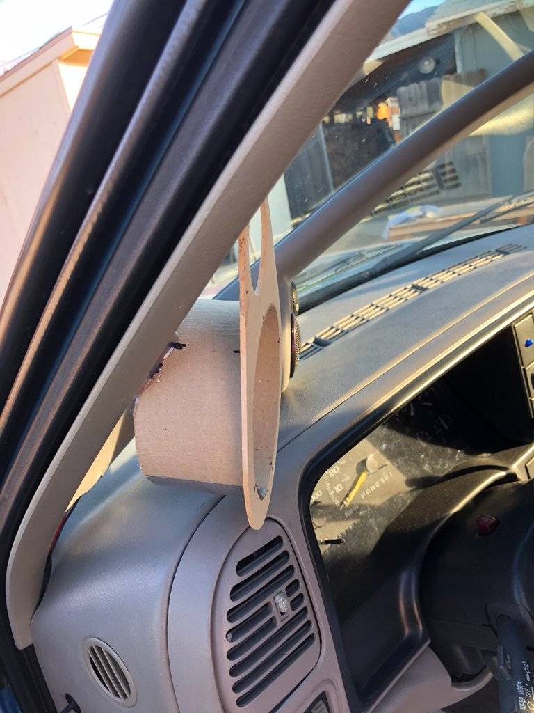

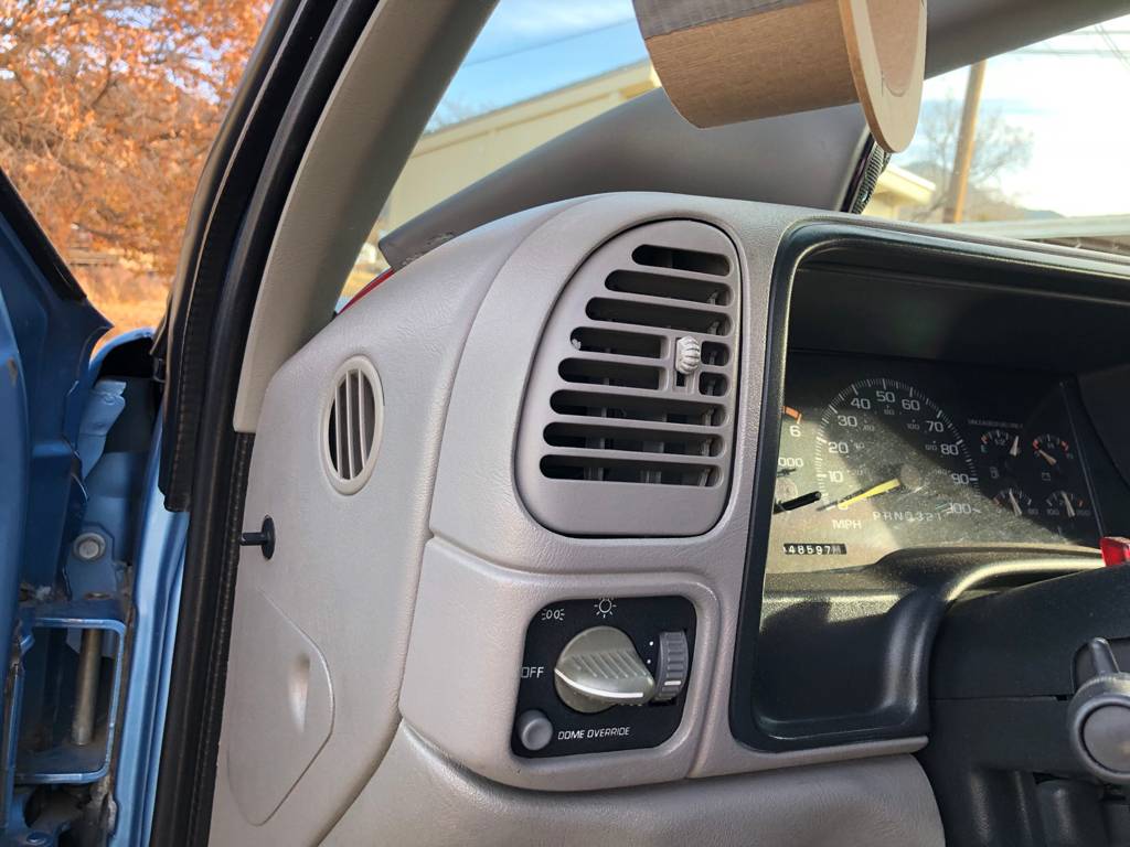

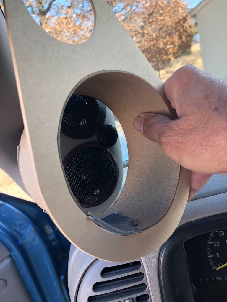

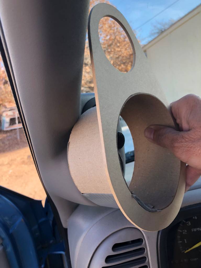

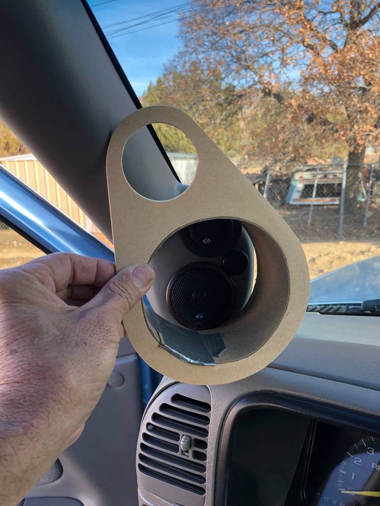

Well I started playing around and looking to see if I can even fit a set of the prv 5” neo mids in my A pillars as suggested and I don’t know that’s pretty big speaker to fit there , problem is on old body style gm s is the large bumped up dash on drivers side. I got plenty of room on passenger side , well not plenty but more than on drivers side. This is about the only way I can make it happen.
This will put the mids and tweeters pointing slightly downwards? Anyone think that will cause any problems?
Maybe a little deeper but it really starts to get in the way of visibility and I really don’t want to get a tickets for them lol, I also saw an idea on Diyma putting tweeters and mid side by side with the tweeter on the outside. I will play around some more and see

You putting a 6" midrange in the a piller?
Was going to put a pair of 5” prv neos in pillars but that’s just too big and in the way of view out windshield so I have a pair of faitalpro 3” neo that I could do in pillars pretty easy so my have to go that route.
