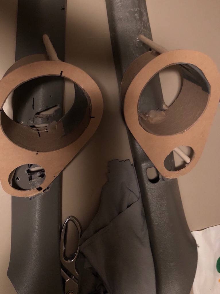

Was going to put a pair of 5” prv neos in pillars but that’s just too big and in the way of view out windshield so I have a pair of faitalpro 3” neo that I could do in pillars pretty easy so my have to go that route.

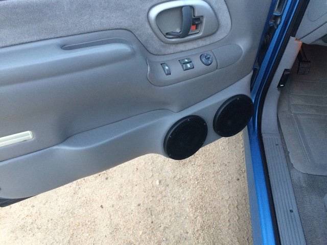

Not really anyplace big enough left and I have a pair of Anarchy’s 7 s midbass in each door already.

No I am back on the 5”s I was making mounts for the 3” and said screw it I will make pillars for the 5 s (only an inch bigger on each side right )and I can put 3” in first so I can see how they sound ( just for curiosity) and then cut them out for the 5”s and to know I could use them if the pillars for the 5” bother me being so big.I started on them last night.
Got to go get fiberglass resin and chop mat today or tomorrow and get them done hopefully this weekend .

Ya I meant in the doors and I don’t want to hack up the top half of the door panels just yet. I like some of the things you did with yours like the kick panels and dash top pods and almost went with dash pods but will try this first. I would love to have kicks like yours but it is my work truck and I think they would get trashed pretty quickly down there, I got big feet lol ! And the E brake thing But who knows maybe I will look at it to put bigger mids in later. I really wanted to try to build sealed doors project like you did but couldn’t put them into the doors anyway [emoji20] the Anarchy’s are almost touching the glass now. The windows rolled down all the way go to the bottom of the doors. I bet they sound great ? Mine are sealed into the treated doors ( not just mounted to the panels) and do pretty good but would love to hear them sealed.
Anarchys are IB anyway. You dont wanna seal them.
