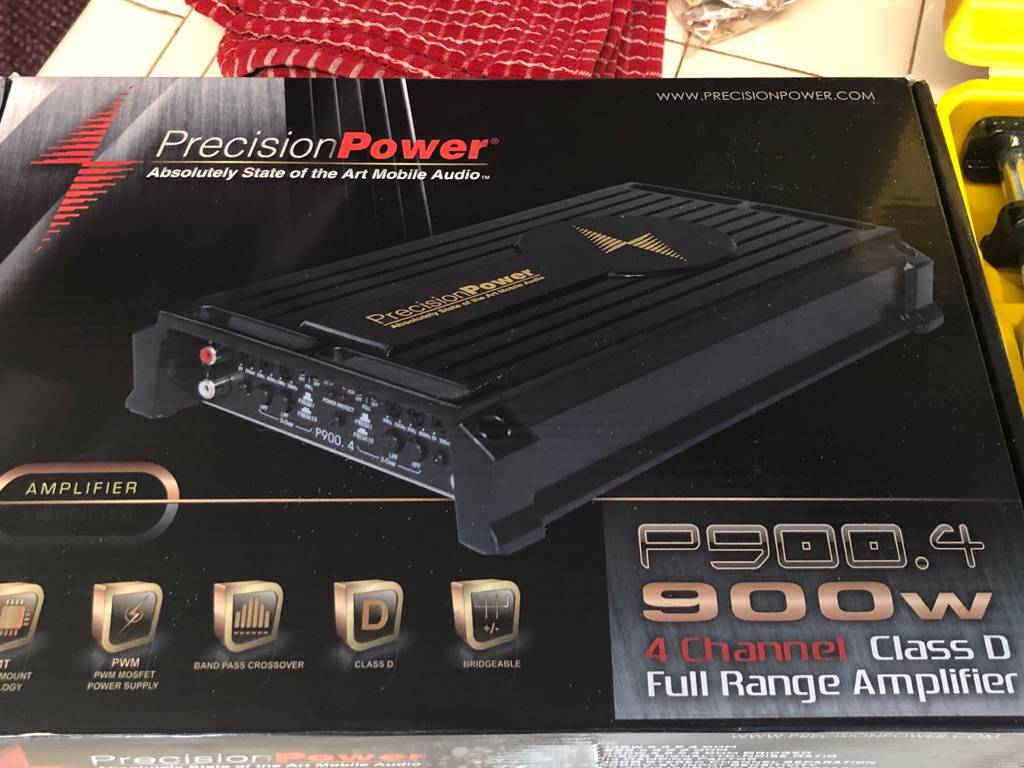

Got my last ppi 900.4

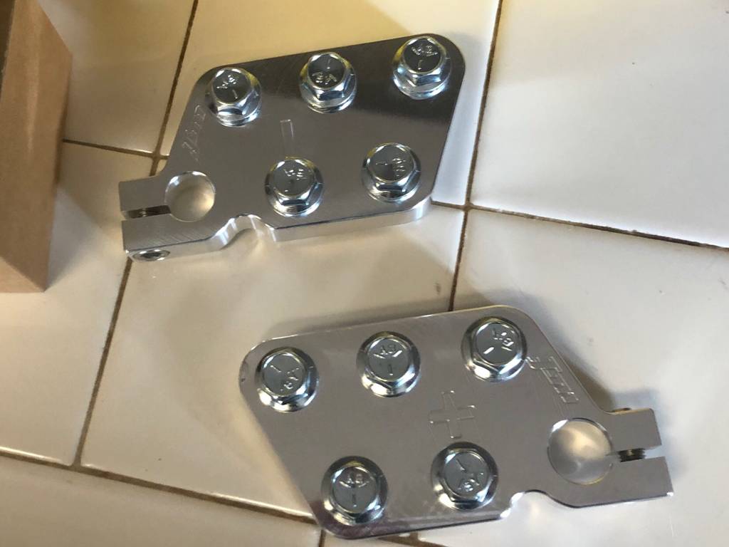

Got a pair of Jims machine worx battery terminals for my front battery

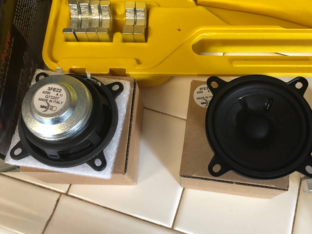

Got a pair of faital pro neo 3” to try in my existing A pillars

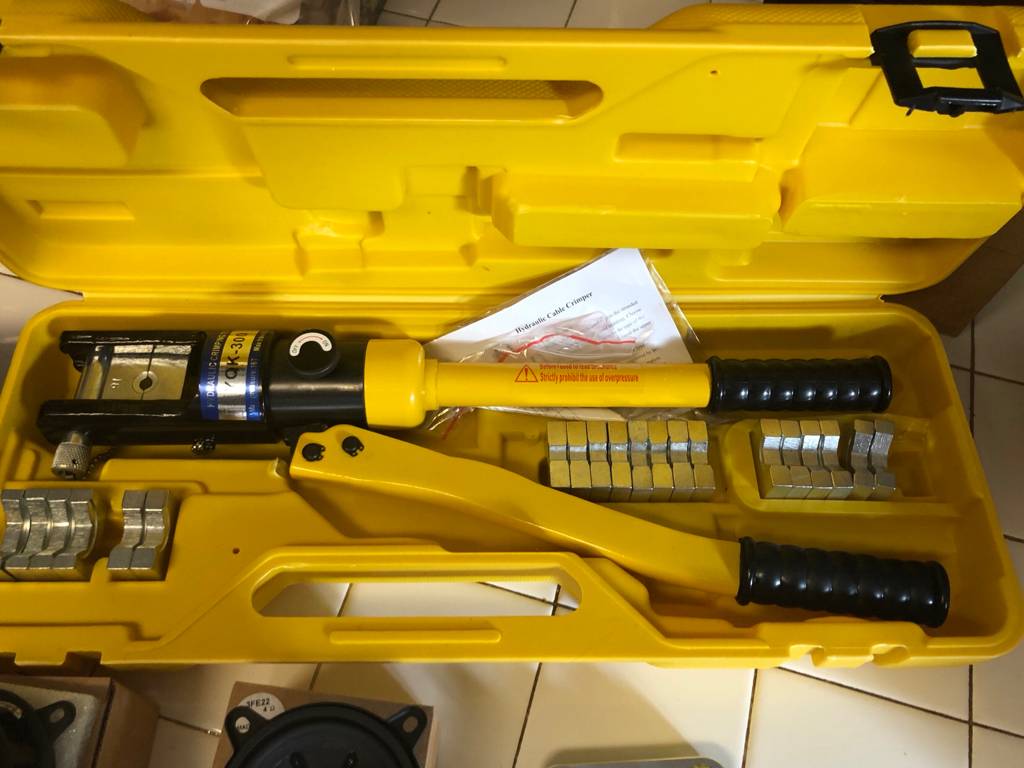

And got the 16 ton crimpers too

sick, is that an actual die that will fit 1/0 or even 4/0? thats probably my biggest complaint about the harbor freight ones ive used - no large dies
those terminals are much nicer than the ones made by shca
Ya huge dies , bigger than I will ever use lol

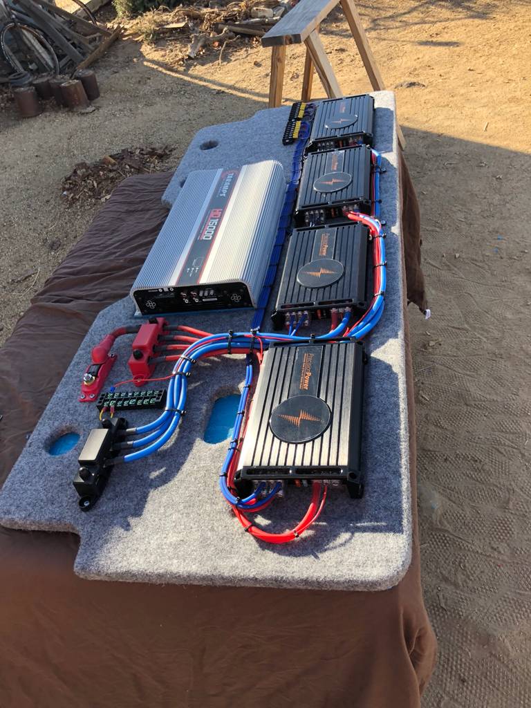

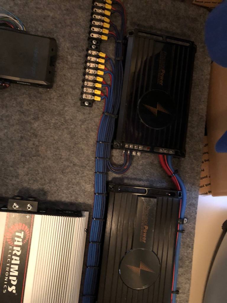

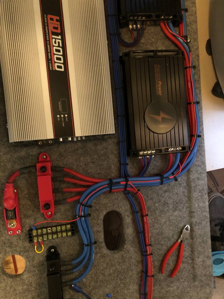

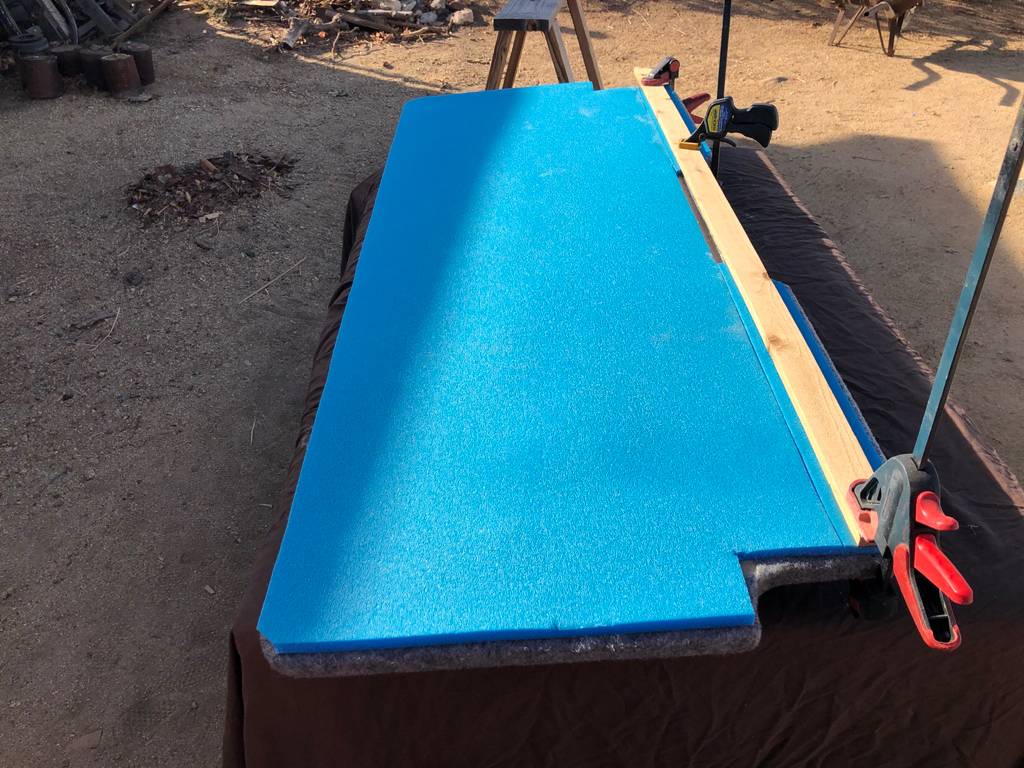

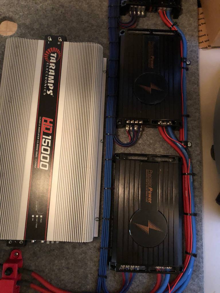

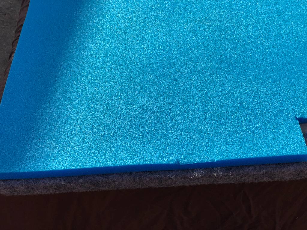

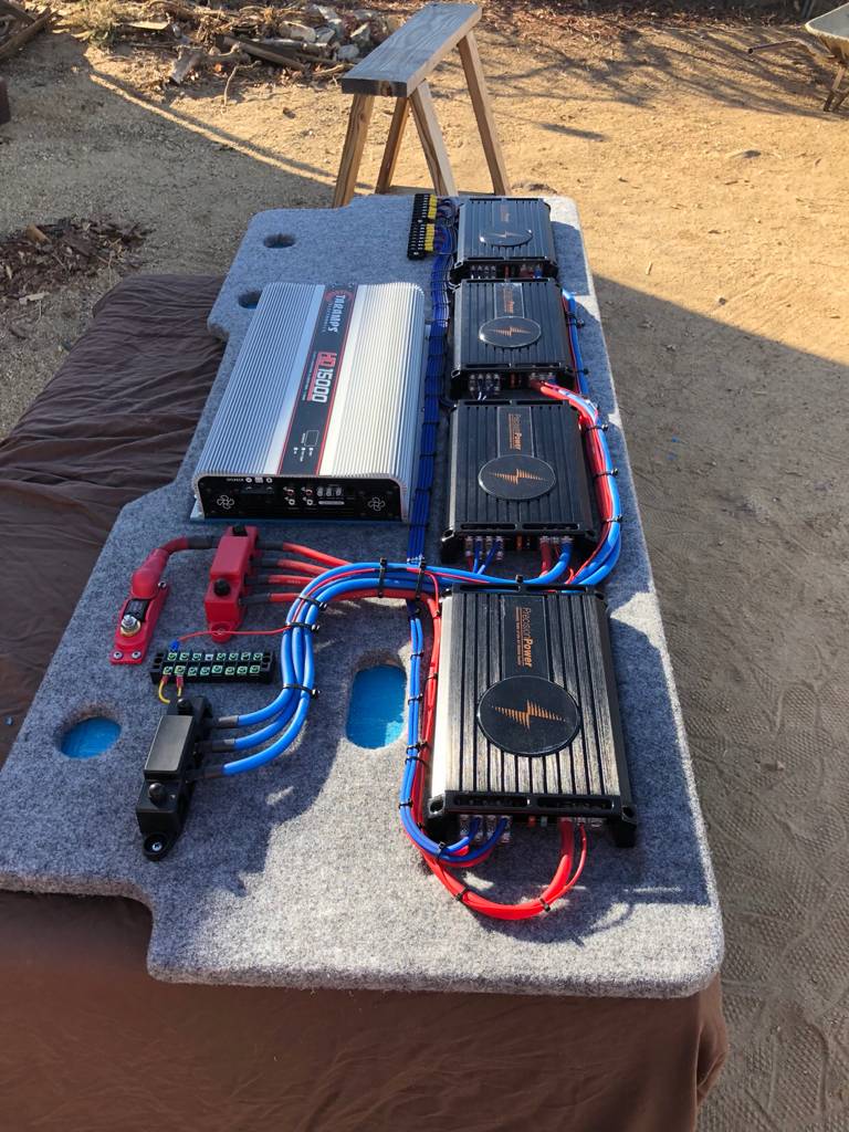

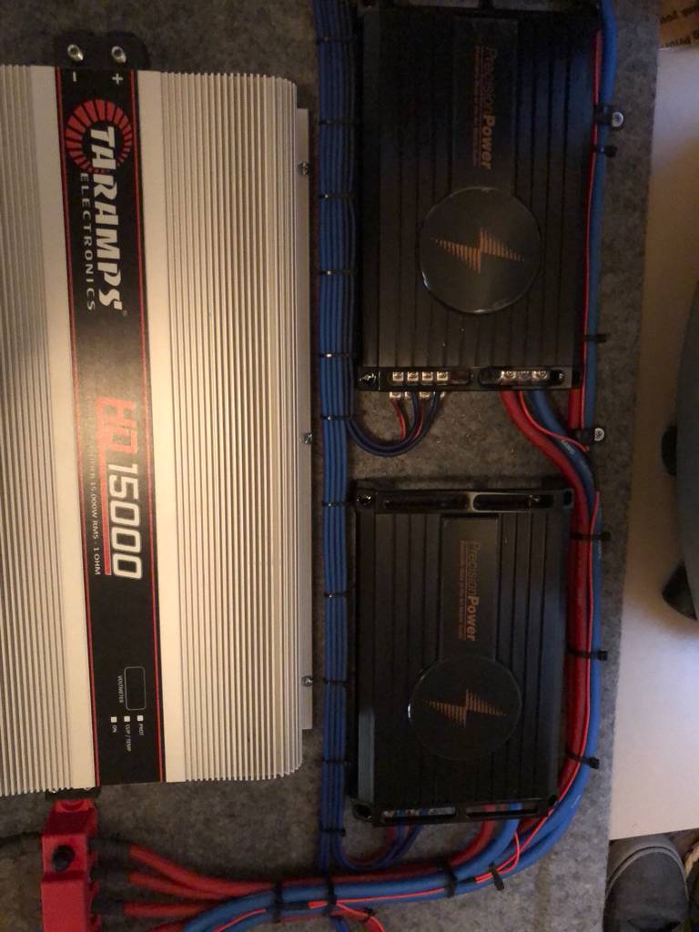

Well I got home late but did manage to get a little done. I got a dense cc foam pad and glued it to back of my amp rack to cut down on amp vibration and damage and also got the last ppi 900 mounted up and found out I underestimated the amount of Y cables I would need to bridge all these so I will have to order more or order one of those custom made boxes with one set of rcas in and three out.
Fawk that looks neat and clean. Tryna figure out what the cutouts are for. Thought it was a bad idea to zip-tie power/ground wire together?
So earlier today, I got a chance to meet someone whom I haven't talked to/seen in over 20+ years. He's got that toolbox in the bed of his truck with a lot of Kenitik batteries in it and a monster CT Sounds amp.
Thanks, the cutouts are for the 0 gauge power running under the platform the box sits on as well as rca cables and amp turn on remotes and voltage feeds for meters ect and oval hole is where my subs speaker wires hook up. As far as poss and neg wires not being zip tyed together??? Don’t know why not ? All mine are ziptyed together under the truck and into the tool box and never had any problems? I guess I thought that’s what insulation is for ? Now I may have problems with rcas in that mix too lol but we will see soon enough ?
Something about noise interference..? Heck I dunno if it's true or myth.
No that’s if you run rca s next to power sometimes it causes interference and yes I will probably have a problem with that lol but hard to fit all this in my truck !
Ya...RCA's def. I dunno. I just like to keep things separated to prevent uh oh's later on down the road. Just remembered....my drivers side outside door handle is coming loose. That's a pita to fix.
