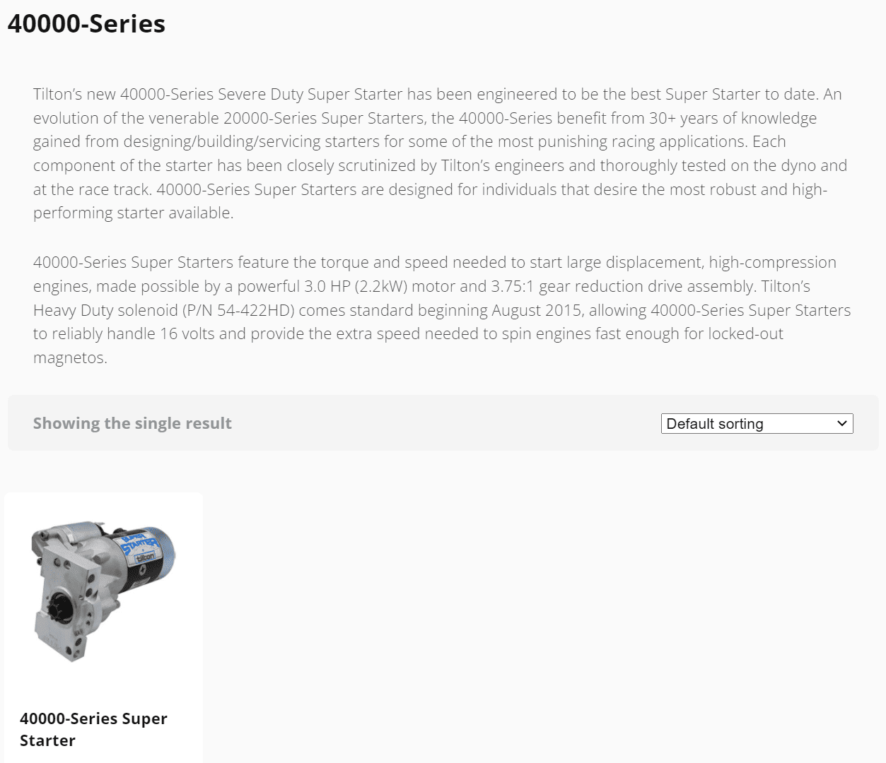

The 2200 watt power rating? From Tilton directly.
34402

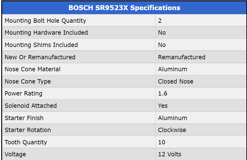

As an example, BMW M5 (18) use a 1.6kw starter (higher than the range i posted)
34403

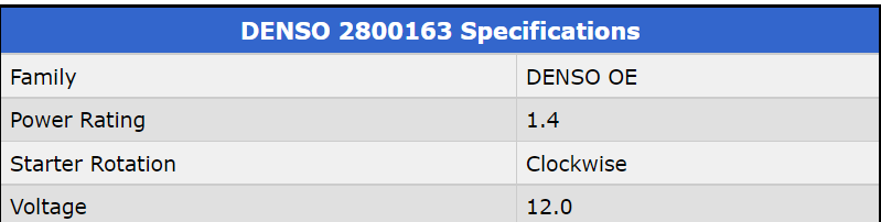

From an 93-98 2j Supra, 1.4kw.
34404
