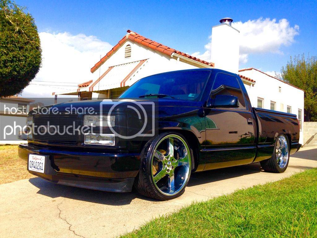

The truck: 1990 gmc C1500 RCSB
Lowered 5/8 on 22's with under-bed step notch.

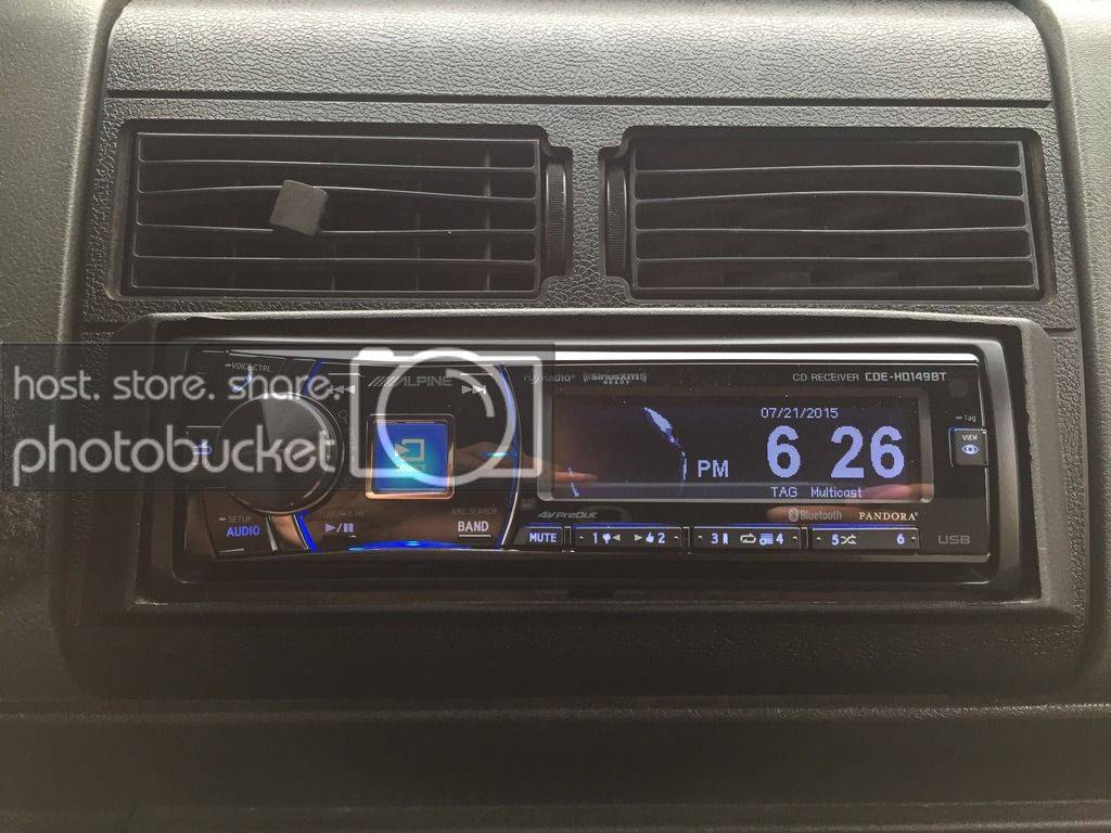

The source to control it all: Alpine CDE-HD149BT

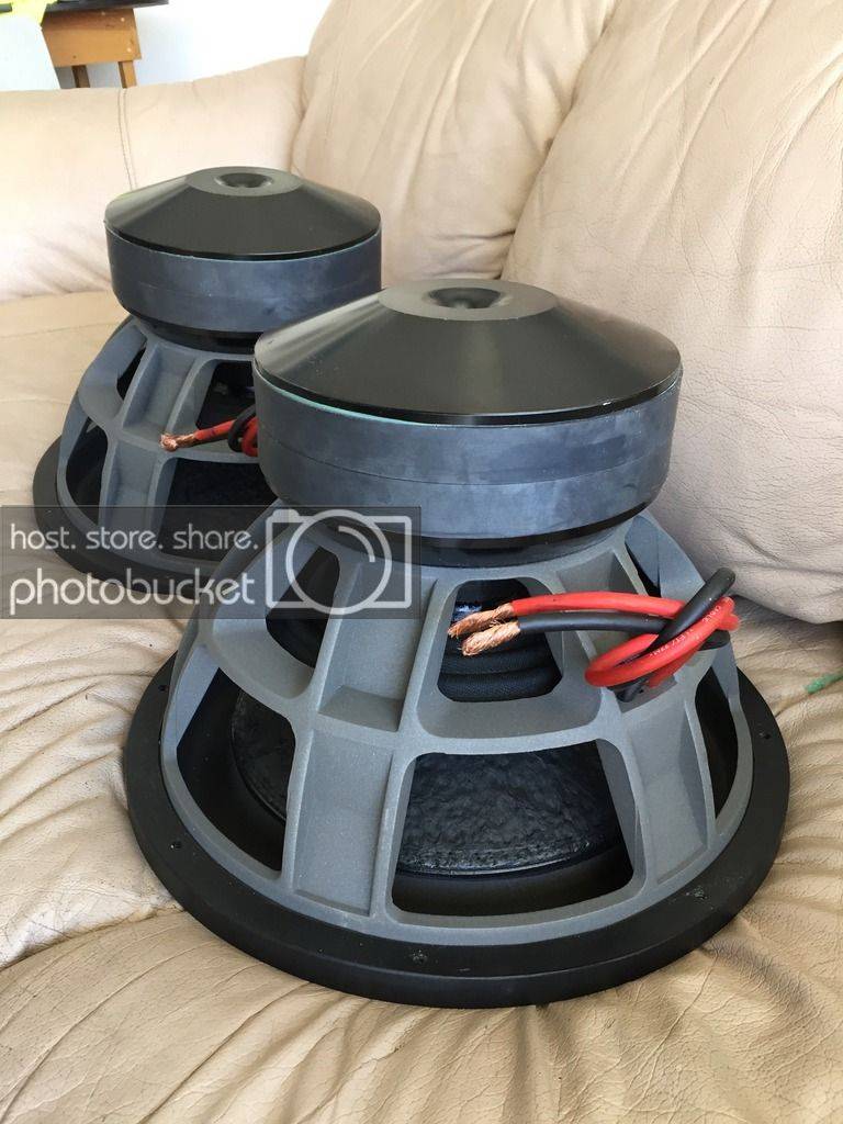

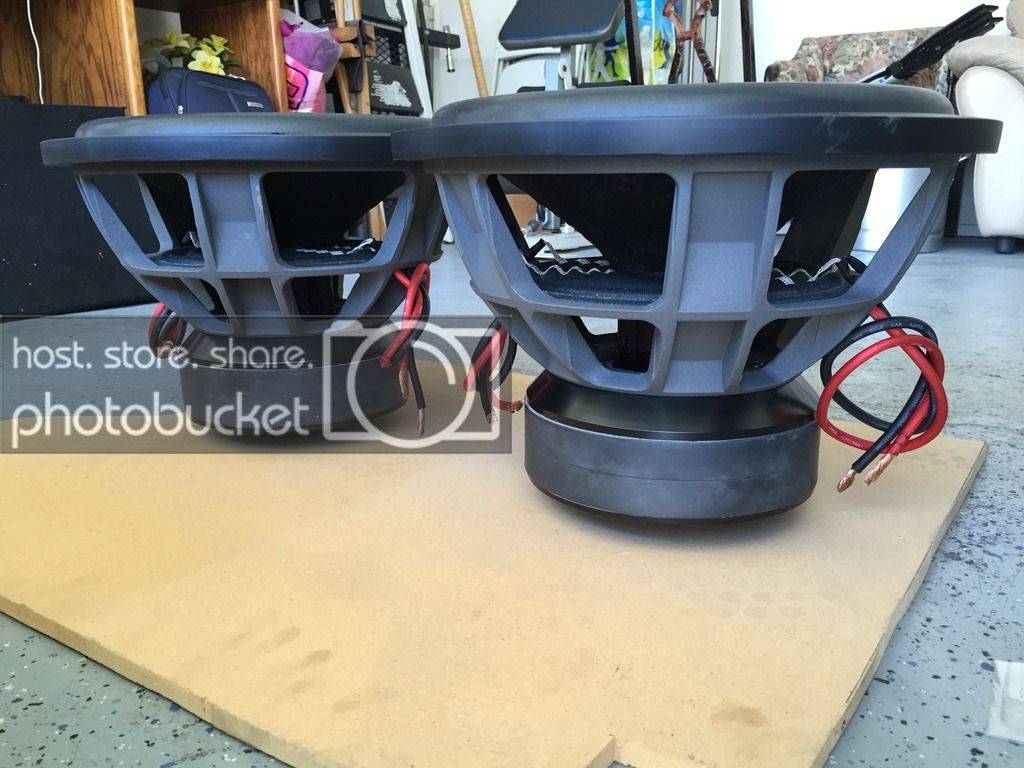

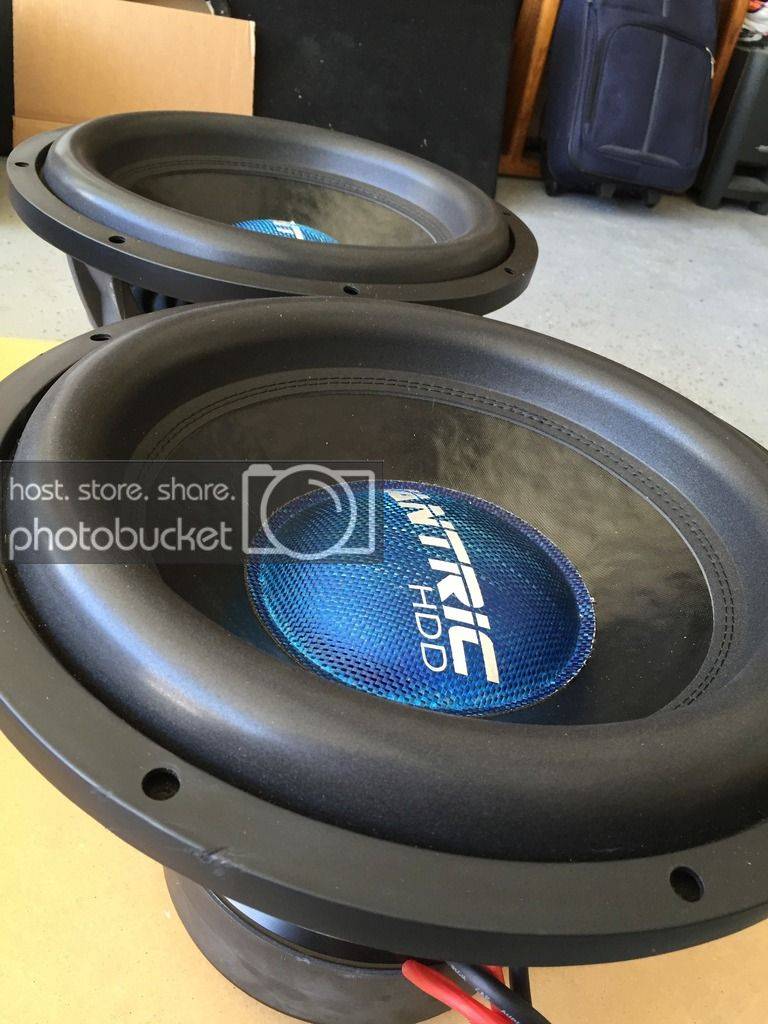

The Subs: TANTRIC SOUNDS HDD 15’s Carbon Fiber Caps D1

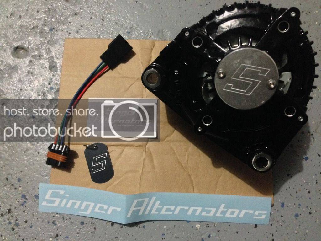

The Electrical: Singer 6phase 320A alt

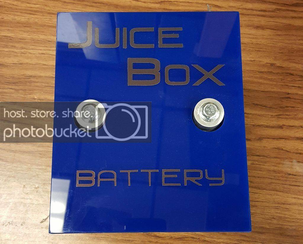

Trying out a Juicebox Lithium 20Ah…hope this isn't a bad choice, lets keep our fingers crossed guys!

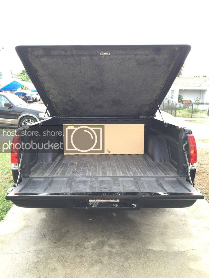

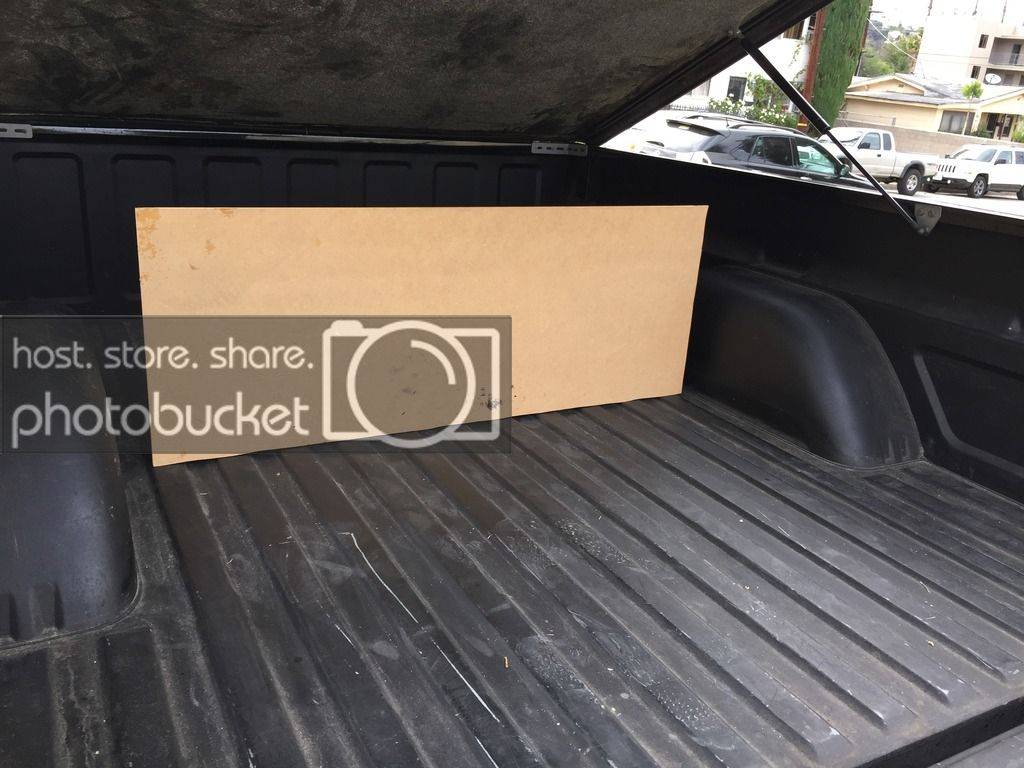

The enlcosure as stated will be a 4th order 2.25:1 ratio sorta, kinda around there with 3.9^3 sealed and 9.8^3 ported. Before subs and port. Subs will be inverted into the ported area with plexi in the bed to look at dem purtty things moving.
Box should be right up to here. Middle of wheel hump.
